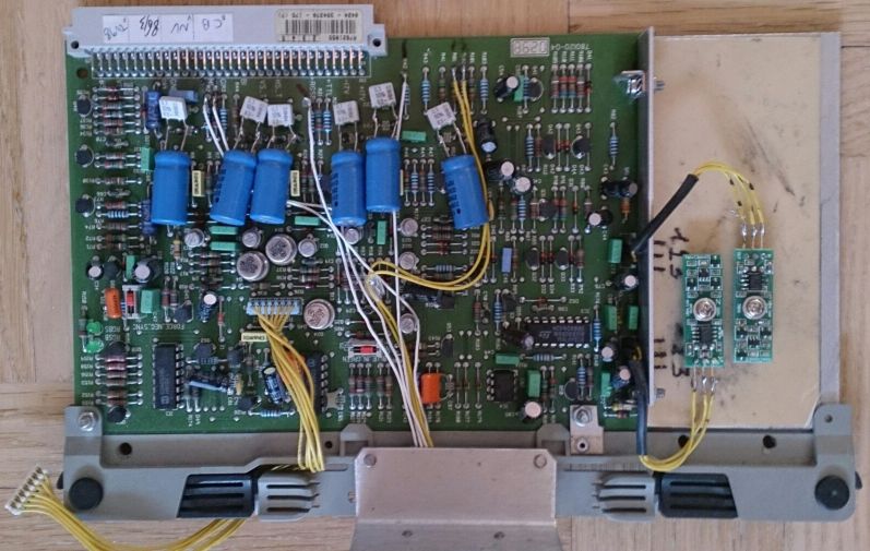

Posted: Thu Mar 19, 2015 9:38 am    Post subject:
From my old notes, my 1209 did have R7621055 in it. My spare has lots of mods on it and a VGA-port on the back side. Got in along with other parts from some old deal.
How imune are these projectors to faults? Spot burn should be handled by scan failure detection on other boards but what about a short circuit on some board with unknown status? I don't have a test projector/set. Same problem as a roling repair on a car, you can't take too much chances or you won't have any means to get to work on monday morning.
Port 3
 Filesize:  85.59 KB
 Viewed:  7031 Time(s)

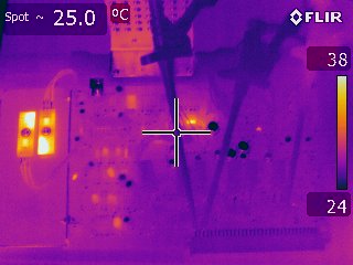

Posted: Fri Mar 20, 2015 11:42 am    Post subject:
Took it to work and tested in on my bench. Pulled 25 mA on each rail. -12V was -0.3 V and the regulator was quite hot! Good thing I tested it first Smile
EDIT:
Good thing I check which connection is ground first. Rolling Eyes
55 mA on the +17V rail and 25 mA on the -17V.
R65 is the only thing heating up slightly so should be good to test.
IR image.
 Filesize:  173.33 KB
 Viewed:  6988 Time(s)

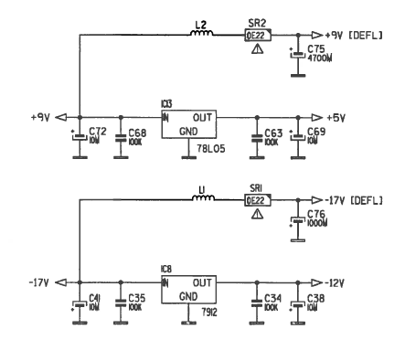

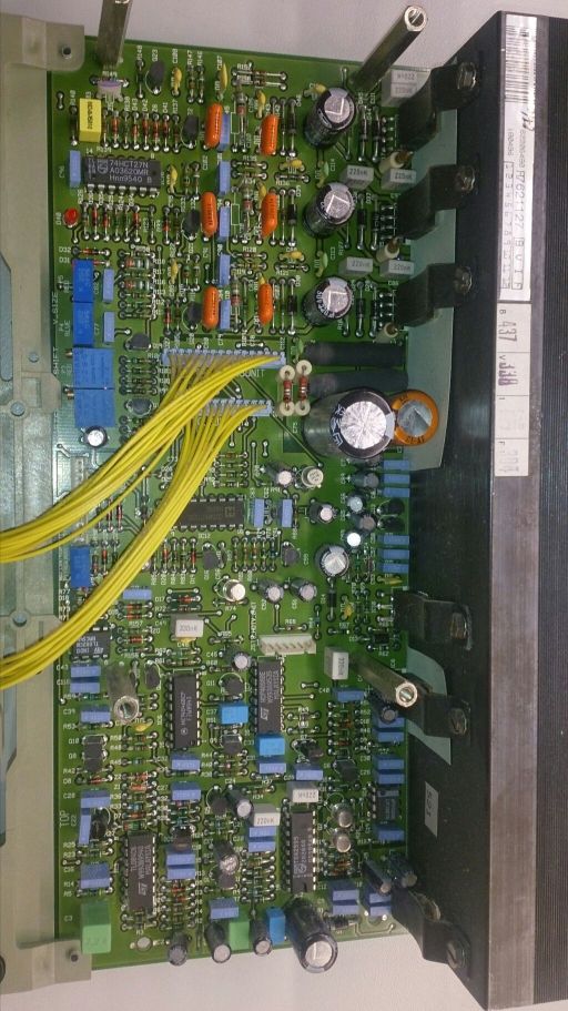

Posted: Wed Apr 08, 2015 11:46 am    Post subject:
Ok, it's officially dead now. A solid 30 minuts of heating up but it kept refusing to sync to any input.
Took R76211127 out. Nothing visible but C75 and C76 (the big ones in the middle, close to the heatsink) sits very close to heat sources. Does a high scan frequency load the +9V and -17V more? In that case, it could explain why I could see the internal patterns but not sync to external sources.
I'll unsolder them and see if I can find that LCR-tester somewhere.
Has anyone experimented with these? Increase the value/decrease ESR, does it come with any side effects?

Posted: Wed Apr 08, 2015 12:32 pm    Post subject:
-17V rail, 1000 uF:
917 uF, 105 mohm @ 120 Hz
+9V rail, 4700 uF:
4248 uF, 46.9 mohm @ 120 Hz
Should be fine.
Any other candidates?

Posted: Wed Apr 08, 2015 11:59 pm    Post subject:
That 4700uF is more than 10% out.
Posted: Thu Apr 09, 2015 12:00 am    Post subject:
