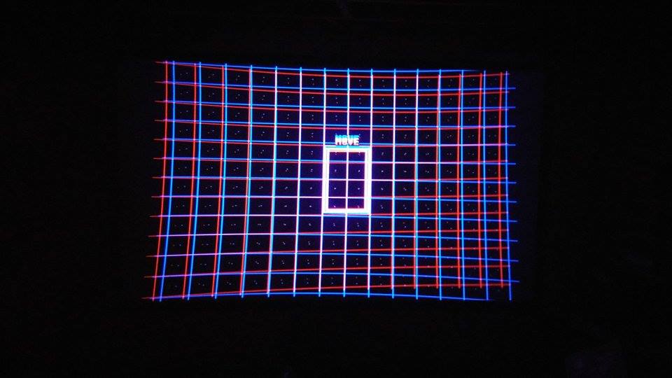

So I put the same inductors on the 24v lines of the cva just after the ribbon connector.
I feel something is wrong here......
Image after a total reset. No adjustment except to center,
Wtf?
 Filesize:  50.47 KB
 Viewed:  7167 Time(s)
Posted: Tue Apr 07, 2015 2:53 am    Post subject:
I also have them on my CVA. Don't remember a radical grid change as such, but would expect some difference in the grid after installing the coils there
CSX
Joined: 11 Feb 2015
Posts: 142
Location: Ohio
Posted: Tue Apr 07, 2015 2:57 am    Post subject:
If I adjust this with convergence grid, is this a no no? Should I find different inductors? Or go for it?
