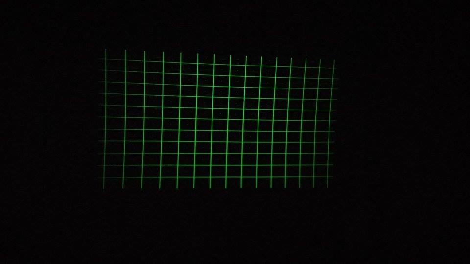

Posted: Wed Apr 08, 2015 12:54 am    Post subject:

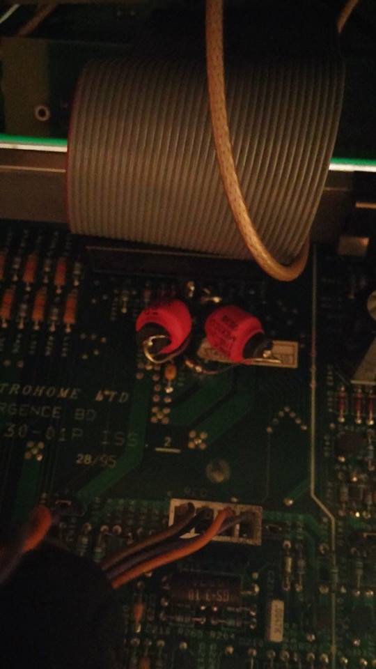

Took a quick pic of the work.
I don't think I can converge this....
I think I need to undo this.
 Filesize:  43.02 KB
 Viewed:  9150 Time(s)
Posted: Wed Apr 08, 2015 12:58 am    Post subject:
Yeah, something looks wrong there.

Posted: Wed Apr 08, 2015 1:08 am    Post subject:
These go across the 24v traces exactly as shown in the pic.
Open to feedback or other.
Mike, Sent you an email as well.
Posted: Wed Apr 08, 2015 1:31 am    Post subject:
CSX wrote:
make your leads short as possible:

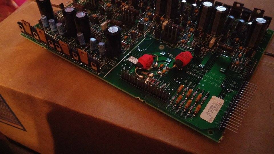

Posted: Wed Apr 08, 2015 2:18 am    Post subject:
Repaired the right most trace and moved the coil.
Swapped in new coils from the pack as well.
Redid the installation.
 Filesize:  77.71 KB
 Viewed:  9132 Time(s)

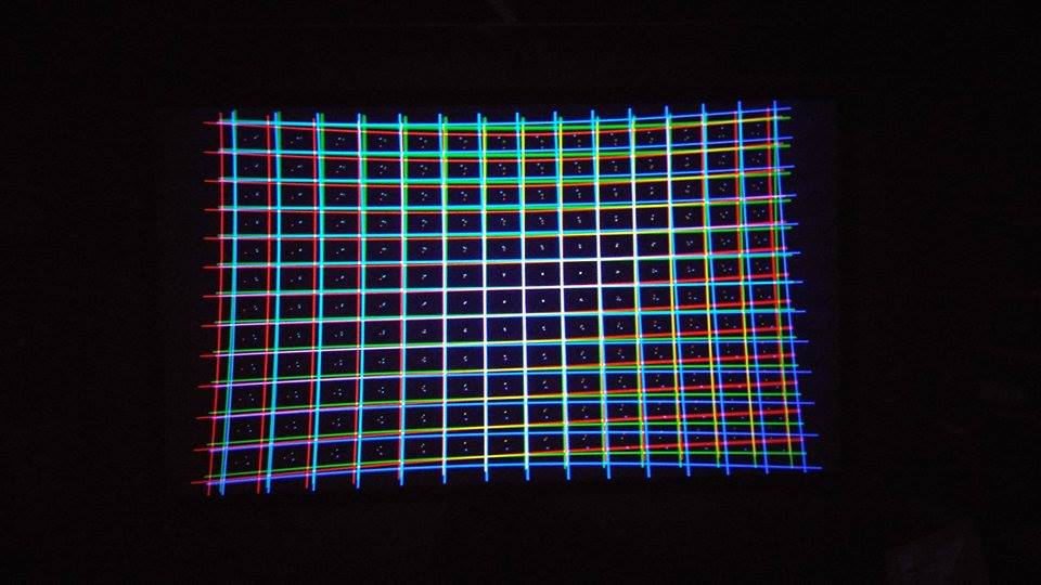

Posted: Wed Apr 08, 2015 2:46 am    Post subject:
A different result has been achieved.
I think I can converge this
 Filesize:  61.36 KB
 Viewed:  9126 Time(s)

Posted: Wed Apr 08, 2015 3:37 am    Post subject:
Well, after a bit of work, I now have a relatively good starting point.
I still have to really fine tune everything,bit this is gonna be a good start.
I noticed that with this mod on the Cva, the convergence grid is way easier to manipulate, as well.
 Filesize:  26.67 KB
 Viewed:  9117 Time(s)

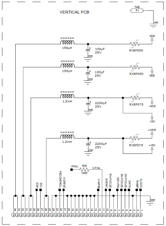

Posted: Wed Apr 08, 2015 8:38 pm    Post subject:
I might also have to give the CVA a shot. Still have like 20 of the inductors for the focus board.
After that I am going to try to locate some more inductors to do a mod to the VDM that Barclay had suggested.
Barclay's VDM mod
 Filesize:  83.78 KB
 Viewed:  9076 Time(s)
