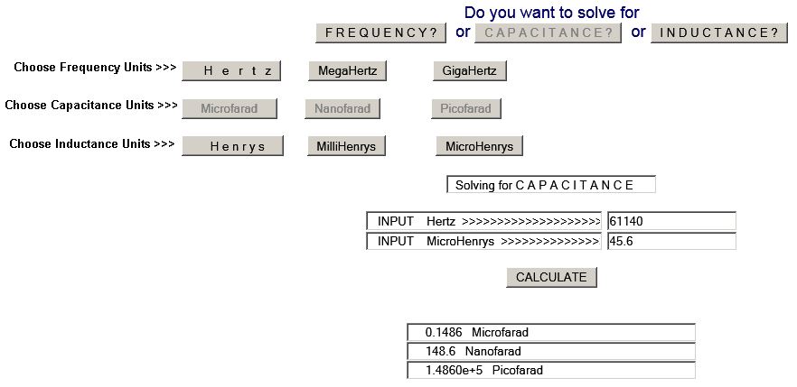

Posted: Wed Mar 25, 2015 3:03 pm    Post subject:
So my frequency was 61.14,
uH is 45.6,
and cap value came to 148.60 nf according to the calculator.
So I would need for that red coil a 148.60-33 =115.6 nf cap instead of the 68nf cap?
Posted: Wed Mar 25, 2015 3:13 pm    Post subject:
Wait somethings not right I think.
If i use the micro henry button( i just used the henry button before) and hertz button aI get 1.4860e+8 Nanofarad
that is 148600000 nf ?
That is not right....... right?

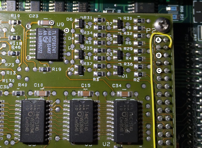

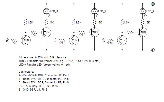

This is the display circuit mentioned earlier. Please feel free to ask questions if there's anything unclear...
I don't like it but it has to be added: I assume no responsability if something goes wrong with Your machine by building and connecting this circuit. It has worked for me and can't possibly do any harm if built and installed correctly. Always make sure that none of the board's parts makes contact with metal parts of the chassis and take care for Your own safety too!
