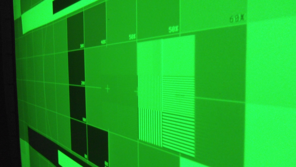

Another shot.

You have at least an XG 750 which is closer to the PG xtra in bandwidth... Smile
Posted: Sun May 31, 2015 11:36 am    Post subject:
Wow... There is something wrong with the focus there, i cant see any 1:1 at all!!! That could be the HDF2, but id say its more than just that.

Posted: Sun May 31, 2015 8:16 pm    Post subject:
Yep its not good.
Put in a blu-ray and the picture was very sharp.
I thought it may of been because I put the test pattern on a dvd-r.
I put the same disk in and checked the Barco and it is very clean and sharp.
It could be the fury. Its the only change in the video chane the 2 projectors.

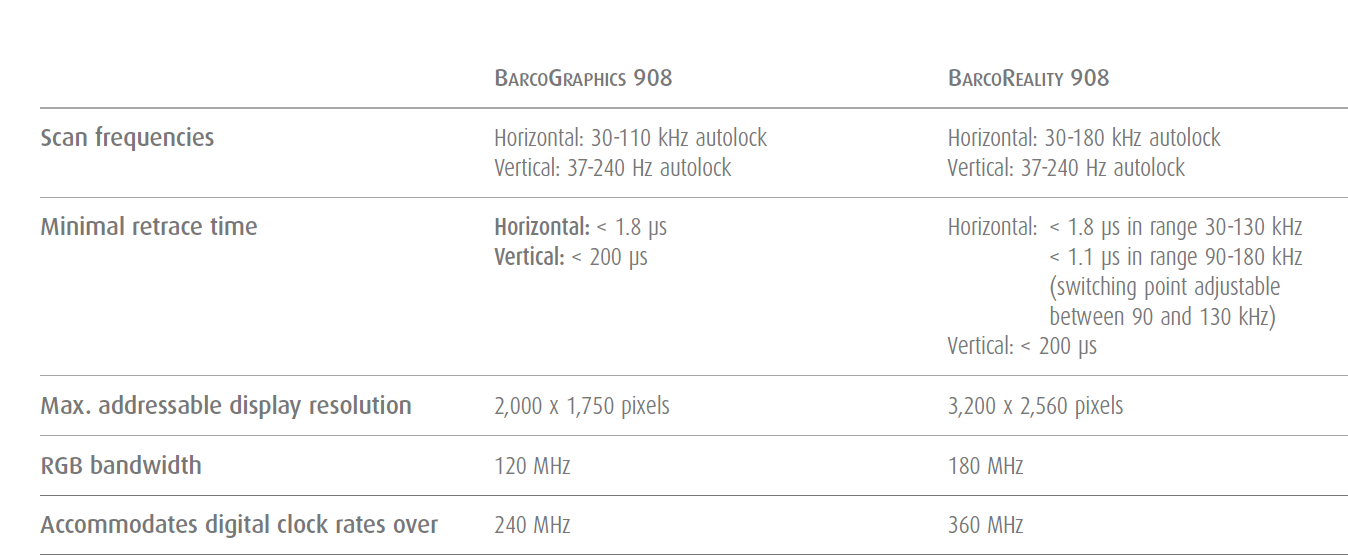

Not bad resolution for an 8inch projector
 Filesize:  70.24 KB
 Viewed:  6965 Time(s)
Posted: Thu Jun 04, 2015 7:35 am    Post subject:
You dont really believe those numbers are accurate or even remotely addressable do you?
Posted: Thu Jun 04, 2015 7:37 am    Post subject:
Ive displayed 2560x1600 on my Cine 9 before, and it wasnt real sharp at all. It is beyond the ability of the set.
gregstv
Joined: 27 Aug 2007
Posts: 628
Posted: Thu Jun 04, 2015 8:12 am    Post subject:
Case, I cant believe you would question the manufactures sales pitch. Laughing
Posted: Thu Jun 04, 2015 8:13 am    Post subject:
Greg, if it was an NEC i wouldnt have to mate Wink
Posted: Thu Jun 04, 2015 8:15 am    Post subject:
The Reality 912 also lists those same specs, and there is a good chance it could sharply address 2560x1600, but 3200x2560 is a bit of a stretch.
