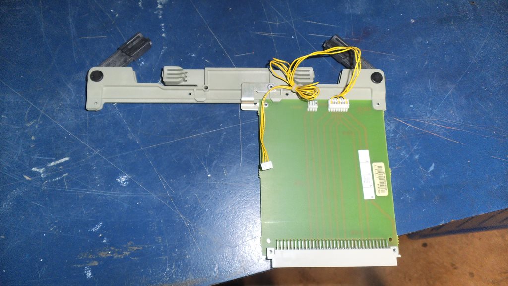

The SEOS has a link board in the port 3 slot. To add a Moome card, can I just remove this board? Do I need to remove the other small board that it is hooked up to? (R762485)

Hello Greg,
It is recomanded to remove those boards even if you don't need the port 3 slot. They draw power for nothing and degrade the picture quality to some point, for use in single projector configuration.
That small board is part of IBCL-link, so should be removed too. The only thing you have to do is to bridge back the W1 and W2 jumpers on the RGB driver board R762720 ( just under that miniboard ). In order to enable IBCL-link, those wires are cut. So just solder two pieces of wire back and you are good to go.
Good luck and let us know how the PQ is with the Moome card.

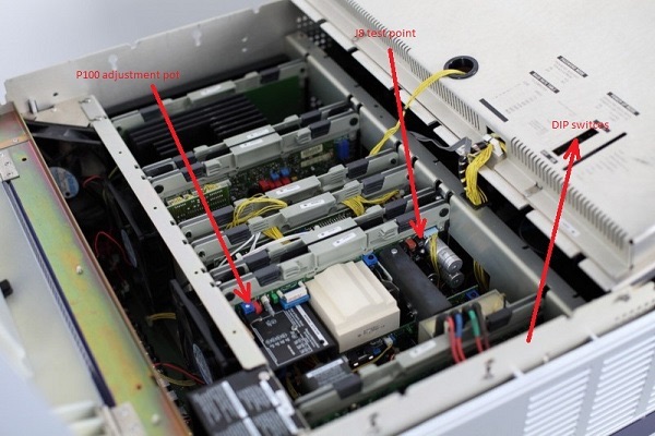

Posted: Thu May 21, 2015 8:02 pm    Post subject:
It is worth checking your 17V rail. Other Barco owners, with the same problem you described, got rid of those lines by adjusting P100 pot on SMPS.
Feed the Barco with a internal test pattern at standard frequency (15,6KHz). Put brightness and contrast at 49. With a voltmeter connected at J8 testpoint, adjust P100 pot for a exact reading of 17,2 V.
