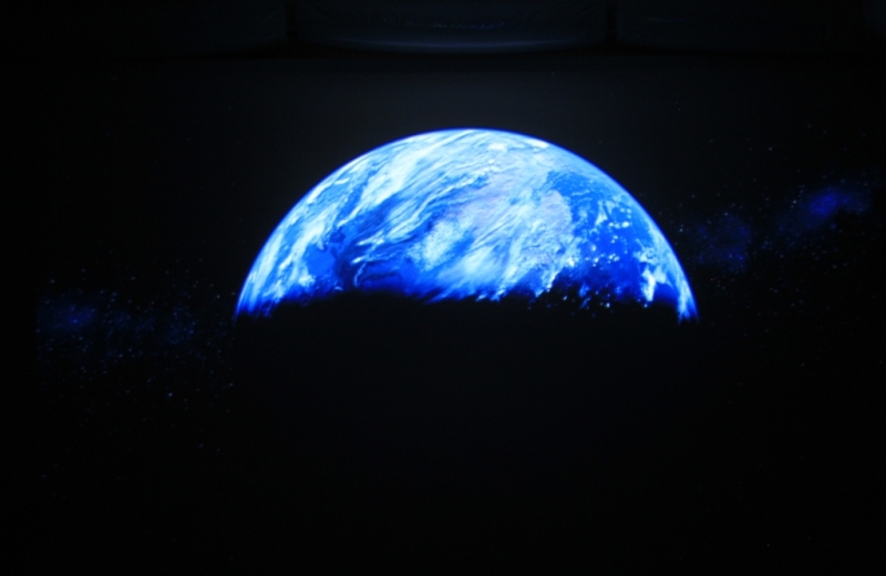

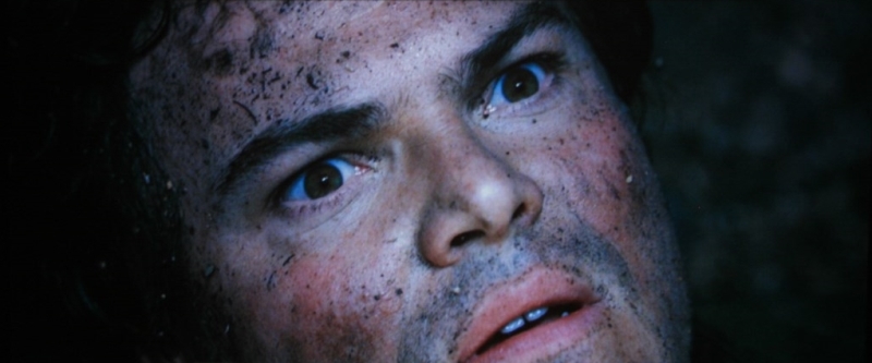

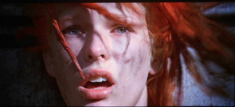

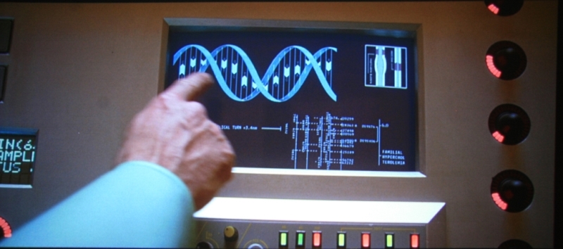

Posted: Thu Apr 16, 2015 12:26 pm    Post subject:

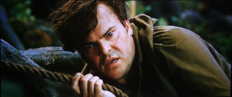

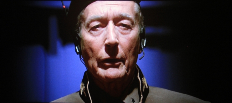

Fitted HD144 lens.
If I can find a good P16 tube for the second projector I will get another set of HD144's and play with stacking them

Posted: Thu Apr 16, 2015 10:11 pm    Post subject:
Those images look good from your 808s. Seems you have done a great job.

They came with 4 pole. I picked up an 808 off ebay with 4 pole. I will use the magnets off the 808 to make a six pole and fit it to the green tube to start with.
Case, the lens make a big difference to the colour. Sharpness is very close maybe a tad better in the corners. When I find a green tube for the second SEOS I will get another set of lens from Curt.

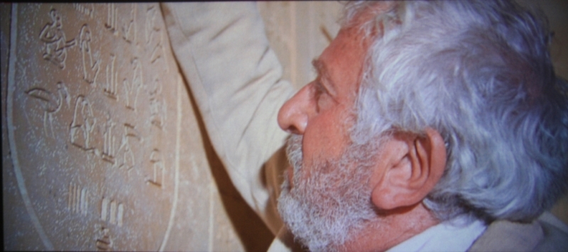

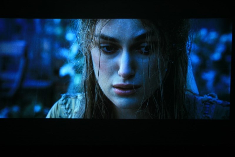

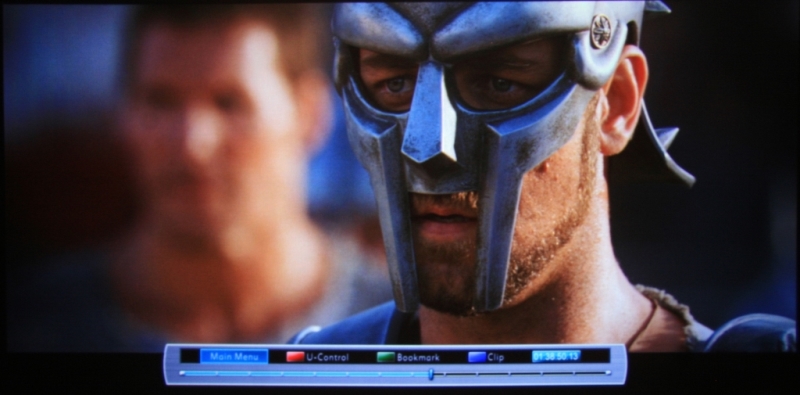

Posted: Sat Apr 18, 2015 9:51 am    Post subject:
Played with the green focus today.
