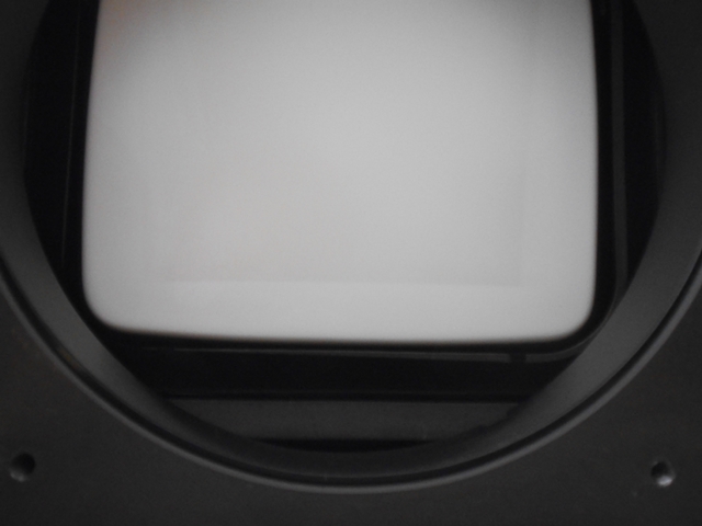

Thanks Curt that fixed it. Picture is nice and bright on all tubes.

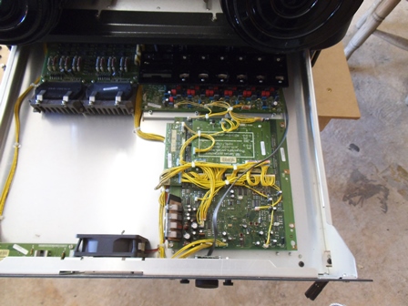

I think it has the Green convergence board. pictures attached.
Greg.

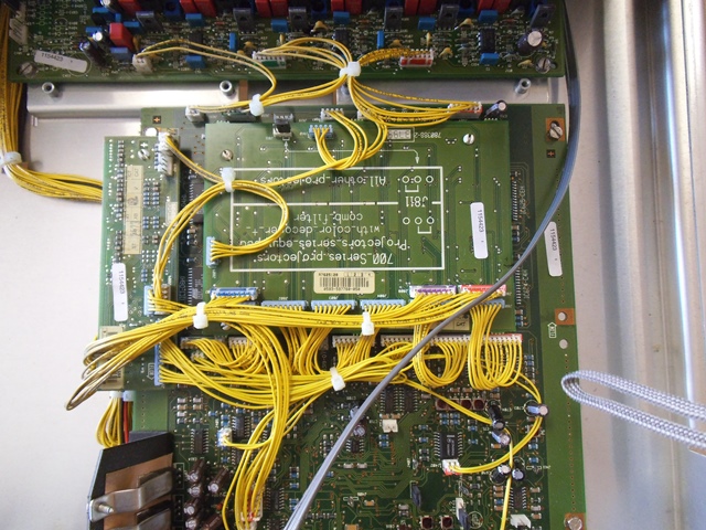

Forgot one. Is the jumper in the right place?

Yes, the jumper is in the right position. When not, you won't see "green only" in the convergence menu.
Unless you are blending, COG is useless. Like Curt said, you can use the newer one and you keep the older for spareparts.
Congrats with the purchase, by the way.

The board in front of the COG board I would think is the convergence output board. All the pictures I have found of the convergence tray has a board with 2x STK on it. This one does not. Is this a standard Barco board or a SEOS board?

Nice spotting and NO its not standard.
That convergence output board looks like a R762519 and they did not have the 2x STK on them. If thats right then that board could be completely standard.

Just re looking at that convergence output board and it could be a R762519 which did not have the two STK chips. If thats right then it should be OK for flat screen although I can't tell you if SEOS have modified it.

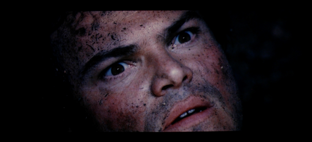

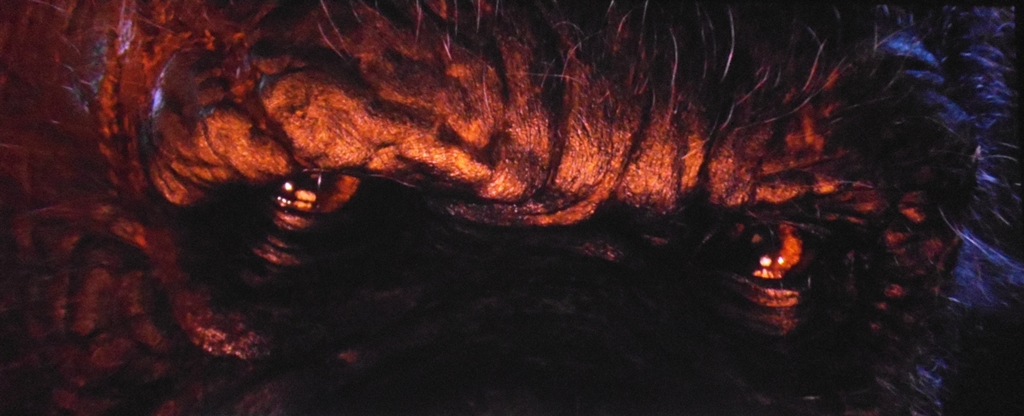

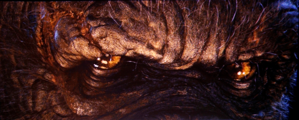

Posted: Mon Mar 09, 2015 10:27 am    Post subject:
A few screen shots from the SEOS 808s

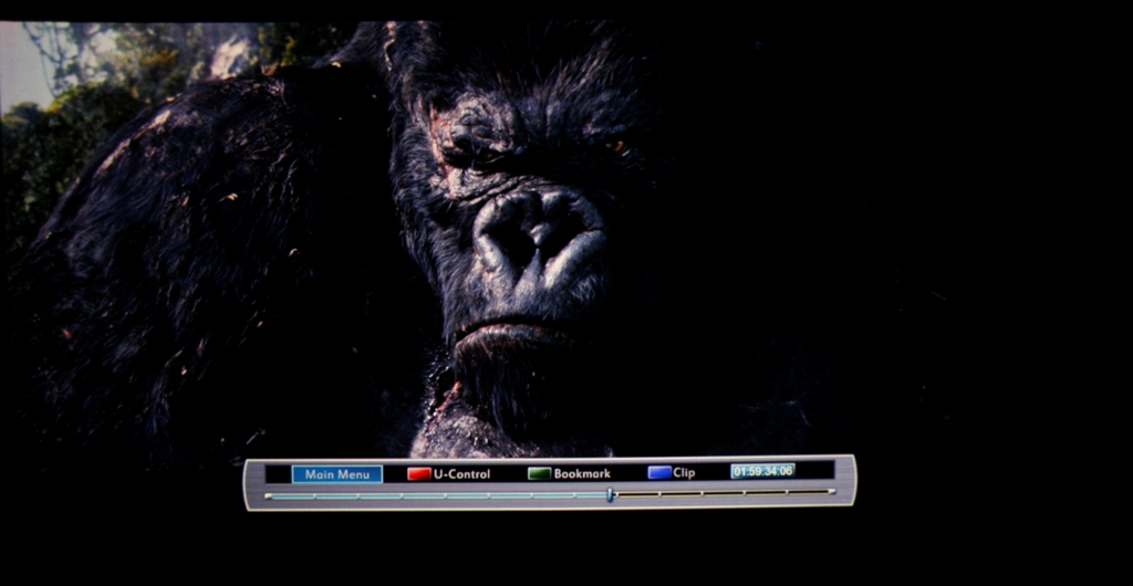

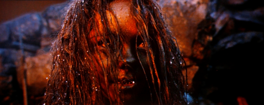

Posted: Tue Mar 10, 2015 6:20 am    Post subject:
I don't have many at this stage. I am still learning how to do screen shots. The camera seems to change how long the shutter is open depending on light from the screen. 2 similar shots attached. I will do more when I can get consistency with the camera. I am using a Canon EOS30D. It has so many settings to figure out. The Barco is brighter but not as sharp.
I am going to fit a set of HD144 lens to the Barco as well.
