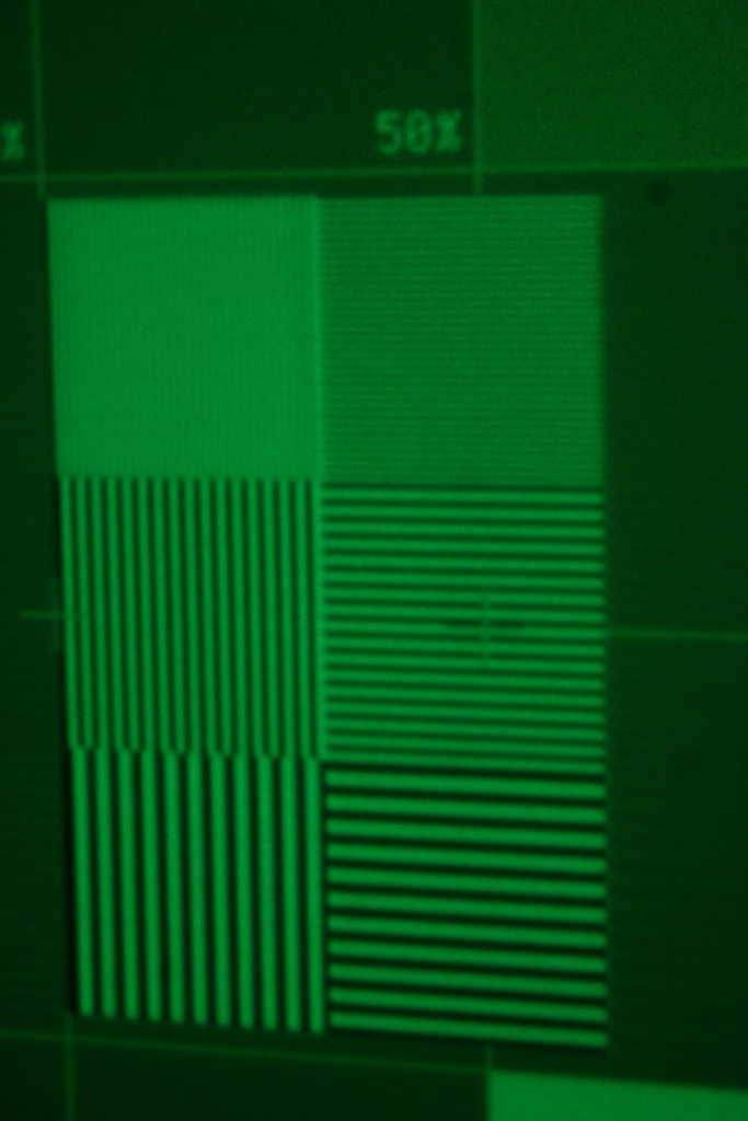

Posted: Sat May 30, 2015 8:24 am    Post subject:
I took a shot of this a little while back. This is the XG at 1080p@48
