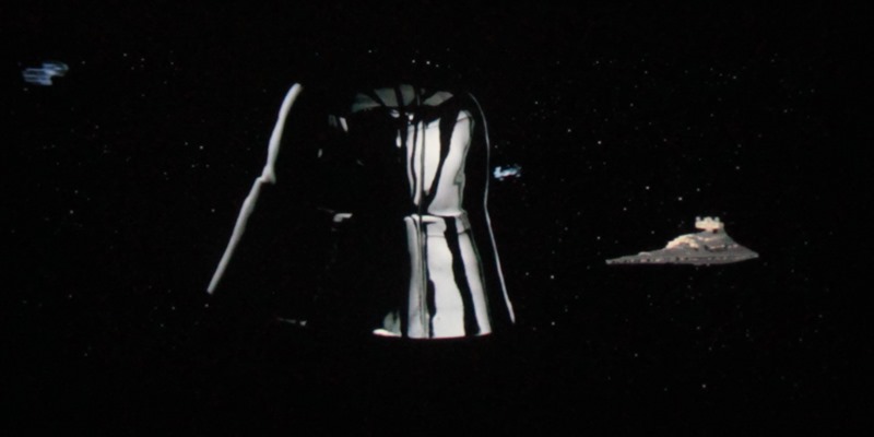

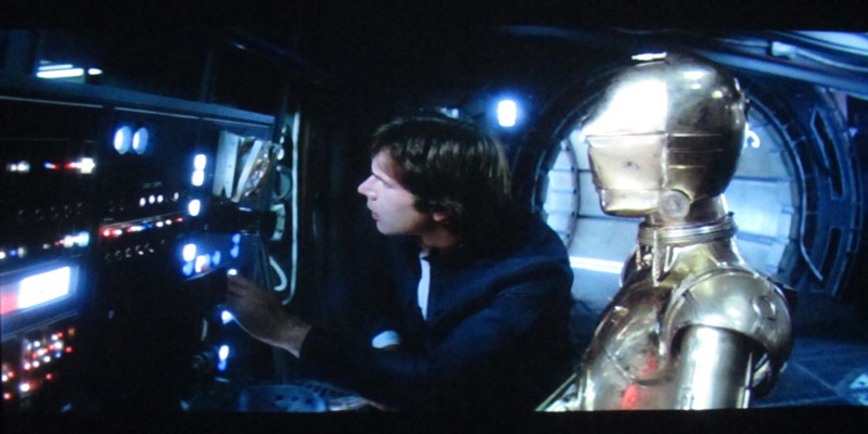

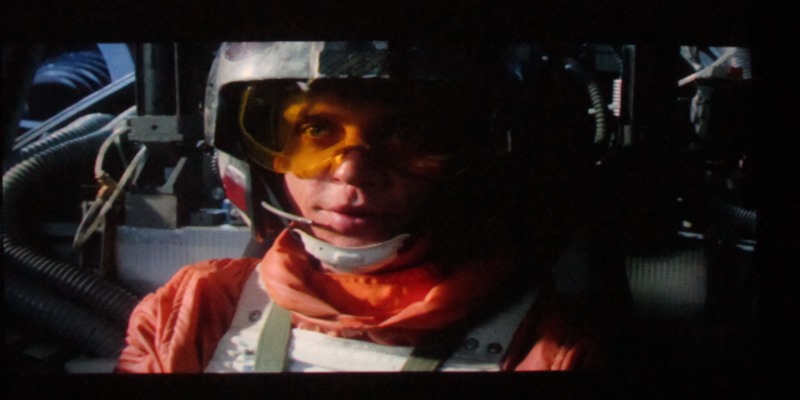

Ok, so last night I got around to setting up the BRP-83 after it came back from Oppo over a week ago. To the OPs request, here are a few shots from my "low budget" CRT setup. The camera is nothing special and makes the images look worse than they do to the eye. Anyway, I'd guess a newbie could:
1) Get someone to PAY him/her to take away their ECP
2) Get a HDF2 or 3 for ~$50
3) Use any simple BR player...
End result: Decent 1080i 80" image from a free projector as viewed from about 13ft in a dark room.
My particular video path is:
Oppo BRP-83 outputing 1080i over HDMI
Outlaw Audio 970 Processor to switch sources (the HDMI is DVI in/out)
HDF3 + GammaX
DVDO iScanHD (analog passthrough mode)
50 foot RGBHV cable
ECP 4500+
Screen is a plain-jane SharpVision, 80"W screen.
I touched the conversion, only bumping the entire red grid up and over two taps of the remote and the entire blue grid four taps up...total of 30sec tweak from the couch. I set the timing and let the camera chose the aperture...I forgot to set the white balance on the last and didn't monkey with it otherwise. The camera was about 9ft from the screen and I cutoff the left edge in the image.
C3PO looks washed out to me in the photo and the lights seemed to blare, but this is the gammax washing out lights a bit in order for me to avoid crushing everything in the black AND the camera isn't weighting the exposure correctly or something else, per
 Filesize:  81.13 KB
 Viewed:  1904 Time(s)
Darth looking for son. At the bottom of his helmet can see red is off a touch.

Luke heading to degoba
 Filesize:  64.42 KB
