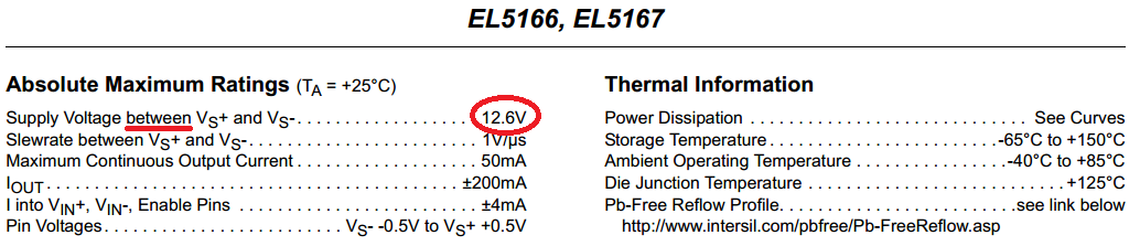

I have not been able to find current feedback op-amps with 300+ Mhz BW AND +/- 12 V ps..? (substitute for el2160)
el5166
Posted: Tue Jan 20, 2015 4:55 pm    Post subject:

Posted: Tue Jan 20, 2015 5:12 pm    Post subject:
dvh99 wrote:
koldby wrote:
One more thing.
el5166
Yeppers!!!
Nope...
