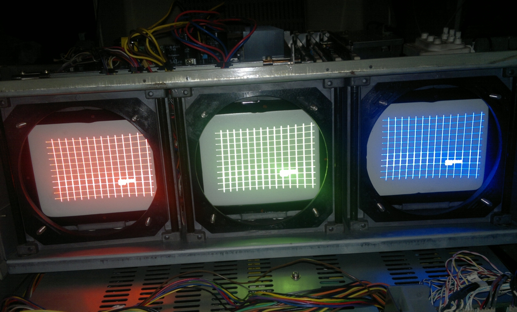

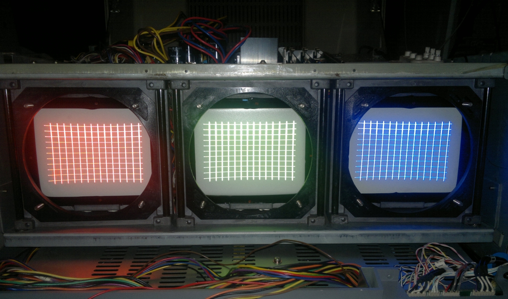

Raster position was quite a ways off on all tubes of the new PJ. I took some pics of before and after... the test patterns were pretty much on the very edge of the phosphor area... luckily tube faces are still pristine Smile
EDIT:
Okay so I swapped the HV board as well, same result...
So next up it's going to be a powersupply swap... if the error still doesn't migrate, I'm out of ideas... maybe the gain ctl... but I don't think that'll be the source of this issue...

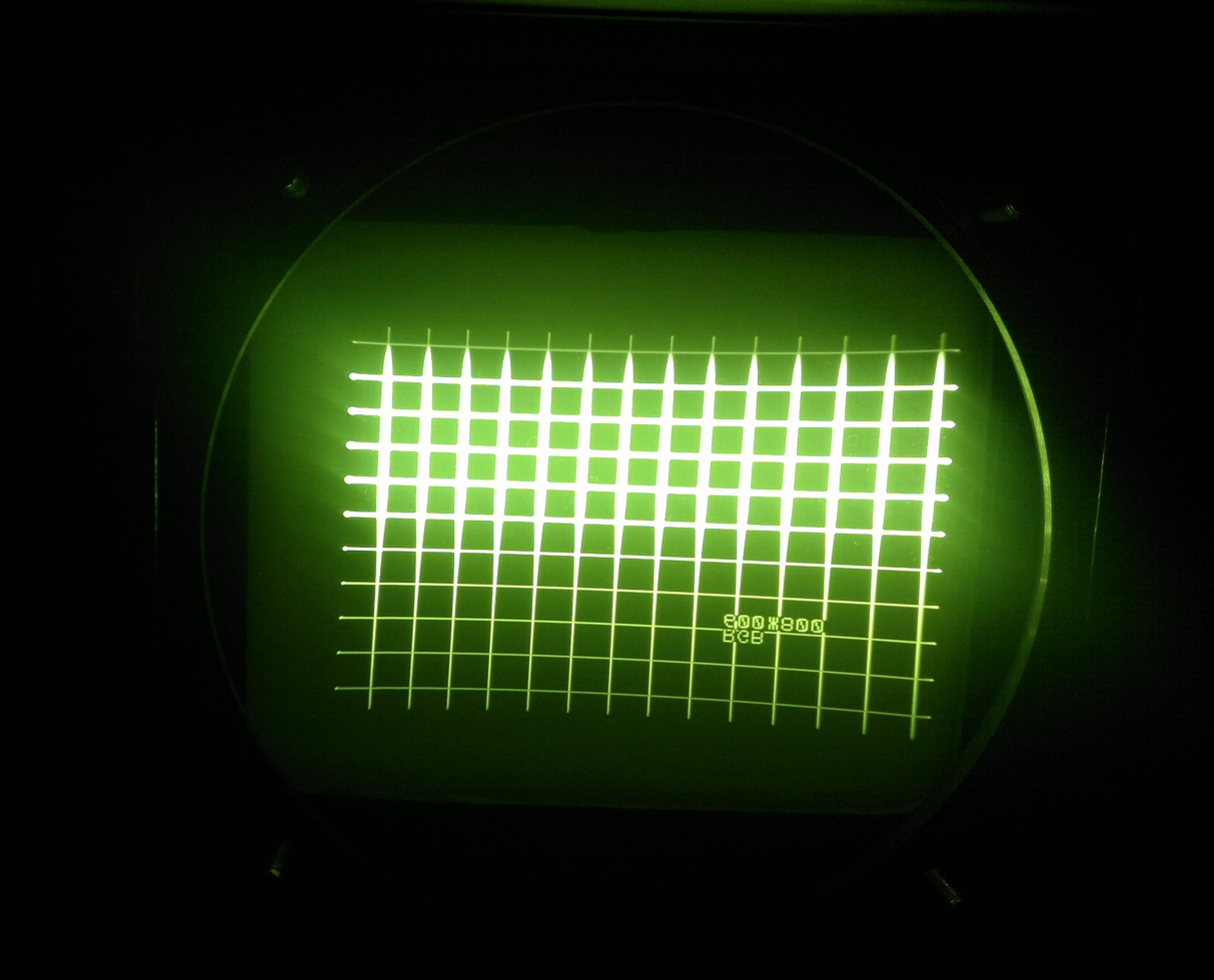

Here's some pics of the tube faces from the second PJ. 12xx hours on it, tubes are still pristine!
I also checked the manual, regarding chassis wiring and orientation... well... I know that the previous owner (not Gabor) had to replace the glass in front of the blue tube as it had cracked. Fun little project that must've been... but at one point someone obviously removed all three tubes as well... as the blue tube is in the correct orientation, with the HV plug facing down, but the deflection yoke's lugs are facing up, which is incorrect (they should be towards the HV cap according to the manual). The other two tubes are simply mounted upside down. HV cap on the top, lugs towards the HV cap as they should be. I don't think this would be the source of any issues as I'm not getting any arcing, and the deflection and focus/convergence yokes are facing the same direction, so as far as image reproduction goes this should not be a problem... still... if I'm doing it, I might as well do it right... so... next time I get at it, I'm going to turn the tubes around and make sure the lugs are facing down on the yokes...
And this is after a bit of playing with the positioning magnets. After this I set the toe-in, and used the rings again to realign the crosshair, this time only adjusting red and blue. Didn't need much adjusting actually.
 Filesize:  488 KB
 Viewed:  4731 Time(s)
Red was worse then green... right on the edge of the phosphor...
