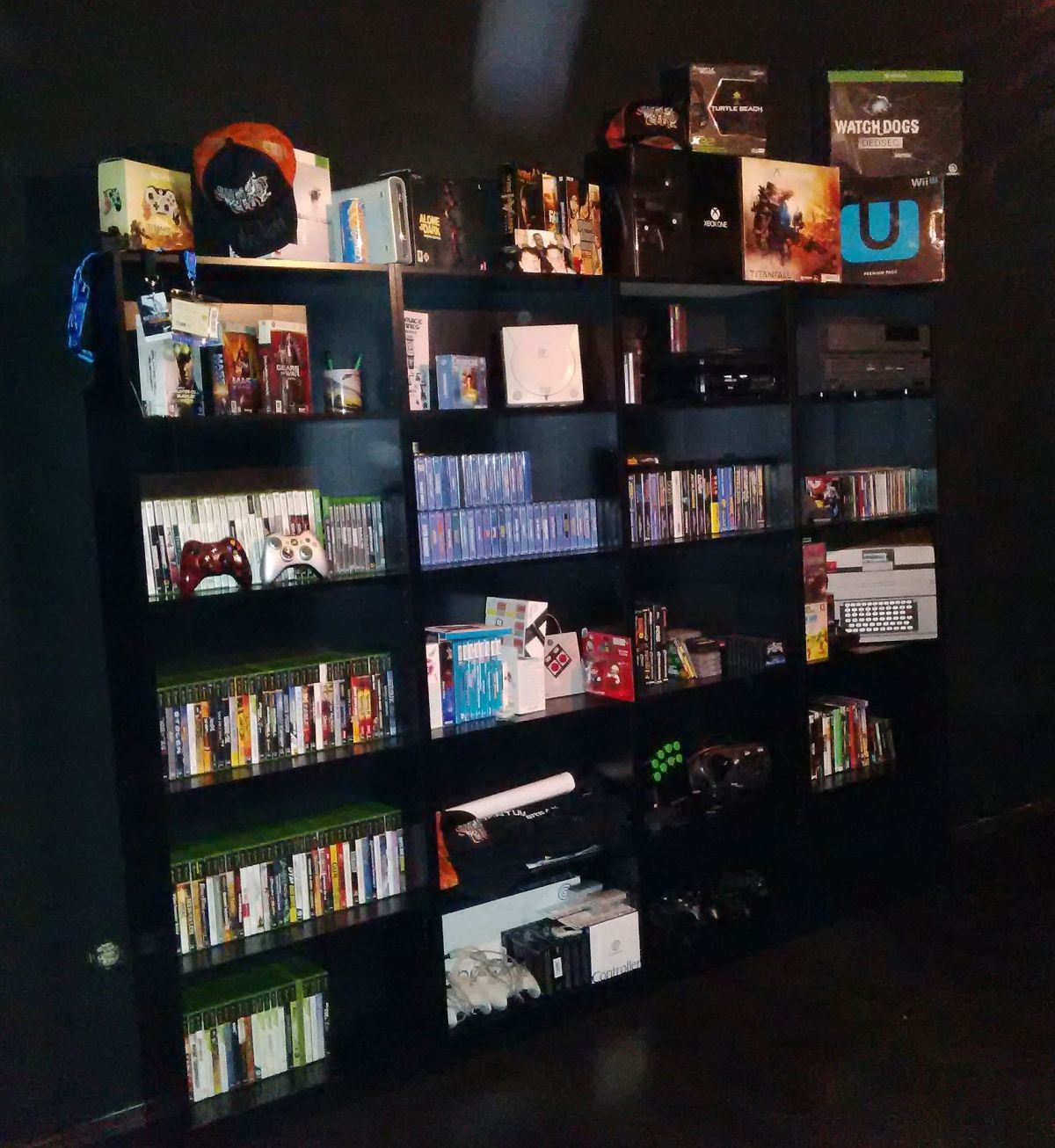

Posted: Sun Jan 11, 2015 9:54 pm    Post subject:
@Case
Couldn't resist, first pic of my Gameroom.
Btw. In around for weeks there will be an 1208s Barco
sitting in the Room for my Gaming pleasures Smile
Sorry for the bad Image Quality, will make nicer ones soon as i make more progress in the Room.
 Filesize:  201.37 KB
 Viewed:  6275 Time(s)
Posted: Sun Jan 11, 2015 11:38 pm    Post subject:
Yours is alot more tidy than mine, ive long since run right out of space!!

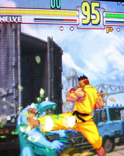

Posted: Mon Jan 12, 2015 4:36 pm    Post subject:
In fact Dreamcast contains a hidden secret Mr. Green You can, when booting up activate 240p in a couple of games.
http://retrorgb.com/dreamcast.html
 Filesize:  163.7 KB
 Viewed:  6230 Time(s)
Posted: Mon Jan 12, 2015 8:53 pm    Post subject:
Yep, in order to preserve arcade perfection in those such games
