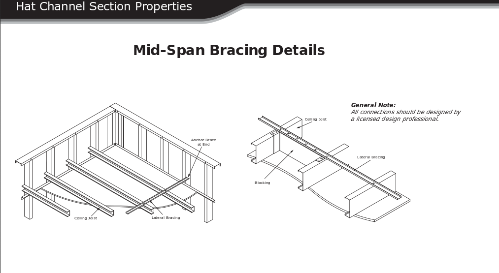

I mentioned to Steve yesterday that he should go with a drop drywall ceiling like Armstrong. The best would be to separate the ceiling from the floor joists, but I don't think that would be easily done or inexpensive.

Thanks, Spanky! I checked out the links, and that's actually a fairly complex system. It appears to be a system that experienced contractors mostly use, mostly in commercial, or heavy residential construction I'd guess. I'm not sure if it would be so suitable for a zero-experience DIYer, since even just the list of different parts for different site conditions is pretty bewildering.
I'm going to do some reading, but I think the RSIC clips and resilient channel on the ceiling may not be so difficult or expensive after all. According to this chart, I'll need right around 90 RSIC clips, and the channel, which will add probably $750 or so over doing nothing to the ceiling at all. Just putting Integrity Gasket on the ceiling alone would cost $150 or so, but that wasn't adequate in my last room, so the ceiling needs something.
More thinking... What a pain in the ass. This is a lot of work just to watch movies. Wink

I could see that. This is what I was thinking would be the best. Still not sure how to do it.

Yeah, in that drawing, they're showing a typical commercial scenario where you have say a 12-foot unfinished floor-to-floor height, and then dropping a finished ceiling down at 9 or 10 feet, leaving a 2-3-foot chase above the finished ceiling for HVAC ducting, electrical conduit, fire suppression, low-voltage cabling, etc. The ceiling joists are connected to the walls, hung from the structure above in the middle of the span per spec, and they joists are light metal because all they're holding up is a layer of drywall (or two) at 2-5 lbs/square foot. Compare that to a floor joist that's designed to safely handle 50 lbs/square foot of static and live load. That does give you pretty good isolation from the floor above, but at a cost of 4 inches of headroom. There's probably a good reason we've never seen that method employed in any home theaters on AVS.
I'm guessing the cost of the underlying structure wouldn't be that much less than RSIC clips - say $375 vs $750 - so, it probably does' make a lot of sense to try to cut corners there. That's my guess, anyway. I'll do some poking around on AVS and see if I can find any threads where anybody's done anything different than what we're all accustomed to seeing.
I'm still not sure what to do about all my soffit to contain all the ducting, or how to deal with all that. I'm assuming I'll need some sort of isolation clips on which to hang the framing for the soffit, then attach all the drywall to that. Not sure, though. More reading. Fun, fun.
