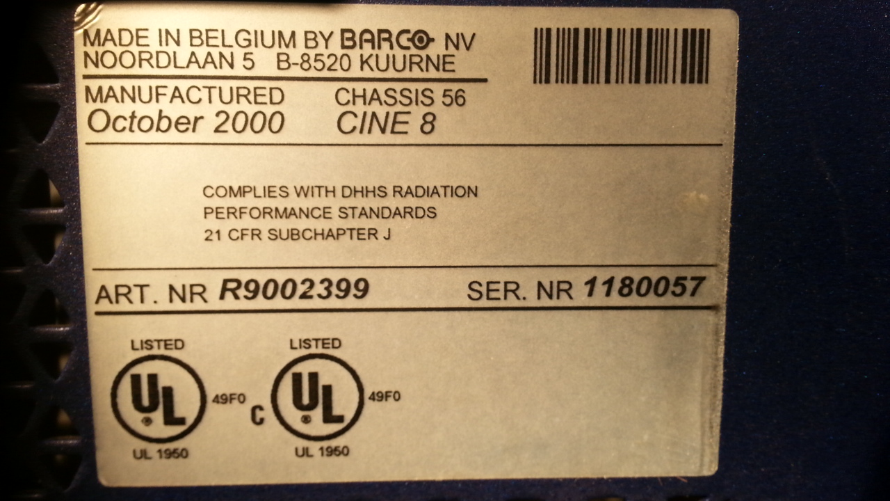

Do you mind to post a picture of the back-sticker on your Cine 8 ?

Thanks for the heads up about the Quads, I have sent the chap an email, also here is a picture of the back of the CINE 8
Cine 8 sticker
 Filesize:  323.6 KB
 Viewed:  6533 Time(s)

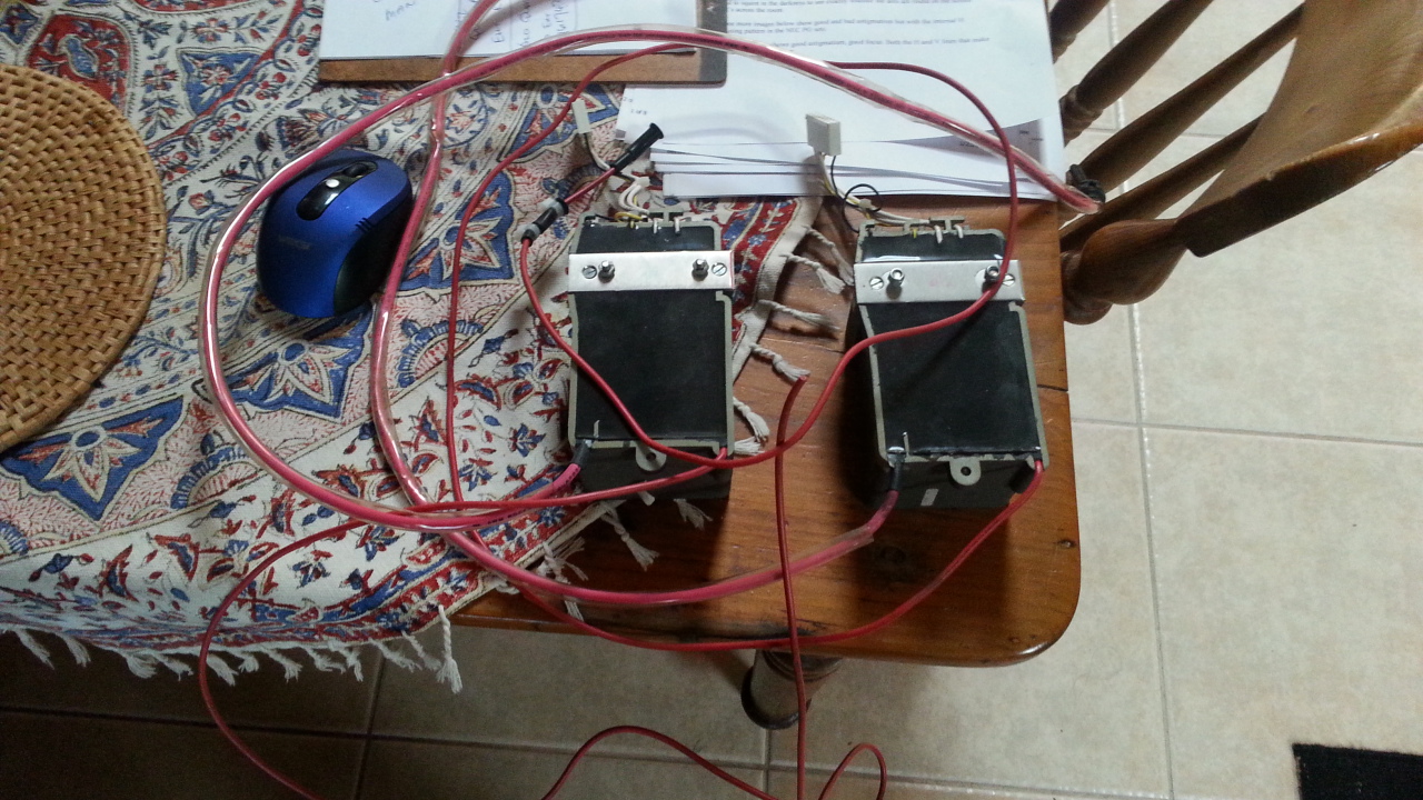

This is my new passion, I have started a collection, at the rate I am going I will have enough for a exhibition before too long !!
 Filesize:  488.05 KB
 Viewed:  6573 Time(s)
I think everyone on here has got some sort of collection. You only need two of something! Smile

Ok Trev, from the art.nr. i can see that it's a plain Cine 8, without power factor correction and without any form of internal deinterlacer ( lido, limo or limo pro ). It was for the north-american market ( 120V ), so you should check the power input module. Not only the 120-230V jumper must be switched but also those two fuses must be change for future protection. For 230V, 2X6,3A must replace the 2X10A ones.
The former owner(s) make a mess from it, mixing parts from other projectors. Shorter tubes, hence the need to cut some parts to compensate the focus coil, another version of G2 diagnostic board, another version of vert. deflectio and EHT module.
The best way to see if components belong to the projector is to check if the small sticker on each board match the serial nr. on the back-sticker of the PJ ( in your case 1180057 ). Watch the identification menu on screen, the same serial nr. should be found there too. If not, the controller was replaced.
Ofcourse, there is nothing wrong with not maching serial numbers, i only say that when we buy second hand and we have the chance to see the projector before buying, beside a honest seller, this is the only way to see if the machine was trouble-free.
However, there is a big deal when the replacement board does not have the same R76xxxx nr. Your EHT should be R7627165 instead of R762716. No Cine 8 was ever made without the newer version EHT.
I would get rid of Limo and COG modules too, it's just a way to complicate things even more. The internal scaler was designed for SDTV and COG module is for twin channel configuration and, again, no Cine 8 has ever leaved the factory with convergence on green. It makes no sense for HT use.
I hope you can buy the quad and EHT from Canada, the price is right if you ask me.

From your last pic. i'll blame the mouse for eating quads Very Happy

I have checked the EHT and Quad numbers here and it seems that the Quad IS an original part, the EHT is NOT original
i mentioned earlier that i noticed that the original Quad (that burnt out (on page 1 of this post) was very hot before it crashed, the replacement that I installed was from my BG 808 which also ran very hot, then gave off the metallic smell before failing (but nothing visible like on the original which showed burning (page 1)
I then fired up a BARCOGRAPHICS 801s which I have not run for 5 years that works perfectly, but the most noticeable difference was that the BG 801s Quad ran very cool to the touch even after 4 hours of running.
I am going to be getting the Quad and the EHT from the Canadian chap, the Quad is the correct number, but the EHT is different, but I will get both all the same, and hopefully all issues will be fixed, I shall also investigate the LIMO in the CINE 8 with the view to removing it, as of yet I have not investigated the rest of the boards ID numbers, but will do that in due course, the only other issue I need to resole is that at present I am running the BG 808 convergence tray as the resistors (as pictured) which are cooked are proving very difficult to find (want to fix this if only as a back up, other than that I am hoping that all will work well, Stefan (the Canadian) tells me it will take about 10 days to get the replacements ............then we shall see what happens, and I will be taking close attention to the heat that the replacement Quad will generate, if anything else comes to mind i would appreciate you letting me know, also obviously my thanks go to all others who have donated their time,thought and effort to this situation, and especially to Casey, and hope his recovery is swift.
