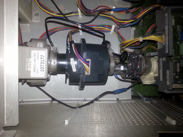

All the focus coils are the same, they all look alike to me, just to condense there is nothing
floating around in the machine everything seems to be where it should be, as you said there would be very little room to move on an 8" machine, although the BG808 has a ton of space along the tube neck, that's mainly due I think because the
G 2 boards are mounted above and to the rear of the neckboard that plugs into the end of the tube.
Here is apic showing the amount of space along the neck on the BG 808
BG808

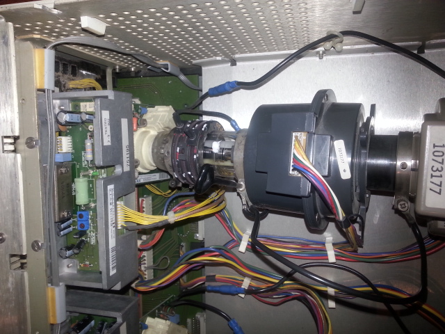

A better view of the space in the 808 which is what I half expected to find when I opened the Cine 8, basically they are the same physically just I understand a boatload of refinements, plus the Cine 8 is 5yeras younger than the BG 808 I have here
BG808

Thanks for your thoughts Hulio, however the neck board gear clamp is non-negotiable it's position on the neck is governed by the the heatsink attached to the circuit board and the yokes are tight to the rear of the tubes
Posted: Sun Dec 14, 2014 3:56 am    Post subject:
Yeah his theory there was the same as mine, if you stick a ferrous metal close to the coil, it has a huge impact.
The fact your issue is on all 3 tubes leads me to the focus board or system board, if not maybe even the quad or splitter, which im lead to believe can have an impact on focus too.
Do the clamps all have their black ground wire connected??
Do the focus coils have the same part number from the 808 and the Cine 8 you have there??
Is the focus board the same part number?
I don't know what is interchangeable between an 808 and a Cine 8, but it was also depend a bit on what model of Cine 8 it is, there is 3 or 4 different variants.

The problem is likely on this board
http://www.curtpalme.com/Barco808_Layout2.shtm
Do you have any spares? Try one if you do. Don't assume the focus coils need to slide forward toward the deflection coils either try moving the focus coils backward toward the neck board. It seems unusual that all three would be in the wrong position on the other hand the H-Shift and focus board is common to all.
Posted: Sun Dec 14, 2014 8:22 am    Post subject:
The focus coils cant really move Keith, theyrepacked on the neck tight as a drum. Its not going to be that, youd never get that much aft movement to need to wind the digital focus to zero.

They sure are on the same board. The coils should slide. I know some have packing that makes it difficult but they should move once the clamp is loosened. Having said that even if focus can be improved I would agree with you about zero focus. I would think the issue is on the H-Shift and Focus board.
Posted: Sun Dec 14, 2014 10:19 am    Post subject:
There is nowhere for them to slide, looking at the pics on the previous page it seems to be simular to the XG where everything is hard up against the next all the way from the deflection coil to the neckboard.
Either way, youd have to move them a considerable amount toward the neckboard to make the focus still blury at zero, when they look like theyre allready hard against the deflection coil. That is clearly not going to be the issue here, not on three tubes.
Being that the chassis is alloy and non ferrous, we should be able the rule out the need for a degause due to residual magnetism...
Posted: Sun Dec 14, 2014 11:34 am    Post subject:
I have the same setup. Either remove the front mount for the RGB amp or reverse the plastic part that goes around the tube.
