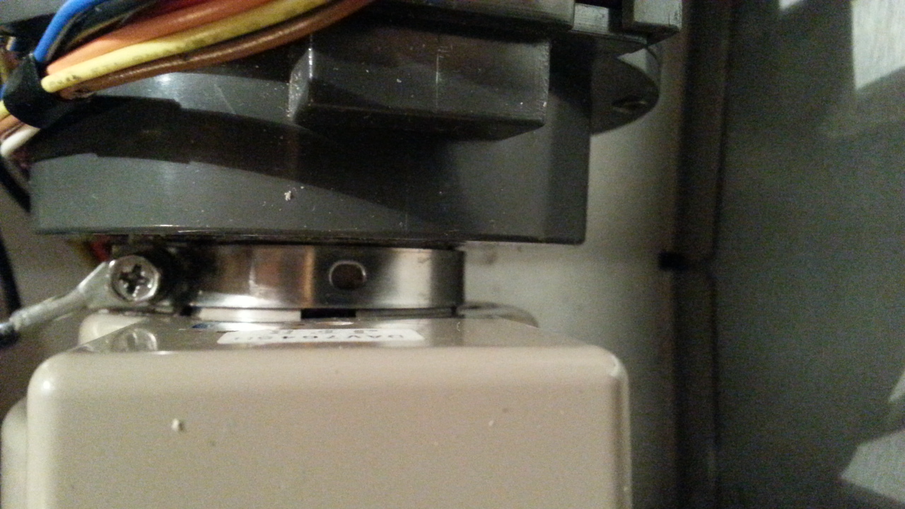

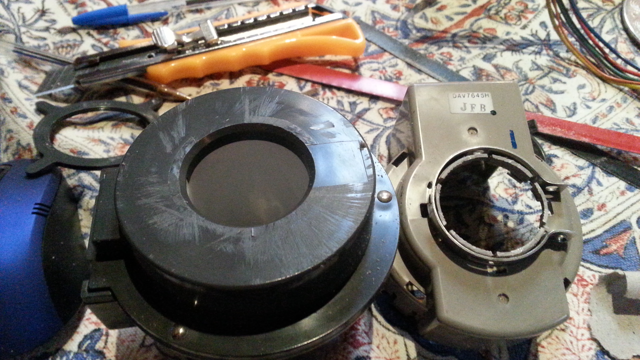

Posted: Fri Jan 16, 2015 9:22 am    Post subject: Barco Cine 8
Yoke and coil alteration
 Filesize:  367.59 KB
 Viewed:  4193 Time(s)

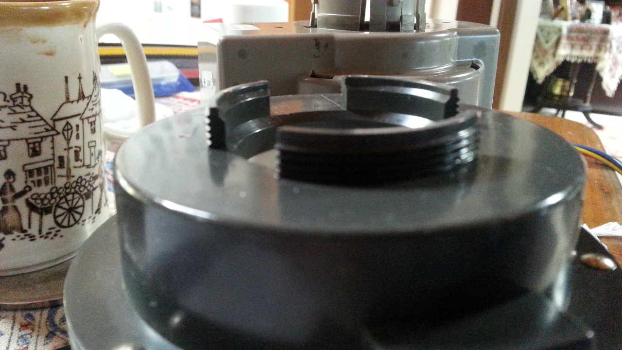

Posted: Fri Jan 16, 2015 9:23 am    Post subject: Barco Cine 8
 Filesize:  432.78 KB
 Viewed:  4188 Time(s)

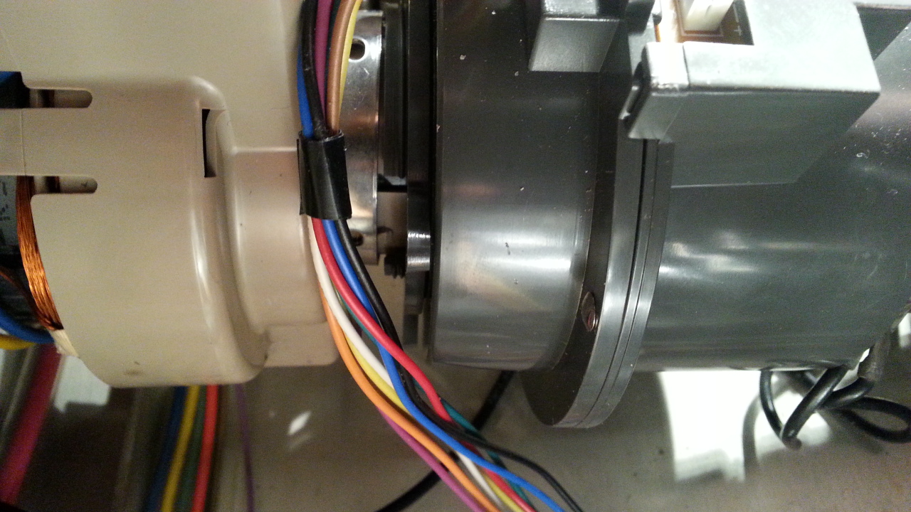

Posted: Fri Jan 16, 2015 9:24 am    Post subject: Barco Cine 8
 Filesize:  414.09 KB
 Viewed:  4183 Time(s)

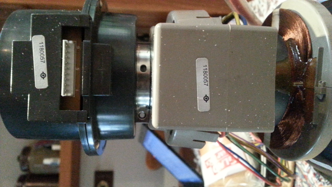

Posted: Fri Jan 16, 2015 9:25 am    Post subject: Barco Cine 8
 Filesize:  263.54 KB
 Viewed:  4179 Time(s)

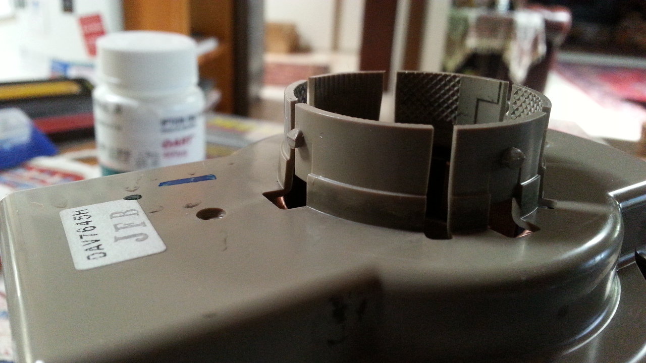

Posted: Fri Jan 16, 2015 9:26 am    Post subject: Barco Cine 8
 Filesize:  370.93 KB
 Viewed:  4176 Time(s)

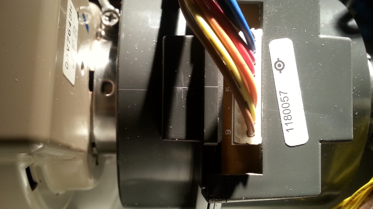

Posted: Fri Jan 16, 2015 9:28 am    Post subject: Barco Cine 8
 Filesize:  491.19 KB
 Viewed:  4174 Time(s)

Posted: Fri Jan 16, 2015 9:31 am    Post subject:
Nice work. Has it made any difference?

Posted: Fri Jan 16, 2015 10:04 am    Post subject: Barco Cine 8
As you can see Casey, (spent all day doing this) really hard plastic, used a hacksaw blade, also after inspecting the "job" this morning I realised that to actually make any difference at all I would have to cut the yoke lugs off at the point where the clamp was originally and cut the focus thread off completely, however I did notice that removing the coil thread completely left me with no facility to centre the coil on the rear of the yoke, but it would give us more forward movement, this I have done,
After putting it all back together the yoke seems quite stable, and the coil is now only held by the back clamp, all pushed up very tight, and because the coil is so tight to the rear of the yoke assembly, what little play there is in the coil laterally is non existant so everything seems to be OK, do not know what might happen when the unit gets very warm, there may or may not be issues with regard to expansion.
Apart from the fact that your blood is worth bottling, the before and after results are as follows
BEFORE BEST FOCUS
RED= 15
GREEN =13
BLUE = 10
AFTER ALTERATION BEST FOCUS
RED = 44
GREEN = 33
BLUE = 30
Having said that those figures are based on no manipulation of the astig rings from neutral, I will get to that later, if you think that these numbers are now acceptable, I will make some arrangements to get the thing inverted on the ceiling and set the whole thing up.
With regard to your comments about the HD Fury I heartily agree but our budget does not really run to that (maybe one fine day) I do want to see what happens with the Fury or Moome, or whatever come along it would be nice to see what the CINE really can look like especially with the new tubes
I am sure I am not finished with this by a long shot, but I heartily thank you and yours for such magic support !!
Trev
Posted: Fri Jan 16, 2015 10:15 am    Post subject:
Mate its no worries at all, im glad we got you sorted. We have been over that set with a fine tooth comb, and it should now serve you quite well for a fair while to come.

Posted: Fri Jan 16, 2015 10:26 am    Post subject:
Early on in the piece it was really quite a hard call to make, i was swinging between tube issues and potential splitter issues, it sure did seem to me as though the set was operating fine electronics wise.
What you want to do with that blue is get your astig as perfect as you can mechanically, set the electronic astig, then set all zones of electronic focus as even as you can, and i would then add ten to your centre focus number. This should give you nice even blue defocus for good greyscale, and blue being over focused like that will have no real impact on your overall image sharpness, the NEC sets actually have a switch or menu setting to do this automatically. Colour reproduction will be alot nicer and more even.

Yeah mate those numbers are what i would consider as good as youll get, and shouldnt have any negative affect on stability.
