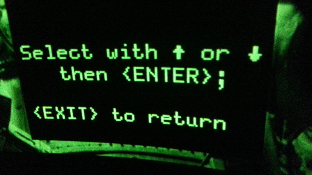

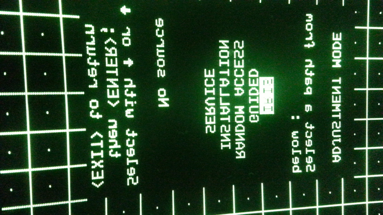

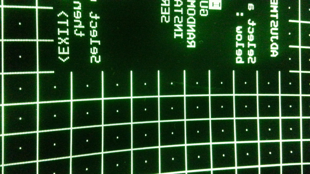

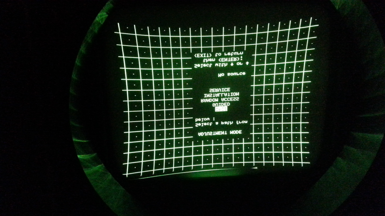

OK, so that we are all on the same page here these 3 pictures are if the GREEN faceplate focused at 10 electronically.
To the naked eye I can see quite clearly the whole line structure from top to bottom and both left and right, in fact you should be able to see it yourselves in the pics these pics were taken with both the luminance and black level (brightness) at minimum.
I have looked at this pattern through a magnifying glass also and it certainly appears quite sharp to me

faceplate

faceplate
faceplate

faceplate
faceplate

Posted: Thu Jan 15, 2015 9:13 am    Post subject:
There is no doubt that is pretty near optimal electronic focus seen in those pics Trev yes.
Posted: Thu Jan 15, 2015 9:14 am    Post subject:
Scanlines are easily seen and are sharp.

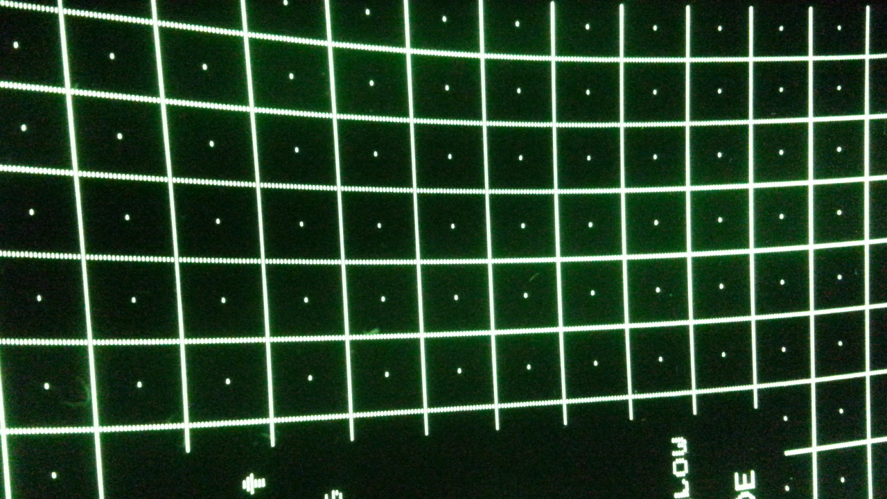

On Green only focus on 7
input is running at 960p, so far the looks the sharpest out of the scaler,
960p

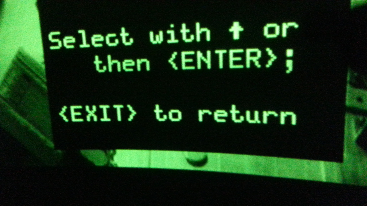

scaler at 960p
scaler at 960p

The source material is a blu ray coming out of the player as component and scaled up through the Lumagen to 960p and leaving there as RGBHV
These pictures were taken about 2 foot from the screen
the cameras resolution is set to 1280 x 720
