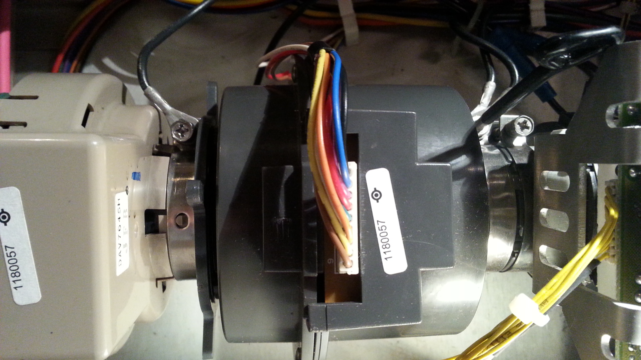

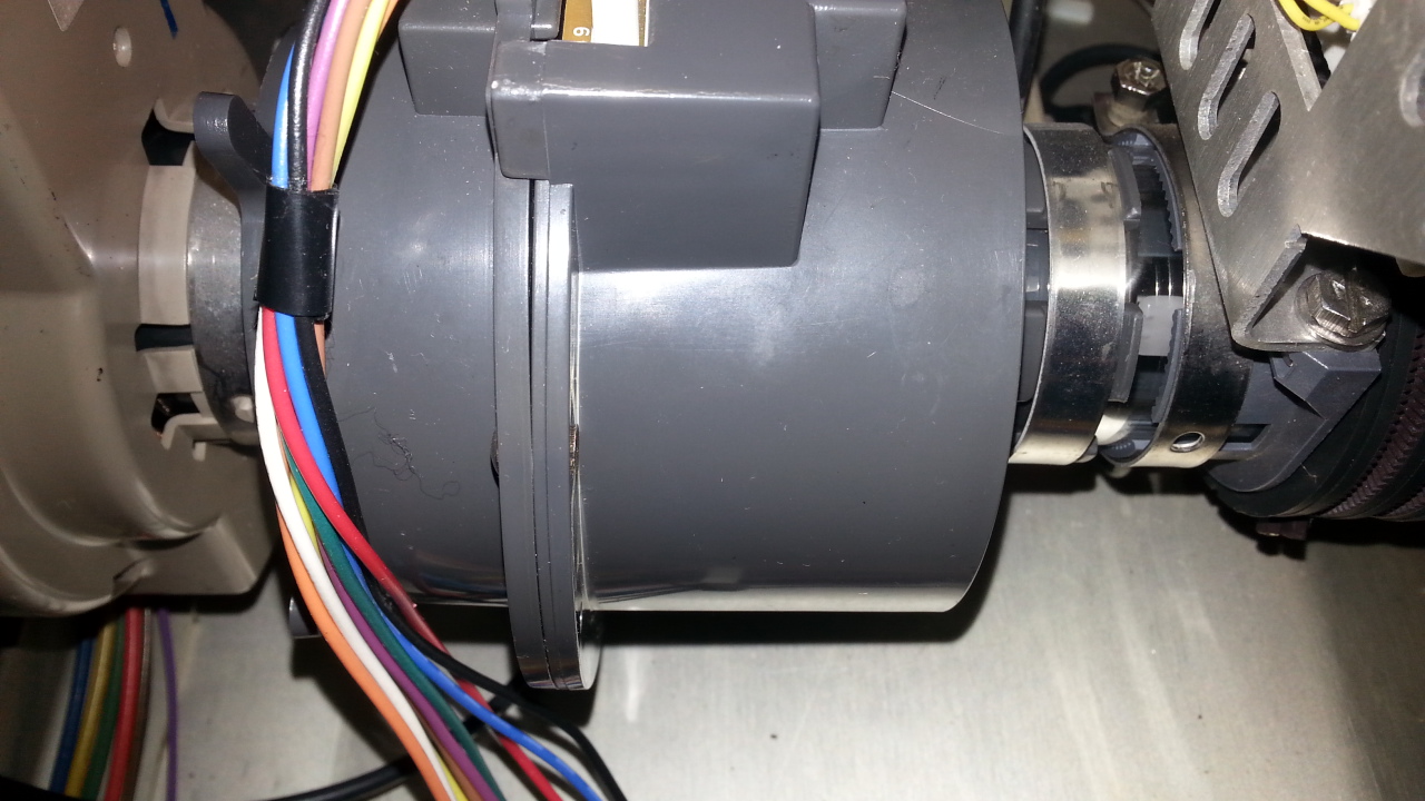

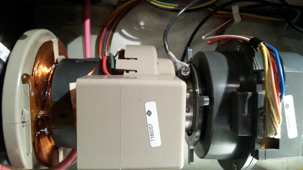

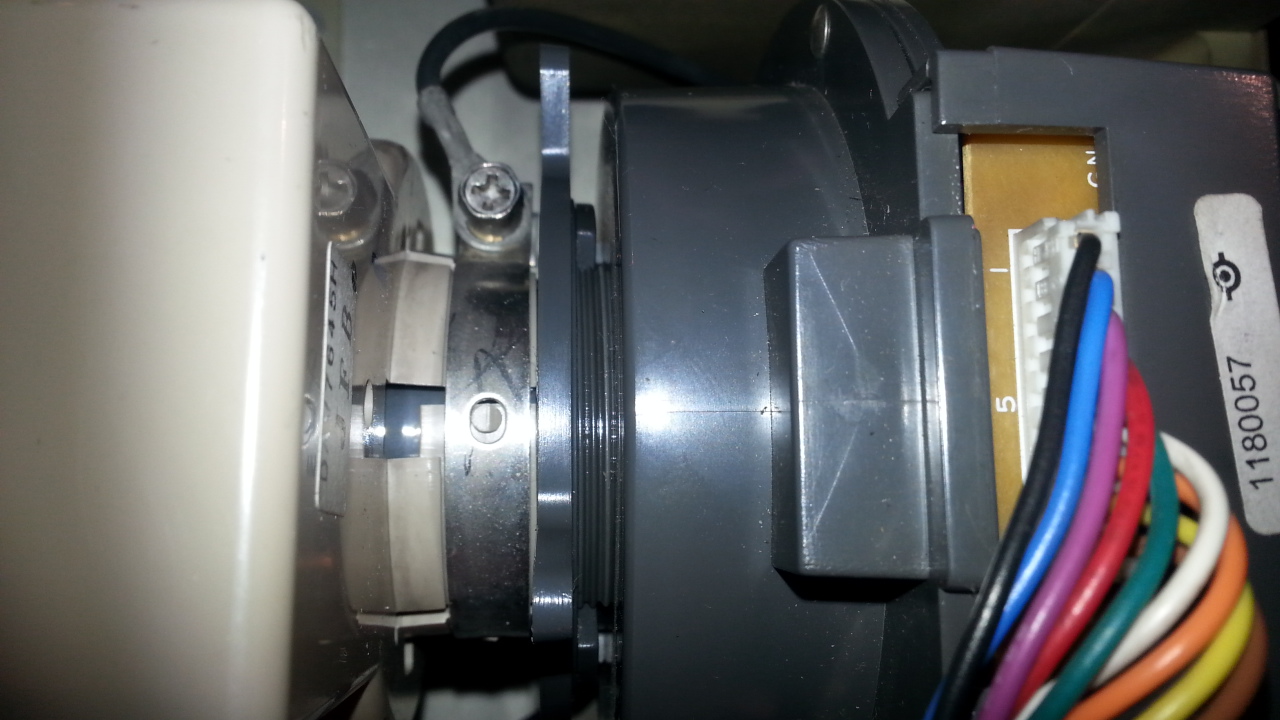

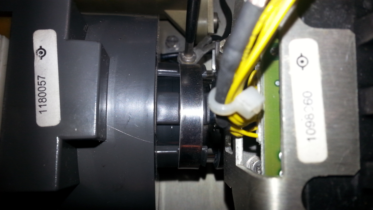

BARCO CINE 8 focus pics

Posted: Mon Jan 12, 2015 12:38 pm    Post subject:
Removing that front ring and the flange should get you there, but wait for someone else to give the nod on that Wink
