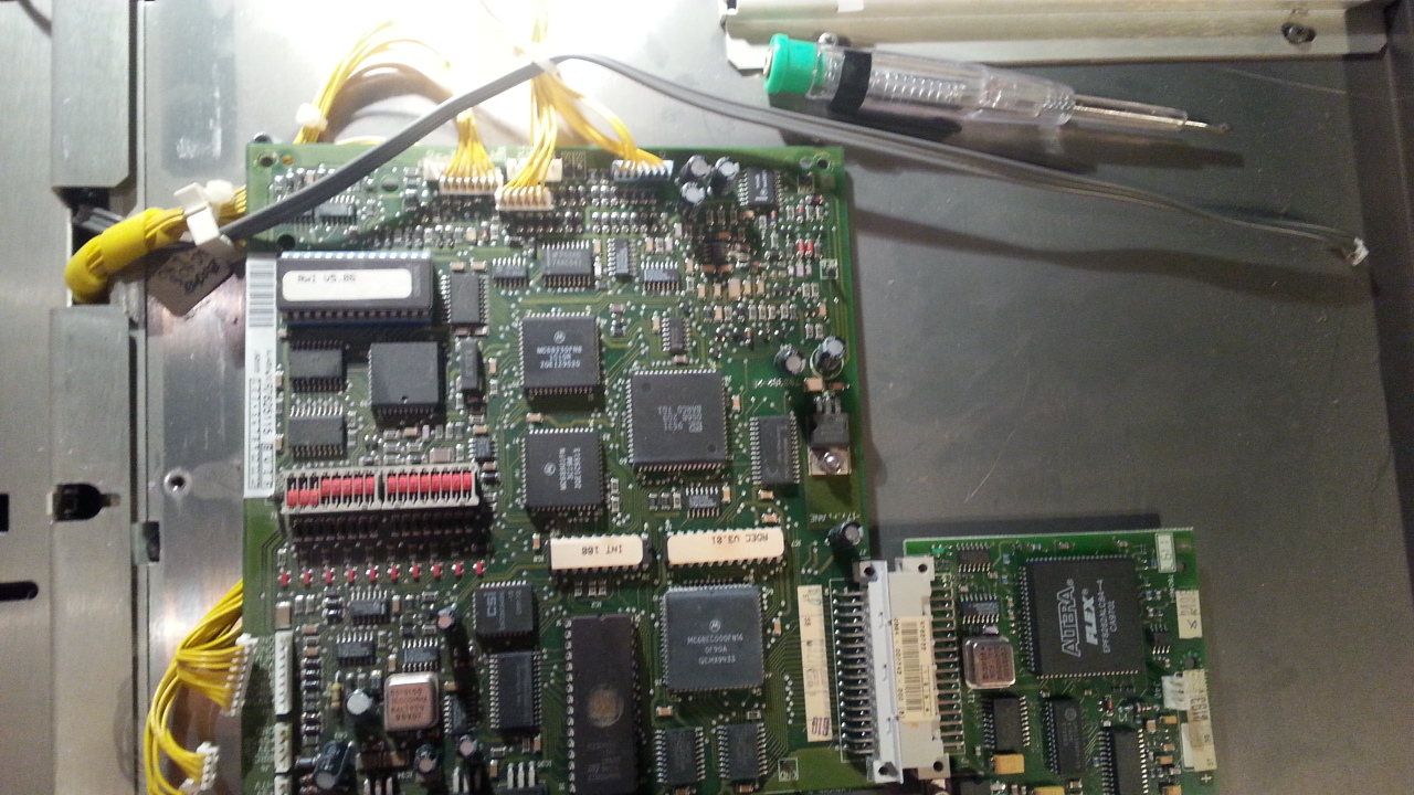

Those pictures are of the control board. The LIMO is a separate board and should be mounted to the left of the control board if your are standing behind the projector.
That cable runs to the switcher board. Remove it from there!!
I looked at that a second ago thinking there are no soldered wires but there is one but as mentioned it can be disconnected from the switcher board. Just remember to re-connect it before power up.

HI Casey,
Top center it's the fourth on the right

No i think that is part of that board, unplug it at the other end

The blue plug has a white plug on the other end of the cable which is on the switcher board. You can remove it from there.

You can also leave the Iris board off (the small board attached to the control board) no need to use that for this test. Just change the control board with no other boards plugged in.
