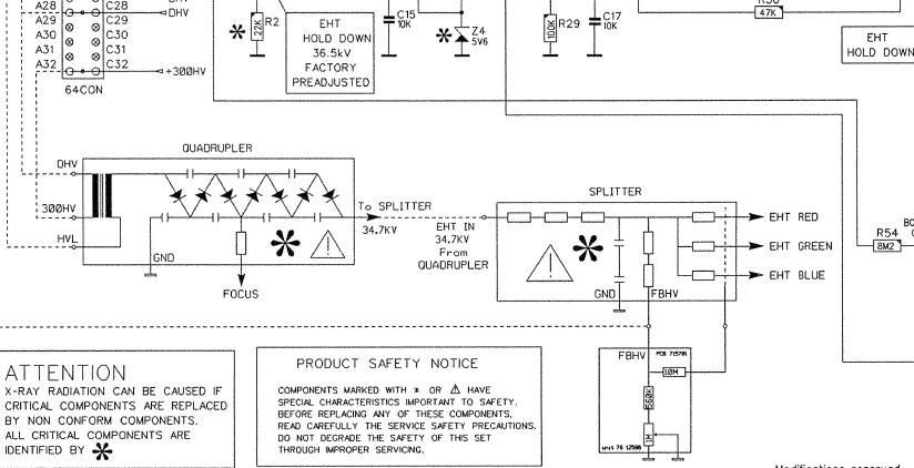

Posted: Mon Dec 29, 2014 3:37 pm    Post subject:
A focus board does not have any surge protection on its output lines and therefore can be damaged if a connection is altered while the unit is powered up.
A splitter has resistors built in for power dissipation and arc suppression. A change in value of a resistor can cause a reduced HV on a line which would show onscreen as a focus issue.

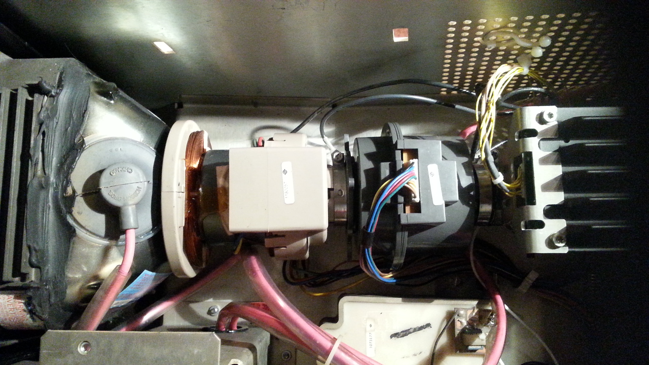

Posted: Sun Jan 11, 2015 1:48 pm    Post subject: Barco Cine 8
Well boy's..just when you thought you might be rid of me, I am back with the results of the attempts to date, but first I hope that all of you have had a happy and safe Christmas and New Year (or Holiday for those who may not celebrate the season)
First of all I will go thought what I have done to date.
1. Fixed the SMPS board (fuse), everything now OK all GREEN on the SMPS board.
2. Have swapped the SMPS boards between the BG 808 and the CINE 8, both perform OK in either machine. (it takes a little time to swap them around as I only have the one QUAD to share between the two at present).
3. I have managed to identify the GREEN gun (for which I indicated I have no info on )
RED: BARCO P16LNP07RJA
GREEN: PANASONIC P16LNP07HKA
BLUE: PANASONIC P16LNP07BMB
4. The voltage on both SMPS boards are reading 17.2 volts
5. The Yoke have been checked, and they are all hard up to the bells.
6. i have noticed that the focus coils(which are hard up to the focus yokes as previously mentioned,
rotating then around the tube neck does not actually do anything, they do not have any influence on the crosshatch displayed) they neither affect the focus nor the position of the image. (so don't know the answer to that one)
7. I have changed the splitters between the two machine and there is absolutely no difference between either if them.
8. I have swapped the two convergence trays between the the two machines, (there is no difference there either.
So bonnie lads, basically I am back to square one with the focus issue still can only get (reasonable) focus at/or around ZERO on all 3 guns, the only thing it suggests to me is that whatever it is is common to all 3 guns, so it's obviously not the guns there must be something else which is common to all 3, this is where the ball is chucked back into your courts.
9. I will post a few pictures of the mess I am in currently, and a few shots under the hood!
Hope you all have not run for the hills !
Regards to all,
Trevor

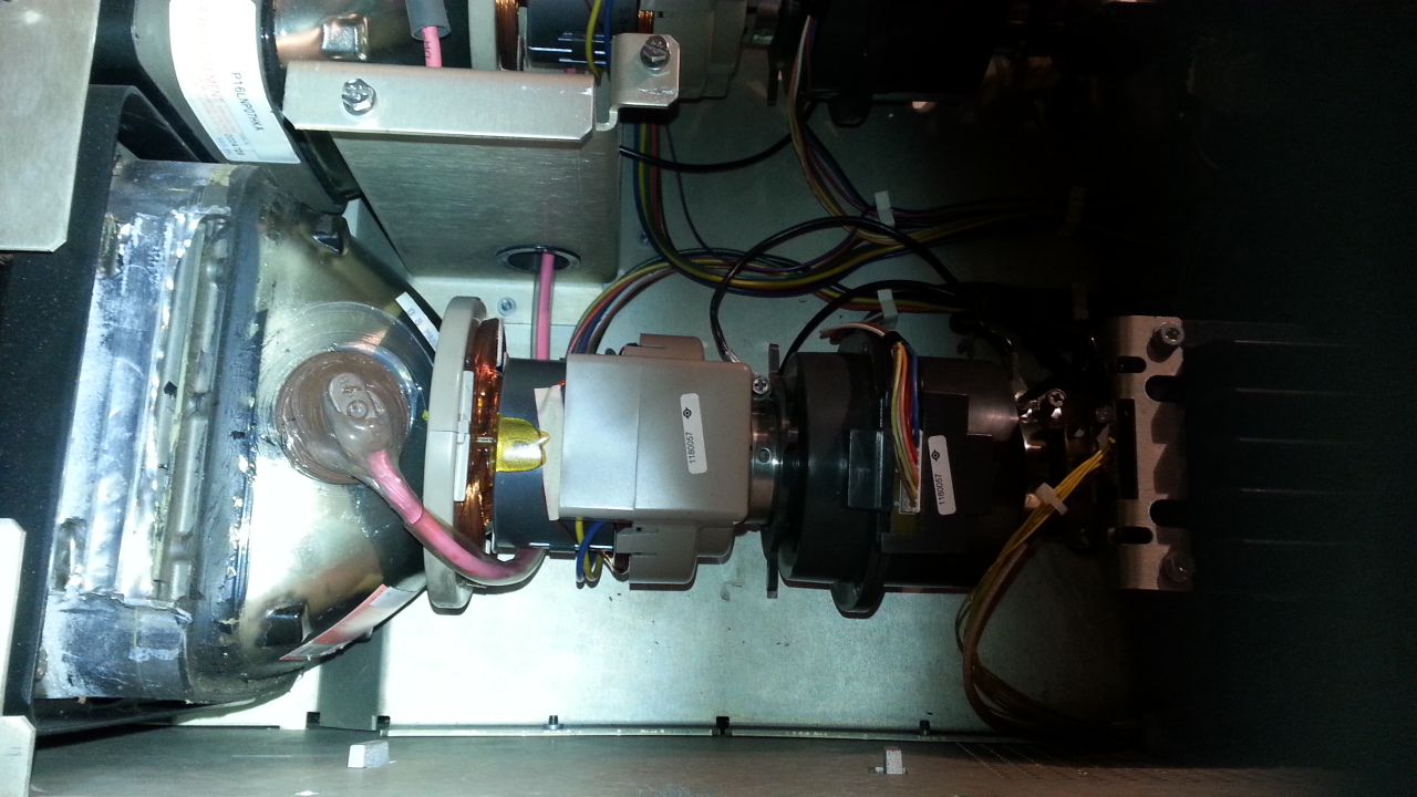

Posted: Sun Jan 11, 2015 1:54 pm    Post subject: Barco Cine 8
Splitter swap
 Filesize:  297.79 KB
 Viewed:  4815 Time(s)
