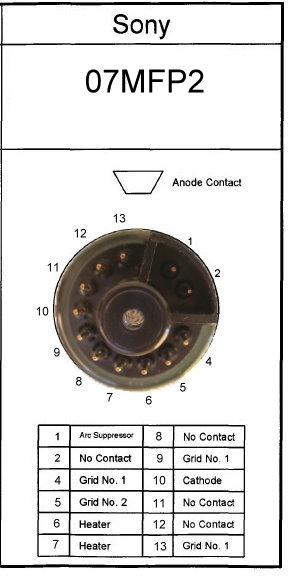

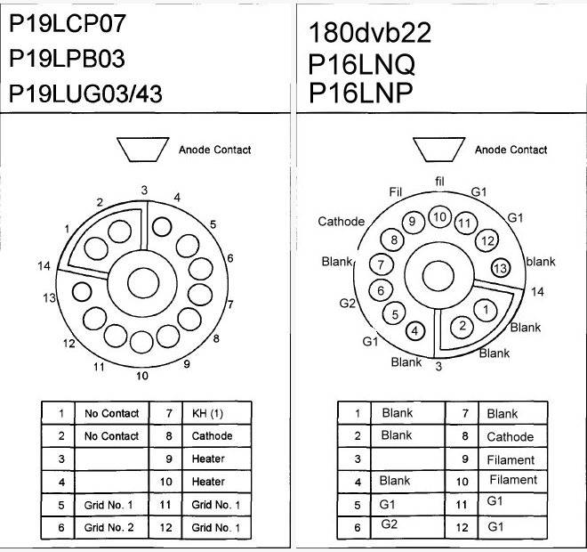

All P tubes are MEC tubes. Panasonic=MEC ( Matsushita Electric Corp.) but not all P16's tube are the same. When repalcing tubes, the abreviation after the tube size ( P16 XXX ) is important. They may fit physicaly in the neckboards but they could have different pin assigments. They are also designed for LC or AC optics. If the Cine 8 came from factory with sony 07MFP02 tubes, in order to put P16's in it, a neckboard mod. is needed. Here the diff. pin-outs layout of both tubes.
@ redfox: Not the tubes are responsable for better contrast and less hallo effect but the LC chamber. The glycol between the tube and lens. Only Cine 8 Onyx and retro 808 variants were Barco's eight inch LC projectors.
Trevor, is a shame that you ended up with that machine. Eventualy, it can be reanimated but you are not there yet.
The cheapest and least time ( and money ) consuming way is to find good Sony 07MFP tubes and keep the HD8 reb.B lenses.
Another way is to go with P16 LXW tubes. Those were fit on later Cine 8's but you have to mod. the neckboards for pin compatibility. However the tubes are hard to find.
Or, the most expensive and not worth the trouble if you ask me, put LC chambers on your tubes and lenses from a Zenith 1200 Pro.
 Filesize:  93.34 KB
 Viewed:  8529 Time(s)
 Filesize:  36.57 KB

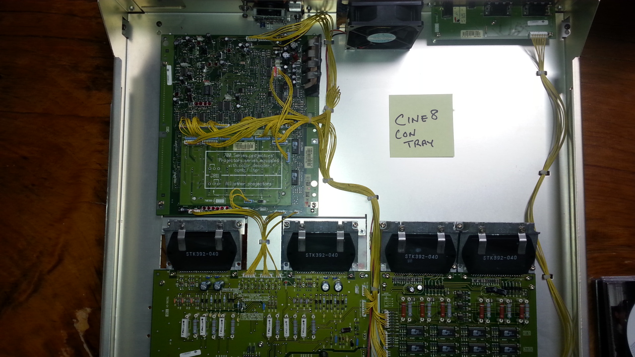

Posted: Fri Dec 26, 2014 12:24 am    Post subject: Barco Cine 8
Cine 8 convergence try
This is the Cine 8
 Filesize:  385.2 KB
 Viewed:  8489 Time(s)

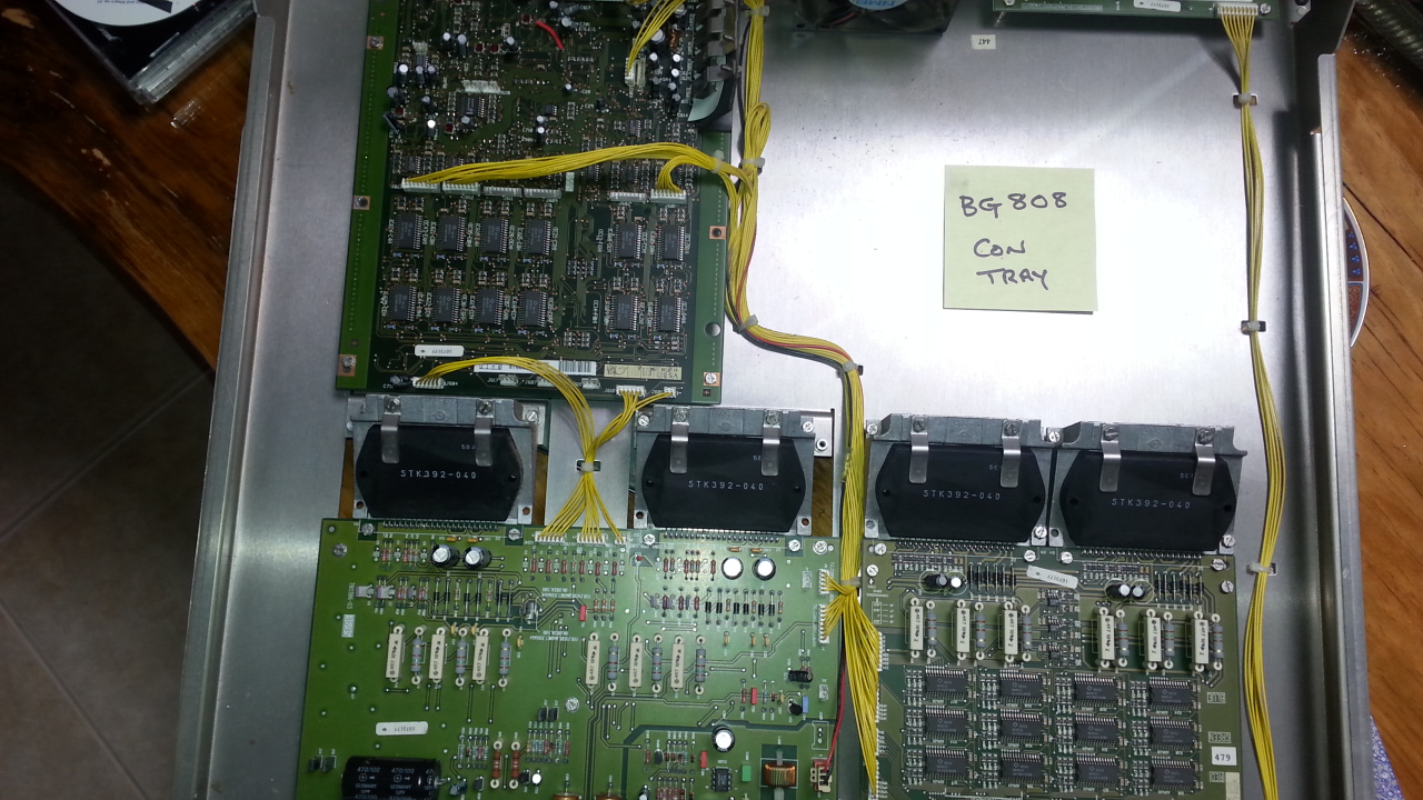

Posted: Fri Dec 26, 2014 12:25 am    Post subject: Barco Cine 8
BG 808 Tray
BG 808 tray
 Filesize:  432.3 KB
 Viewed:  8486 Time(s)

Are those pictures good enough for what you are looking fr, r do yu want more detail and ID information

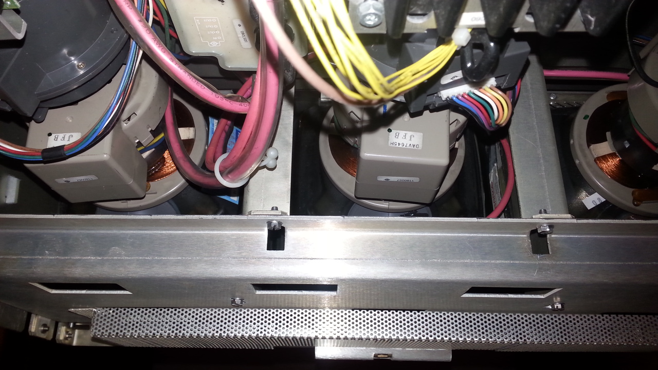

Posted: Fri Dec 26, 2014 3:10 am    Post subject: Barco Cine 8
Here are the pictures of both projectors yoke positions, they are all up tight to the bell of the tubes
BG 808
 Filesize:  360.88 KB
 Viewed:  8421 Time(s)
dentree
Joined: 01 May 2009
Posts: 247
Location: Melbourne Australia
TV/Projector: BARCO GRAPHICS 808 BARCO GRAPHICS 801
Posted: Fri Dec 26, 2014 3:15 am    Post subject: Barco Cine 8
This is the Cine 8
This is the Cine 8
 Filesize:  393.36 KB
 Viewed:  8426 Time(s)
Posted: Fri Dec 26, 2014 3:33 am    Post subject:
What are the yoke numbers?
Im way out bush at the moment in the hot sun, having alot of trouble seeing the phone screen, so im not sure if theyre visible in your pics or not.

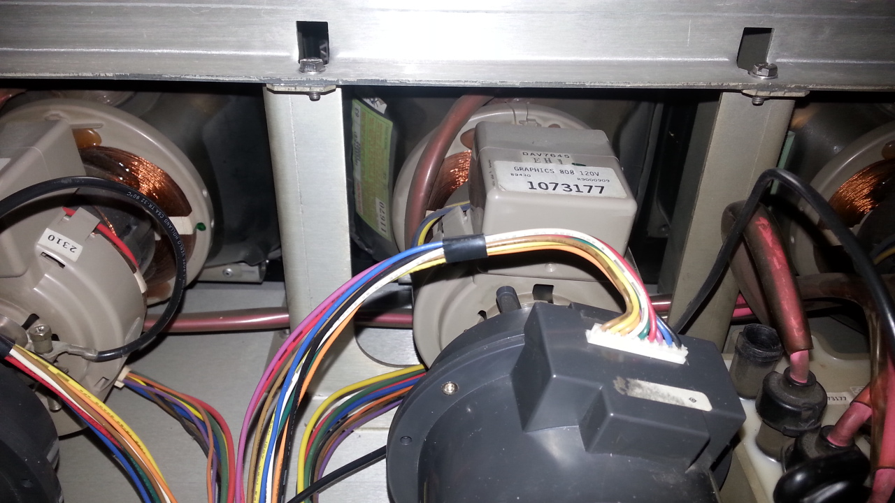

Posted: Fri Dec 26, 2014 3:39 am    Post subject:
Here are the only numbers I can find on the focus coils the
BG 808 has identical numbers on each coil which is: 1073177
Cine 8 also has identical numbers on each coil, which are: 1180057
