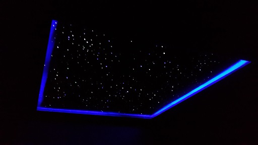

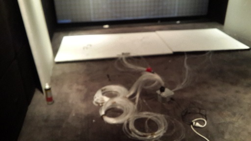

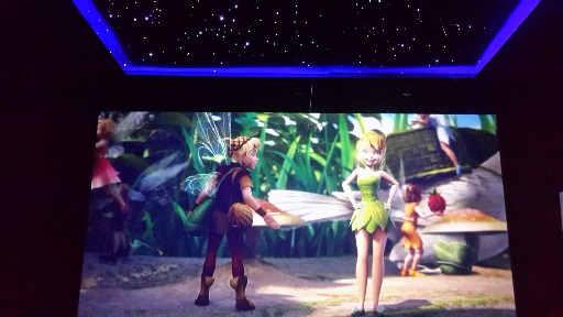

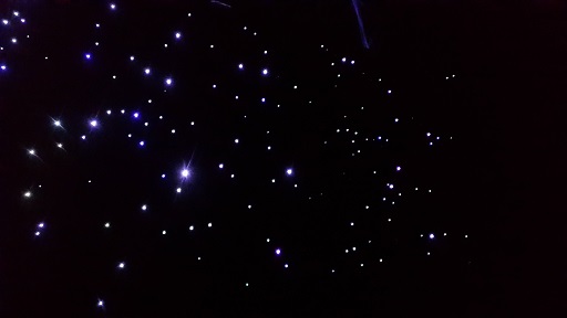

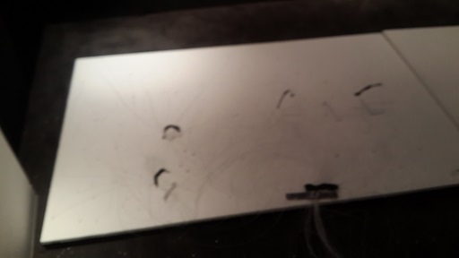

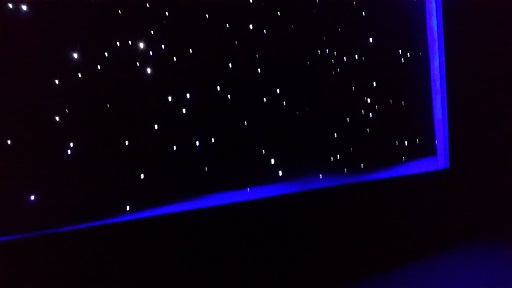

Well Star ceiling is now complete, not as bad job as I thought, I just bought 40mm foam,wrapped it with velvet vinyl wrap and punched holes with a skewer, easy ! here are some pics Smile

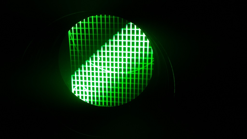

Got an issue with one of the green tubes, it seems like image doubling, i.e same image just slightly less bright over the whole tube just shifted over a little.
Here's a pic but it's not very obvious here

Posted: Sat Feb 07, 2015 3:07 pm    Post subject:
Possible loss of the shield wire on your G cable. Does the internal test pattern do it?

Posted: Sat Feb 07, 2015 9:15 pm    Post subject:
This the external pattern, haven't tried it on internal as it comes and goes, for example I watched 2 movies last light with nothing. Sheild wire on the G cable? You mean internally or externally?
Posted: Sat Feb 07, 2015 10:19 pm    Post subject:
Somewhere between the source and the projector, usually the shield flakes out at either end. The next time it does it, go immediately into the test pattern mode, and report back.

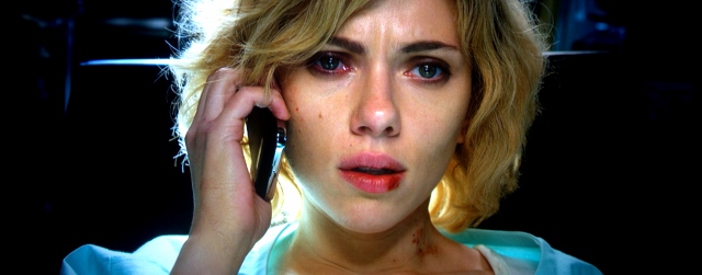

Posted: Mon Feb 09, 2015 9:01 am    Post subject:

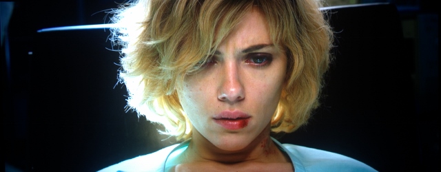

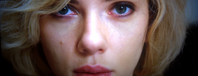

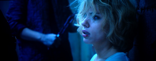

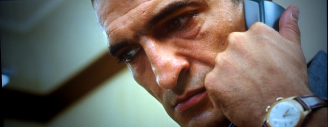

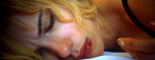

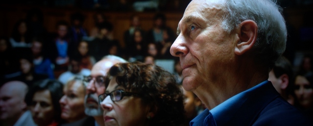

I can't for the life of me get these shots to mimic whats on screen, I'll keep trying though Smile
As half arsed as they are, it's something Smile

Posted: Mon Feb 09, 2015 9:07 am    Post subject:
F*** it looks quite good from up here!!

Posted: Mon Feb 09, 2015 9:53 am    Post subject:
These things put out an amazing image when the source is good Smile

Posted: Mon Feb 09, 2015 10:41 am    Post subject:
Great shot! Why do we so seldom see these shots from other projectors than the 909 I wonder (MP being an exception). I have them too. There is depth. Also seems good calibrated.
