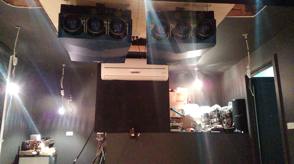

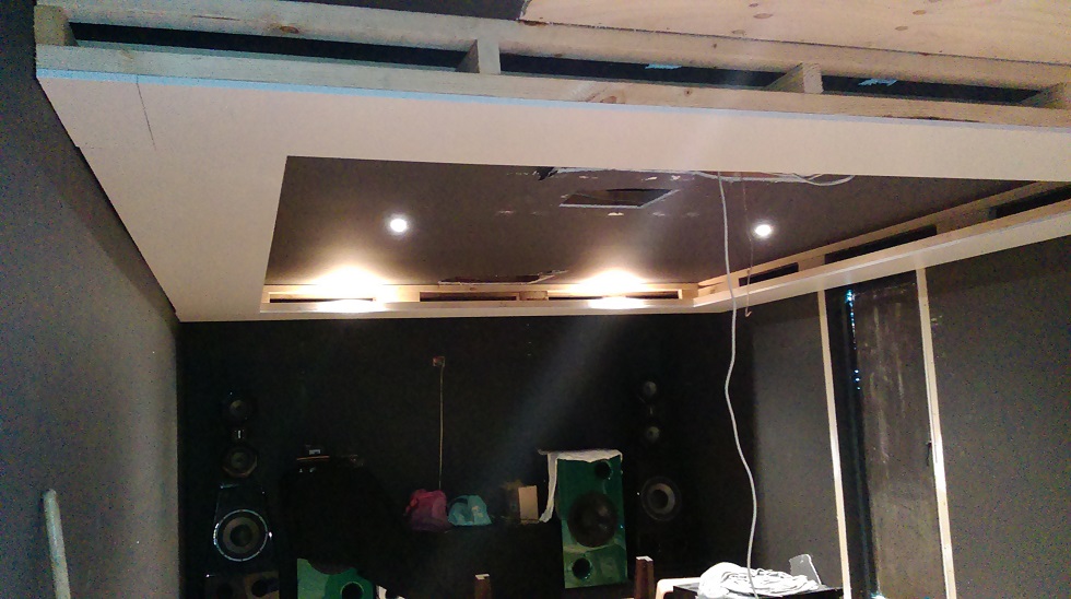

Well I've been lazy lately so bout time I threw up some pics of the never ending HT build. I have the black wall panels, custom lounge on order and star ceiling to put together, fun!
bulkheads for led lighting

Black velvet covering bulkheads

over 1000 lbs of speakers and subs

12ft wide big ass screen
