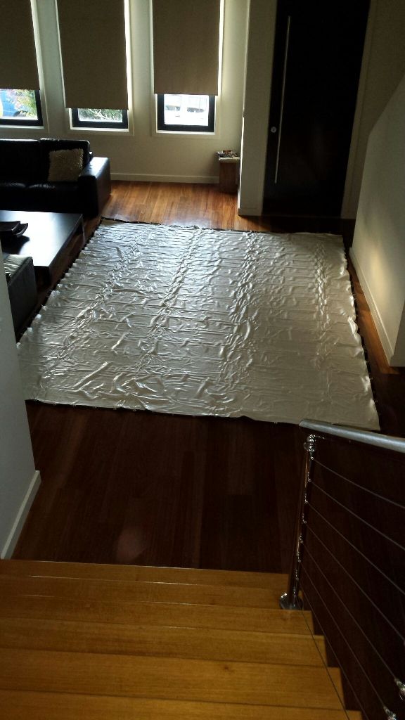

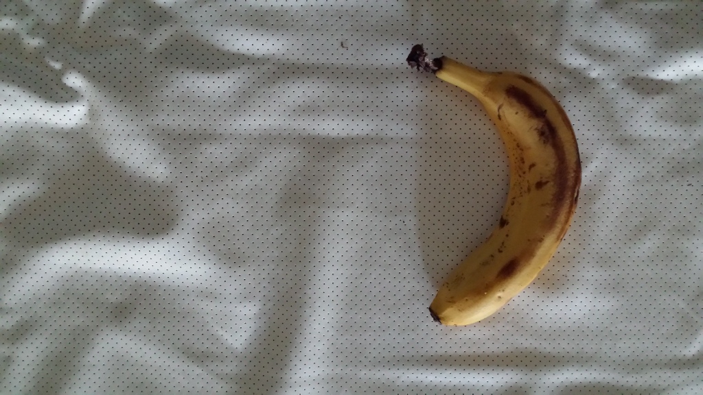

Posted: Fri Nov 21, 2014 7:38 pm    Post subject:
Well I pulled out the old stewart Ultramatte 200 from storage to see if there was even the slightest possibility of using it. It's 4mts by 3 mts,perfect for what I need dammit.
Here she be, banana for scale of course Laughing
It will be 12 ft wide 16:9 screen, so I'll be sitting about 12 to 14 ft from screen, you guys reckon I'll see the perfs?
