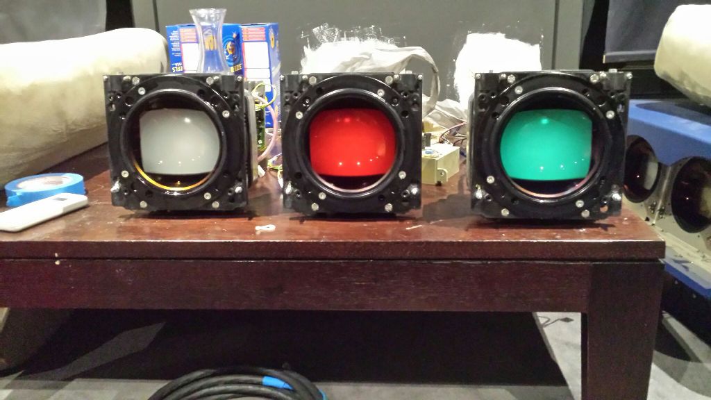

I've installed my first set of C elements,changed the Glycol and hopefully will install them tomorrow,just making sure there are no leaks. Then it's time to work on the other one Smile

Aint they purdy? Mr. Green Mr. Green Mr. Green

Your tubes look a bit wet from glycol? make sure to rinse them with water very well and let them dry before installing all neck assemblies. Corrosion will lock your bolts and you'll never get those loose again if you ever have to take out c-element again.
Nice catch by the way! get some Barco-HD boards from moome for your input.
