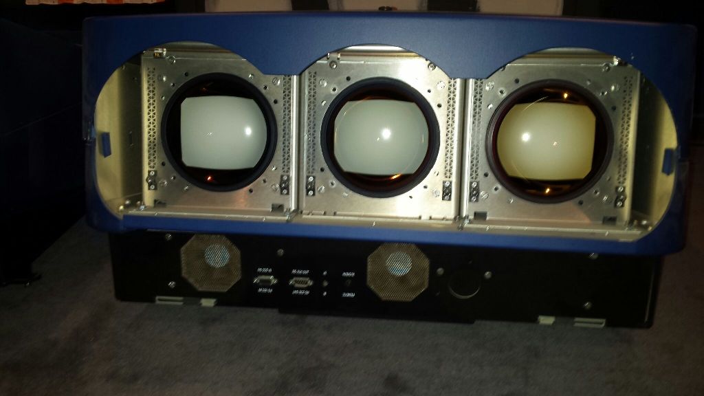

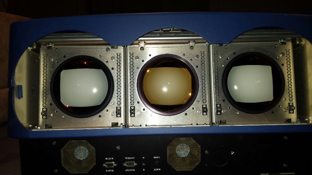

These 2 are the worst of the lot, it's not this bad in person due to flash however, the wear doesn't make sense, there is no wear pattern, nothing, the whole tube has same colouration, what gives?

Either they ran max tube face for very long hours at low outputs or the glycol is stained. The blue on the second pic looks to have stained glycol, since its clearer in the center.
How many hours on the sets?

Posted: Sat Nov 22, 2014 7:54 am    Post subject:
My initial thoughts were stained glycol as well but these were maintained by Barco Technicians whom I know.
The sets have 22 k hours on them, yikes! Very Happy
Posted: Sat Nov 22, 2014 8:30 am    Post subject:
Perhaps the tubes don't have many hours. The stained glycol could simply be from some sort of contamination in the LC tank particularly if the tubes were replaced using the original tanks rather than switching out the entire unit with the LC tanks. I would have said exposure to reflected sunlight but how would you get that in planetarium?
Posted: Sat Nov 22, 2014 1:21 pm    Post subject:
If it was sunlight id expect it to be rather uneven, and probably have buggered C elements.
I know they were well maintained, i spoke in some length with Phil about them on the phone, but they were indeed sitting unused for a long time!!
Posted: Sat Nov 22, 2014 4:12 pm    Post subject:
you SUCK, and yes, the glycol is bad. When getting projectors from planetariums, they're projecting black all the time, so there's little tube wear. Watch for pinpoint phosphor burn from stars and planets though.

Posted: Sat Nov 22, 2014 7:27 pm    Post subject:
In January I'm getting in 9 Barco 1209s from a planetarium as well. Some have new tubes, others will have slight wear. Will get my 909s running, and will sell stuff CHEAP! Smile
Very Happy Very Happy Very Happy
The first thing I checked was star and planet burns but none have them, all the pjs seem to have the tainted glycol in one or more tubes, I guess this means all the tubes in all the pjs are minty Very Happy Very Happy Very Happy
