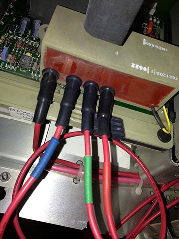

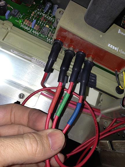

Hi, can some one tell me what the correct wiring is for the Red, Green, and Blue focus voltage wires which are hooked up to the focus block. Does the wiring match the order of the trim pots behind the focus block? I've taken a couple of photos of possible options. The wires are color coded.
Option 1 matches the order of the trimpots
Option 2 matches the photo of the board shown on Curts 808s layout page (under setup tips & manuals).
I'm thinking it is option 1 but Curt's photo shows differently. It could be the wires in his photo are not properly color coded.
If I get it wrong will I blow anything up?
Option 2_match layout photo
 Filesize:  73.46 KB
 Viewed:  5783 Time(s)
Option 1_match trimpot order
 Filesize:  64.91 KB

I converted my BG808 to a BG808S. I now have sony tubes and the 120 mhz amps. Each RGB amp has a red wire which is to be hooked up to the focus block. Per Curts 808 description:
"In BG 808s sets that use Sony tubes, this block also feeds the 5Kv focus voltage to the tubes (not used in the other 808 models.)"
One wire does go to the quadrupler and that is not in question (it's the wire on the left in my photos).
I think it is important to have the wire hooked up...the order I'm not sure. Why would Barco add the wire if it had no reason to?. Also, I think the order is important otherwise they would not have color coded the wires.

If I understand correctly it matches my option 1 photo (see titles, its the second photo)? Is the focus block the same part #? I don't know if the data 500 is the same.... Anyone with an 808s?

So I'm a bit confused. It seems the consensus with those responding to this post state the wire has no use. However, Curt states it
"In "BG 808s sets that use Sony tubes, this block also feeds the 5Kv focus voltage to the tubes (not used in the other 808 models.)"
The above thoughts seem to contradict each other. Regardless it seems that it can't hurt to hook the wires up but I'm not sure why the order would be important for the ES set and not the EM set if the focus block has the same function. Does anyone have a Barco reference (schematic or the like) they could share which confirms some of the conflicting information.

The order is Important on an ES set as this is the only focus method on those sets and there is a separate focus control for each colour on the focus block. It's irrelevant on an EM set as there are no individual focus controls on the focus block. I would add that ES focus is a mechanical process and EM electronic.
The other 808 models are all EM focus and these use a different brand tube that does not have the red focus wire installed in the Set. All the 808 series including BG808s use EM tubes so are focused using external coils on the tube neck.
