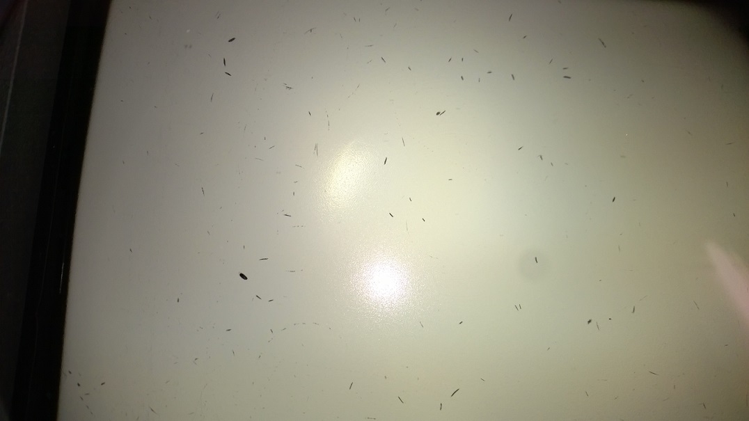

Just picked up this new red tube today, anyone seen this on a tube face before.?

Did you drain the glycol and confirm that it's a defect IN the tube glass? I'd drain the glycol and clean everything first. Those don't look like deflection or spot burns.

Never seen that,
kind of looks like something is loose inside the tubes, scratching the phosphor!!!!!!!!!!

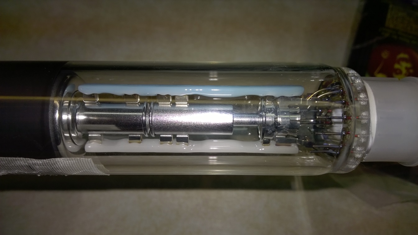

Its something loos inside the tube bell, i just removed the plast houses and magnets, so i guess its scratches on the phosphor. Crying or Very sad

the tube came from me. My guess is that either the tube imploded in transit, or something on the electron gun broke loose in transit and bounced off the phosphor. It didn't leave like that, I checked both tubes before shipping. Fortunately I have many red tubes here. Smile

Yes, I have seen that before.
It can happen in shipping if a ceramic cracks and bits of the ceramic or cathode come free from the gun. What do your ceramics look like?

Ceramics on the gun looks perfect, that was the first thing i looked, so guess something else in there came loos.

Ive seen that when they lose their vacuum.
