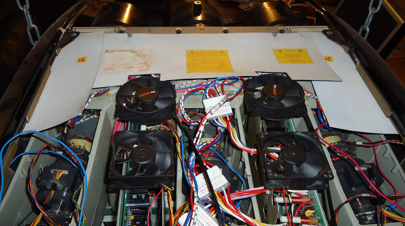

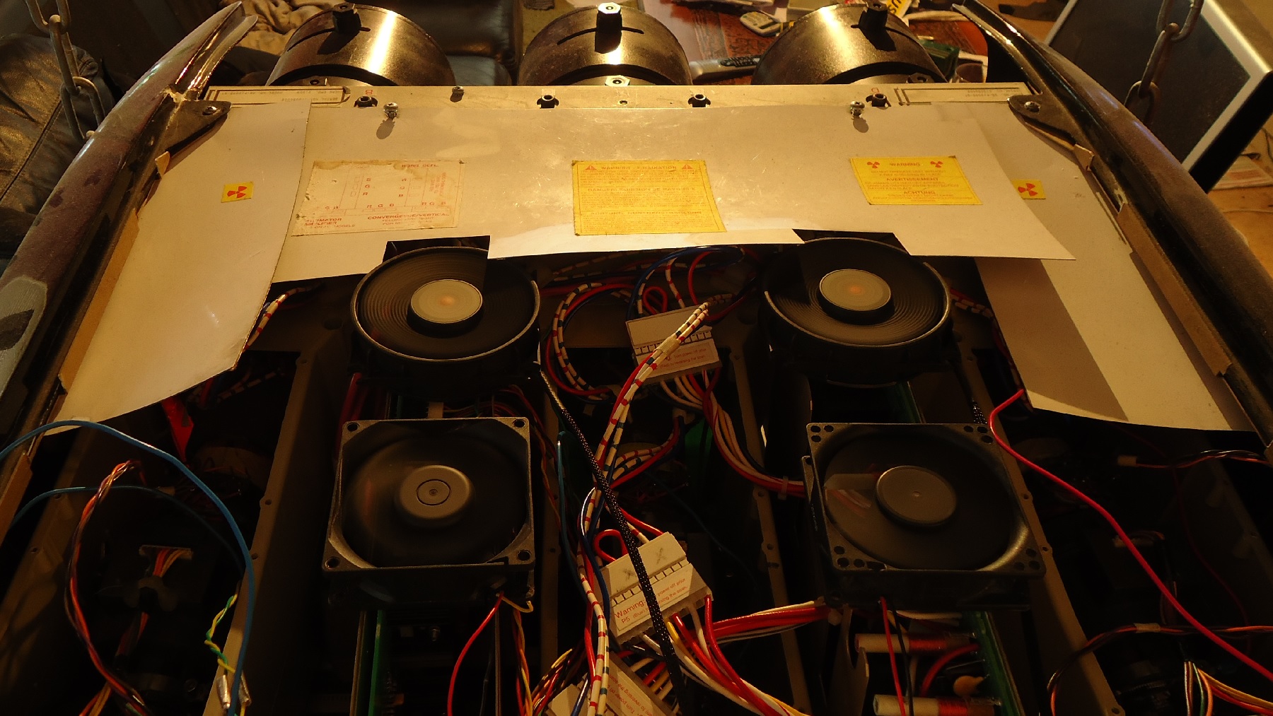

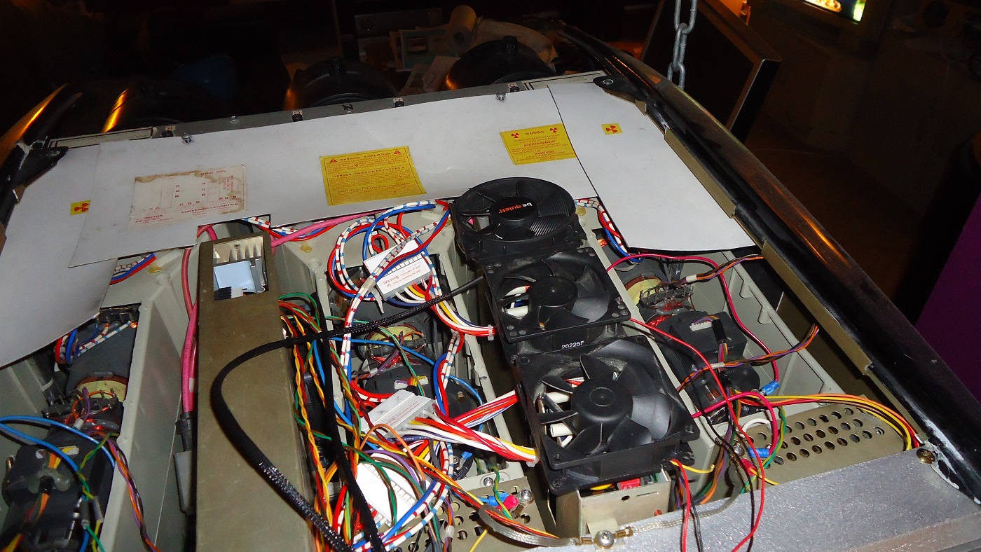

I've tested to put fans on top of the HDM+FGM today and it works very well, with no bending of grid pattern or anything like that, so I'm getting plenty more to cool even further than the 31 degrees it clocks in to now.
I was hoping for much less than the 31-33 degrees but 4 smaller 80 mm fans - or 3 lager 92 mm once - might get it to run cooler still. And considering how dead silent 80 mm once are there's no need for expensive brands like Be Quite there as one can't hear them at full blast anyway.
And holding the Pininfarina top cover in place with my hands there is still no sign of fans scratching the top cover so this solution works fine. And with easy there's also the possibility to raise it several mm if necessary and doing that wont make it look bad at all either.
The room temp. is 23 degrees, btw
And reading this alerts me that I need to get laid soon for this is pretty darn geeky I tell you! Very Happy

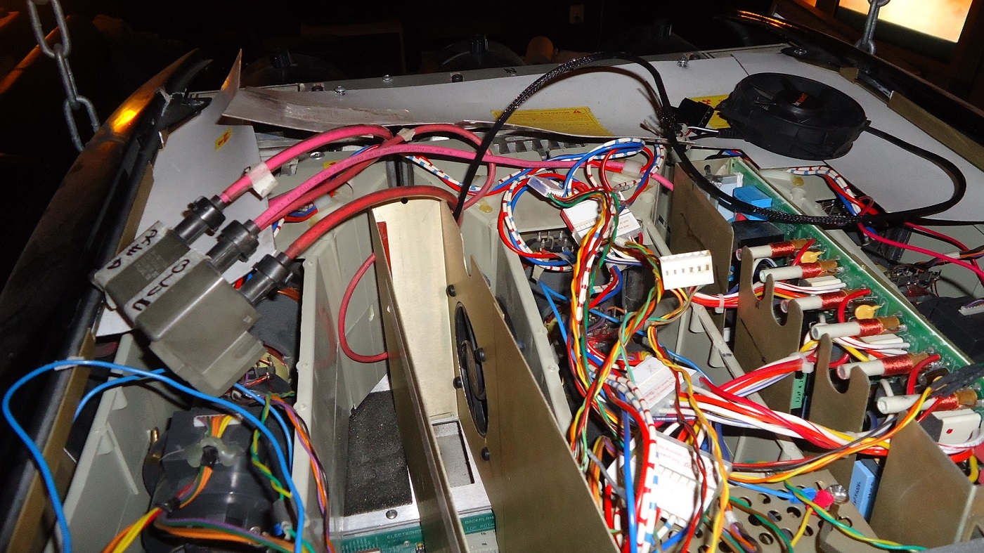

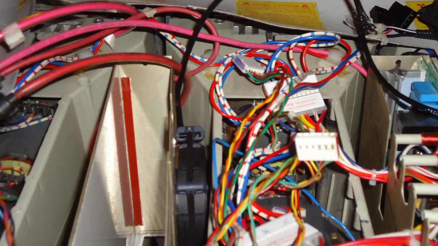

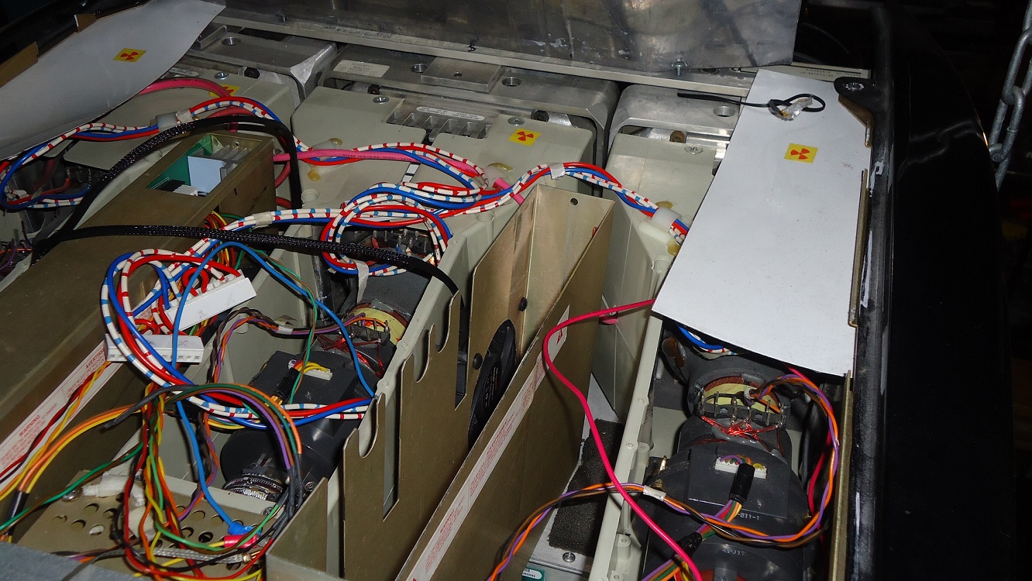

From word to action I made the vertical fan install and it works perfectly!
Strangely the HDM is still 33 degrees even with 3 fans on top which makes believe that its overkill with more than one fan as long as it seated in the front opening. The one HDM that I fried is also burnt in that area so that makes perfect sense so I will have a vertical fan there too, but that's for a rainy day.
No need to narrow the tube chamber as squeezing them down works just fine and will leave a small gap to suck air from. I use 25 mm fans, btw.
I will put the temp probe onto the FGM tomorrow if I can find a 3 pin connector to fit the Lamptron.
And I gotta be honest with you.. I'm a little aroused over this. And that can't be healthy.

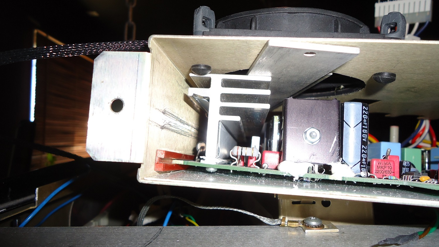

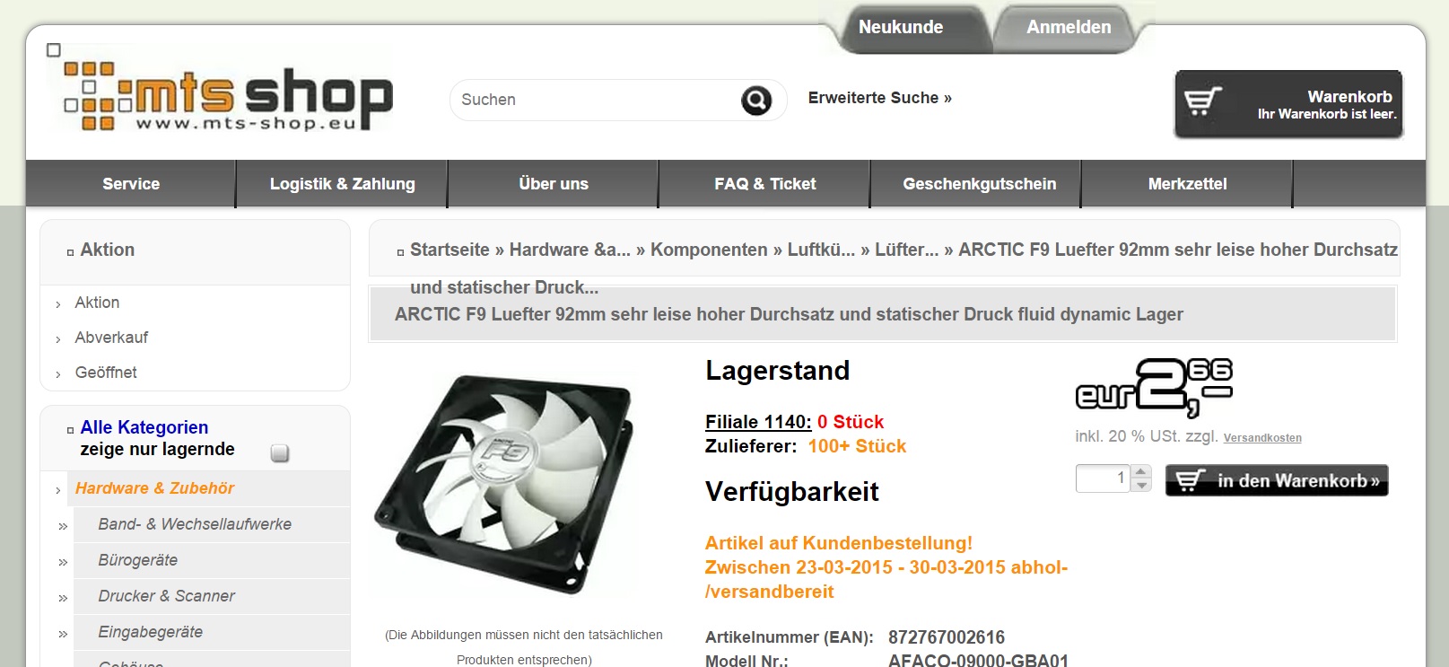

As for the fans, I don't think it matters to cool the boards having them so close so will get a whole bunch more for the rest. It's just that I have thing for sticking with the same brand, and the best there is, if I weren't I would go for Artic F9 or F12 as they are really cheap and with plenty of them + low speed they will do just as good. Personally, I'm sticking with Be Quite!, but with fewer and higher speed.
In a dream scenario, I would like to have 2x120 mm above each tube + 1x92 mm vertically for the FGM and HDM (half way there) and also 2x120 mm above the CLM + VIM card. The once above the tubes will rest on a foam cushion, and doing so they get to be raised all the way up to the HDM as seen on the photo. That should avoid any disturbance if there get to be any.
Do you have any plans for fan mod yourself? It's quite fun to hush the this puppy up. Smile

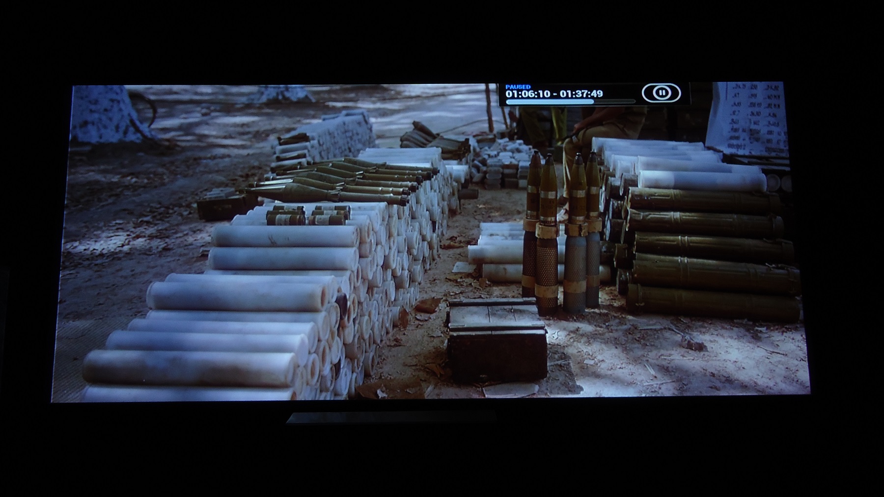

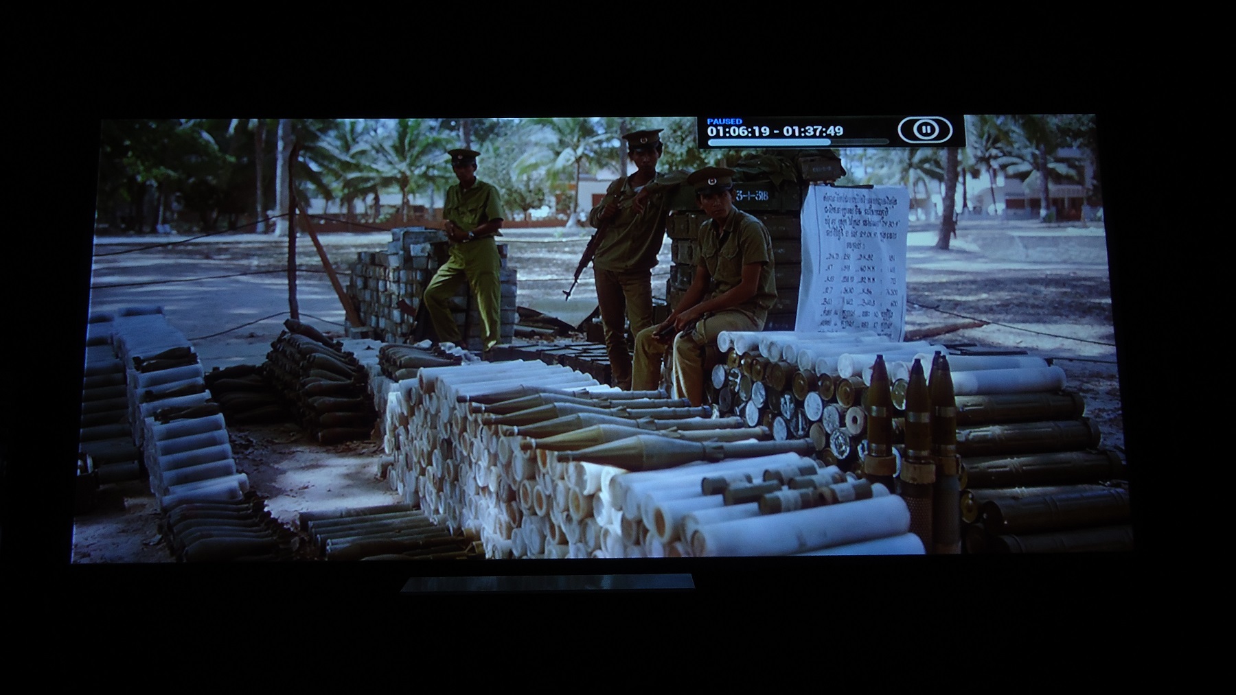

Posted: Sat Mar 14, 2015 6:30 pm    Post subject:

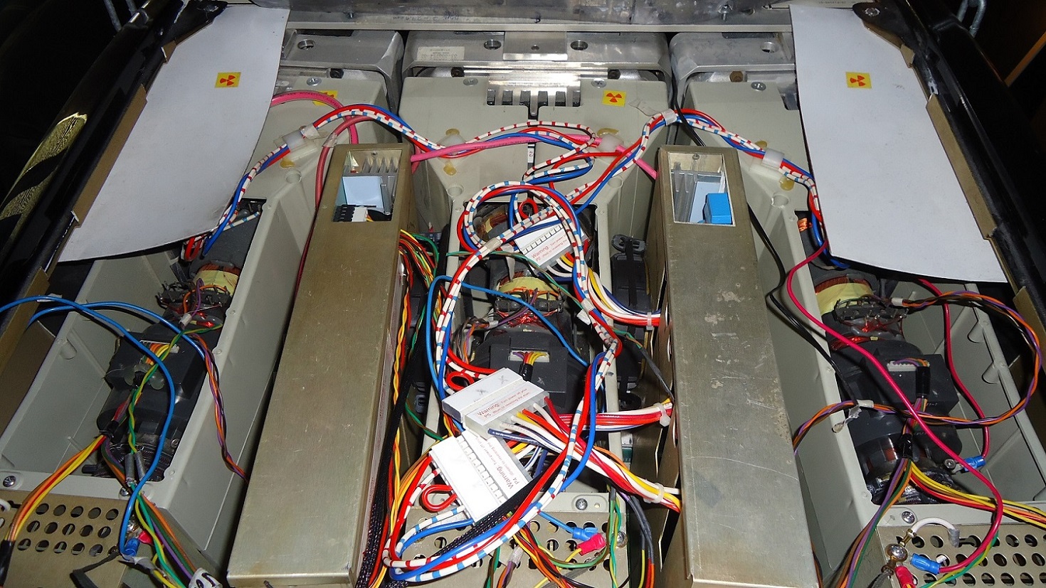

I finished the inserting the fan next to the HDM today, but unfortunately it's to close, as I get almost invisible horizontal lines from top to bottom, almost like scan lines, so that's a no go.
But several smaller fans on top seems to work, but I bet the lines are there then too so will probably go 2 larger once above the CLM and or CLM. To bad, I spent the whole afternoon doing this. But doing it this way with the FGM works, so not a complete waste of time.
