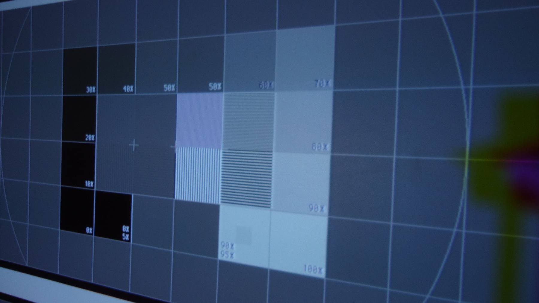

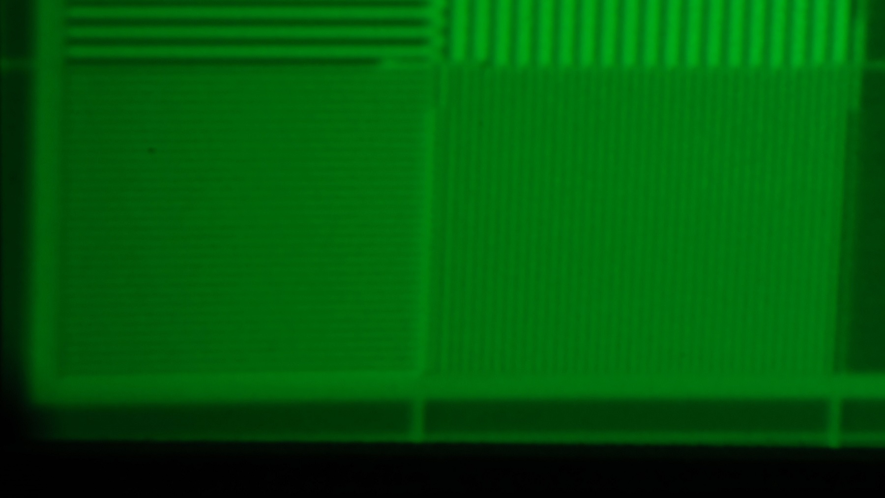

Posted: Fri Feb 13, 2015 6:46 am    Post subject:
The magnets needs quite a bit of work.
 Filesize:  172.44 KB
 Viewed:  7128 Time(s)
 Filesize:  374.42 KB
 Viewed:  7132 Time(s)
