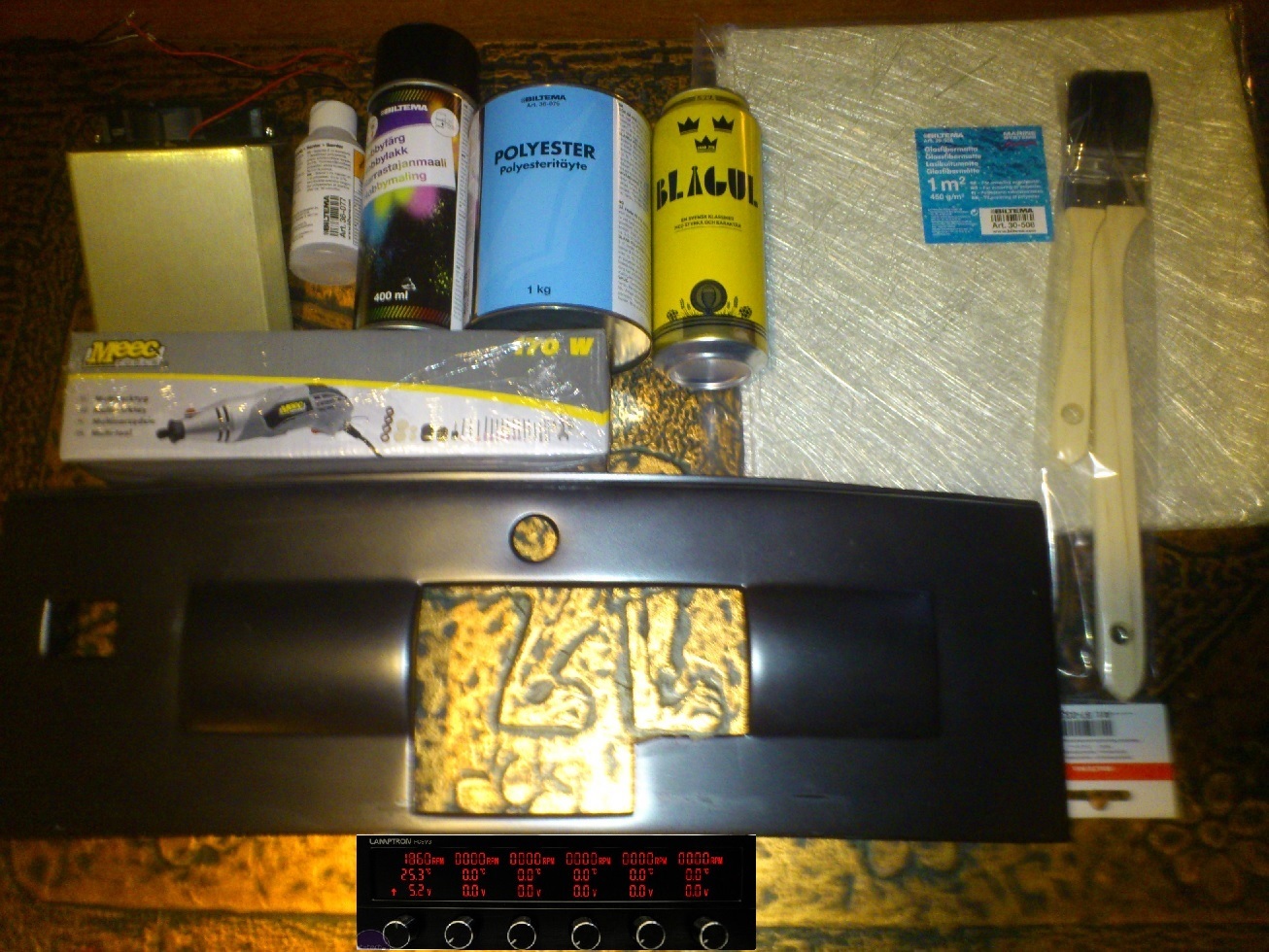

I finally have all the tools needed to do the necessary autopsy and modifications to the chassis. I plan on narrowing down the green plastic housing in order to fit the fans on the HDM + FGM.
At first I thought that thin fans, with little air pressure, was the way to do this, but doing it this way is so much better which lets you use normal thick fans. I'm expecting dual Silent Wings 2 120mm fans + Lamptron FC5 v3 from Germany to be here next week and couldn't be more excited.
What else... yes, I'm also closing the air-holes on the lower aluminium side-panels. I want to do this because more fans will be added later to blow air from the backside rather from underneath. That, or both, at a lower voltage around 10-10,5 volts.
The further off my ears gets from the air-turbulence I'm getting from the belly Cougars, the better off I am, because they really are noisy bastards I tell you. So the Cougars will definitely be moved from the belly to the VNB cage's instead and blow air towards the front.
Silent Wings 2 is the overall winner in all the threads I have read so far so that's why I getting more of them.
I bought a faux Dremel for 15$ today and wonder how they even are still alive ..
