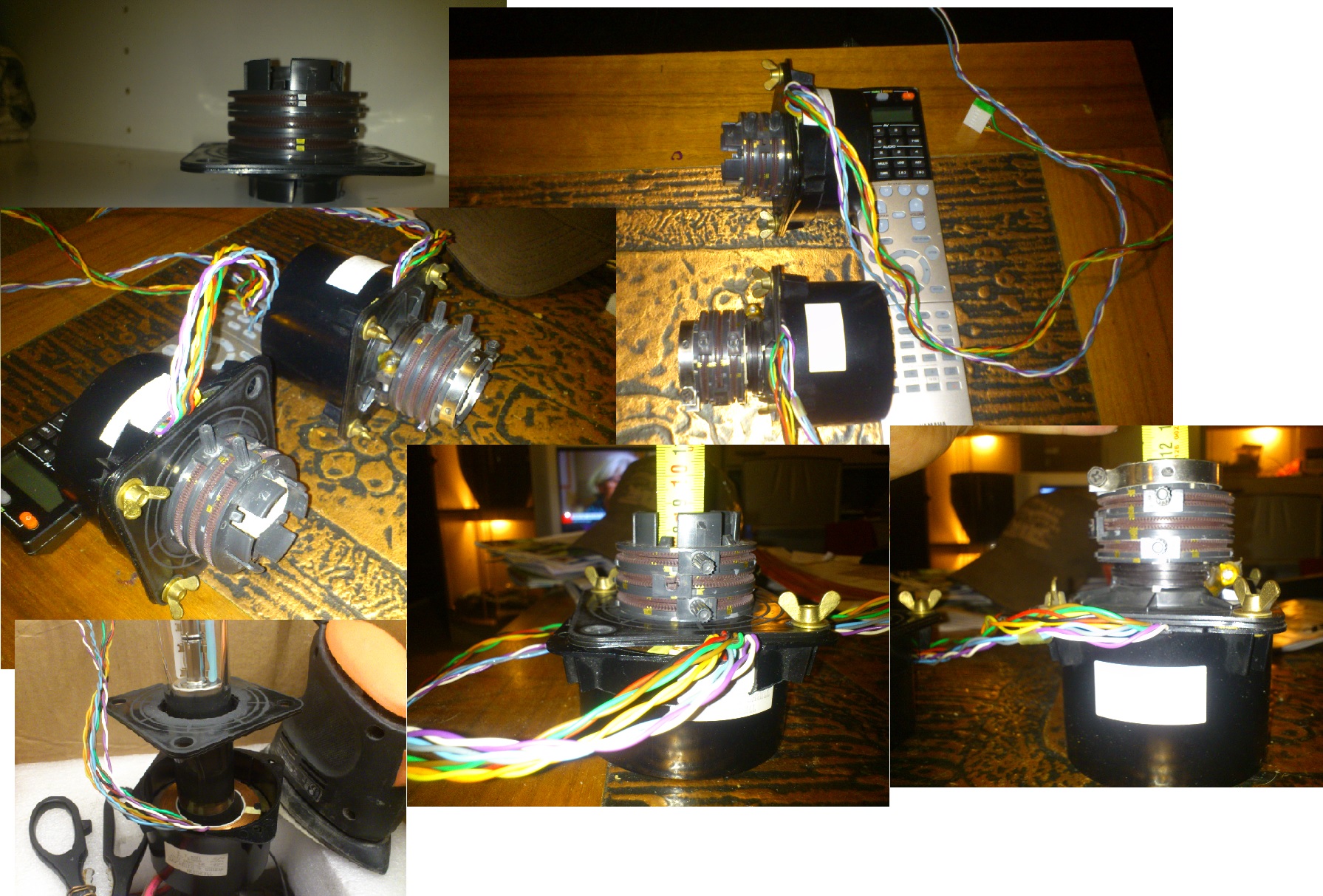

I'm tempted to cut off the clamps in the front on Frankenyokes and move them further forward. I think the image could get a little bit sharper doing that.
I have tested before, what happens when moving them backwards and forwards, and it's plain obvious they should be as far forward they can because the center upper and lower grid pattern lines gets thinner doing that. Right at the top and bottom they tighten up and almost positive they could get tighter still. Maybe just pipe-dream of mine..
I actually regretted putting the chassis back together last week because I wanted to have another look at them just now. But pretty certain there is room to move them forward by like >10 mm. Not much, but tempting all the same.
If I remember correctly, there's a clamp on the back but also some protruding plastic on the front that I want to remove. Doing that I would have to tape around the tube neck with fibreglass tape and then sort of snug the Franks back on again. There are other ways to but that one should be the easiest. But then again, why mess with something that already works.. Smile
Anyway, to easy my itch I made the smallest Thomson coils that I could make. Inc. magnets, I got them down from 11,5 cm to only 8,5 cm. With silicon I could make them even smaller by another 4mm. They are kinda cute now.
But.. the coil itself hasn't moved further forward it's just the housing that has shrunken. However, the magnet behind it has moved forward, very much so, and I wonder what that will do for the image. Maybe a test on an old tube some day.
Btw, the magnet would be glued/siliconed onto the coil plate that I flattened out.

redfox001
Joined: 16 Mar 2009
Posts: 2257
Posted: Wed Oct 29, 2014 11:08 pm    Post subject:
Nice! I have a set FY comming just to see for myself and they are not that expensive for an experiment. Further forward yes I read that too.

thewolfman
Joined: 28 Mar 2011
Posts: 1311
Posted: Wed Oct 29, 2014 11:38 pm    Post subject:
Mine are also 1292s that I bought from Canada, but before posting this, I looked at them again on the Interweb and some pictures seems to not have the protruding plastic at the front as I have (?) which in that case makes them useless to make smaller.
Unless of course they too have much hollow insides as the Thomson's.. if so, then there is much to be made there too. I never opened mine up.. mostly because there is silicon on them. But will definitely look into it more next time the chassis is off.
Posted: Thu Oct 30, 2014 1:14 am    Post subject:
Why did you cut them down? There is a reason they have that open space. It is so you can move the coil around in different directions to help center the raster mechanical on the tube face. This helps minimize how much electronic correction you need, therefore putting less strain on the electronics and reducing heat on the boards.
Posted: Thu Oct 30, 2014 1:21 am    Post subject:

thewolfman
Joined: 28 Mar 2011
Posts: 1311
Posted: Thu Oct 30, 2014 1:54 am    Post subject:
I know. But you can still do that except you loosen the wing nuts and pivot. The holes needs to widen though to fit all four sqrews instead of only 3. And the magnet clamp is what's holding it up now and a really strong glue or silicon. So it's still 2 parts and just a test to see what will happen. I'm not going to destroy my FY without testing on these first. That's the idea anyway.
