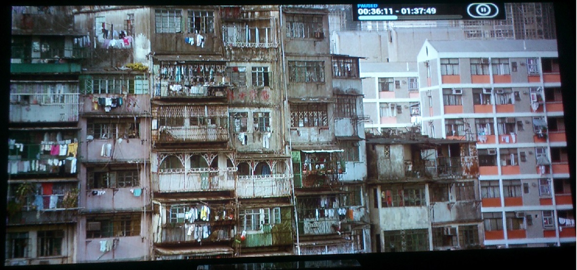

Posted: Wed Oct 15, 2014 10:25 am    Post subject:
Some poorly shot mobile screenies that went wrong one way or another. Be it soft edges or with the old stock VNB. Whatever happened I'll redo them at some point with new boards and a real camera.

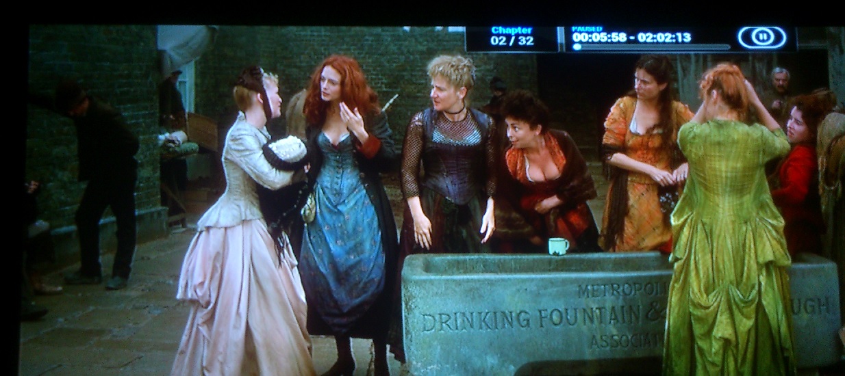

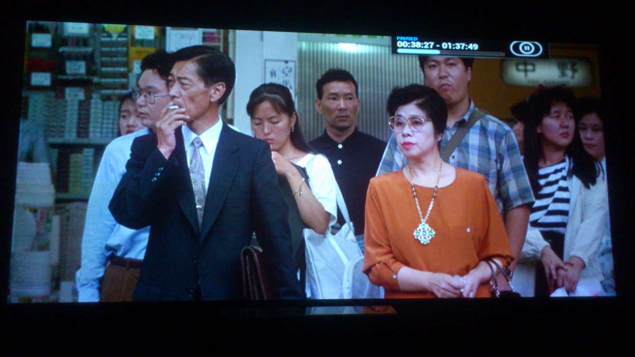

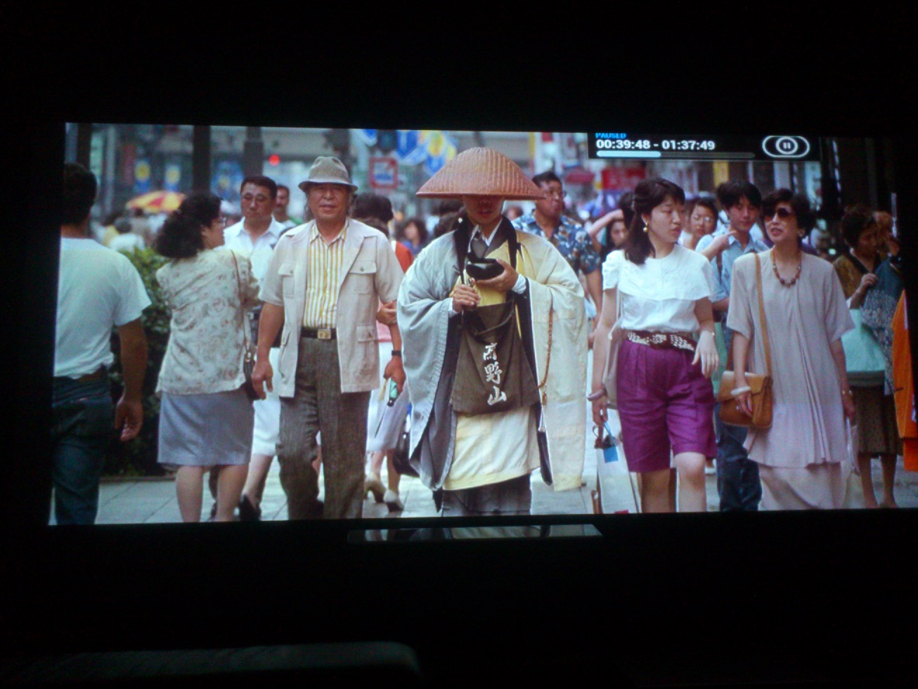

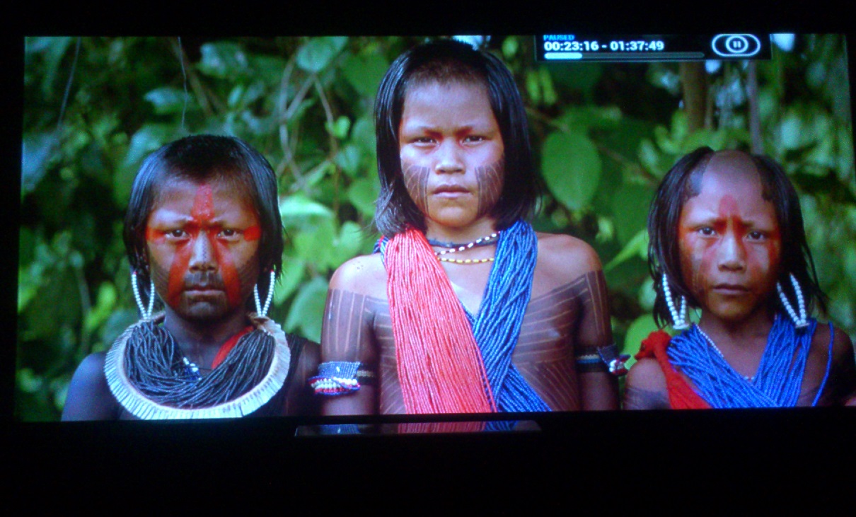

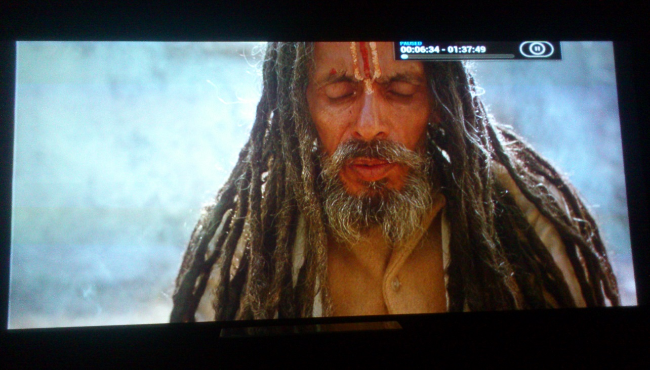

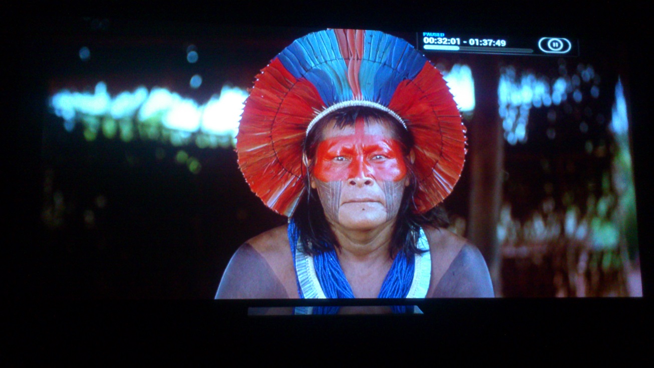

Posted: Fri Oct 17, 2014 1:49 pm    Post subject:
Took some photos last night, for reference, until I get a real camera instead of using this sh*tty mobile. But images is totally useless for patterns because finer lines gets lost completely, even while blue remains with the old neck board and the camera I'm using, I think it's worth posting to see how it turned out this far. I will take them again later to see if there is a visible difference whit a new camera and more new gear inside.
Blue is also very blurry at the moment and I just can't get rid of it. It's not suppose to be like that, but the last 8 inches or so is blurry to the point that text is unreadable, but hopefully it will go away with the MP cards coming, or with another complete initialization.
Red was never loosen so I used that tube to aim the others when putting it all back together, so I know it's not lensflap. However, I did defocus blue a little bit and that made the edge a tad better so not all bad. The lenses needs be bolted down to but still the best image I ever had.
So I'm pleasantly surprised how fresher boards could have such an impact on the image like I am seeing. And I'm glad I made the jump and bought this stuff from Curt and that he made such a sweet deal on it to. Thanks! Thumbs Up

Posted: Fri Oct 17, 2014 1:52 pm    Post subject:
I have 9 more in stock, hint hint! Mr. Green
Posted: Fri Oct 17, 2014 4:10 pm    Post subject:
Yes these 2008 boards are great. Probable the last fabricage with the old design. I advise everyone to try and get them.
Pictures look great. I know the camera adds noise so in reality it must be even better. The trick with a camera is to have one that can be set on shutter time 2 sec or so and on a tripod. Also if this is with a phone you must have a lot of light?

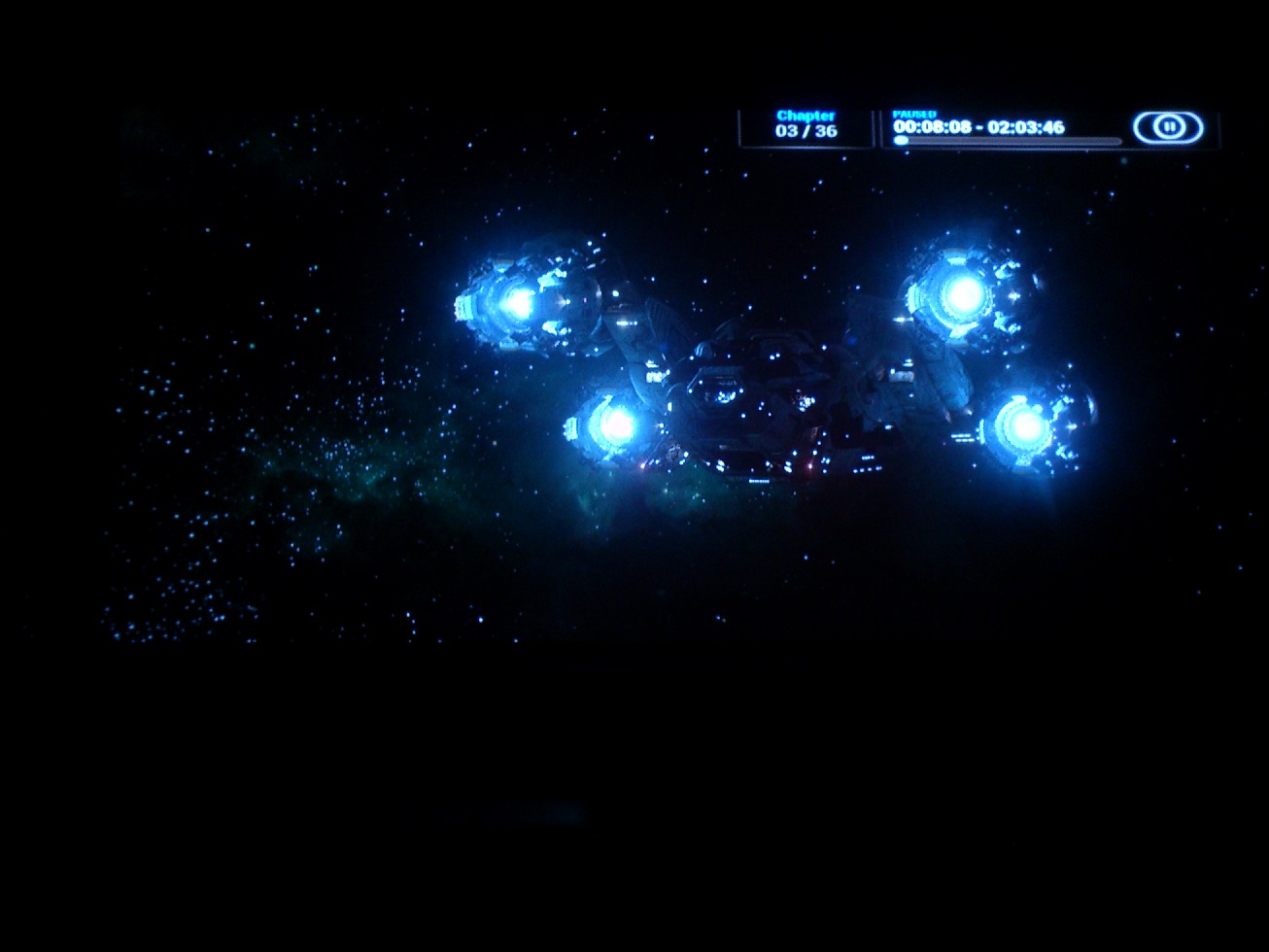

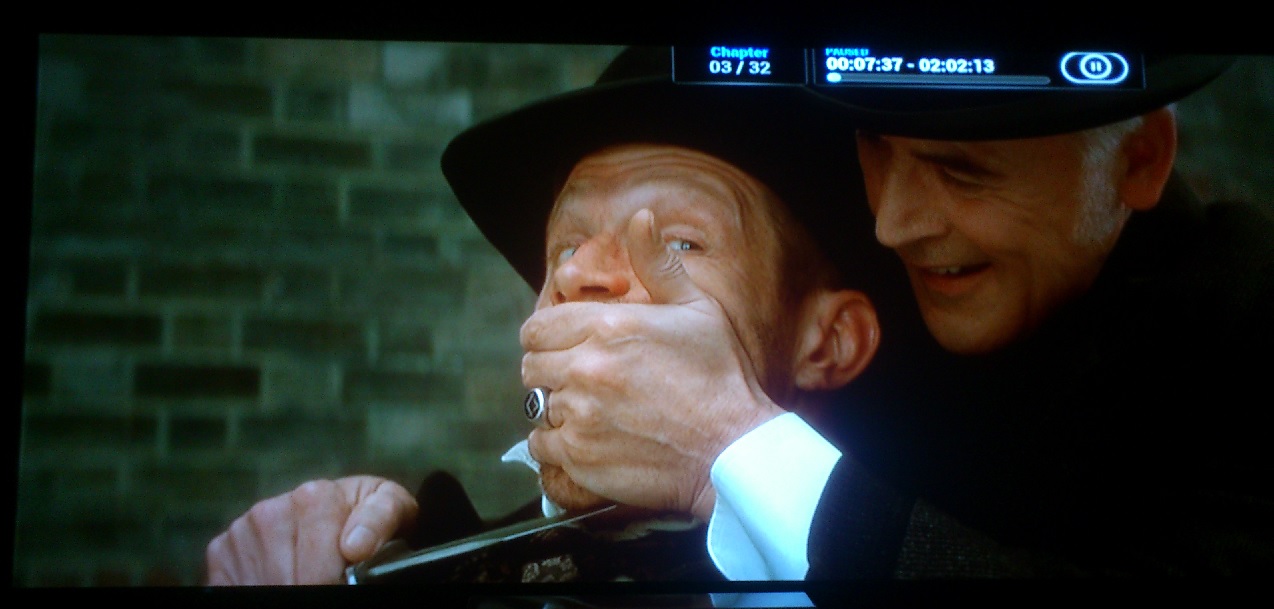

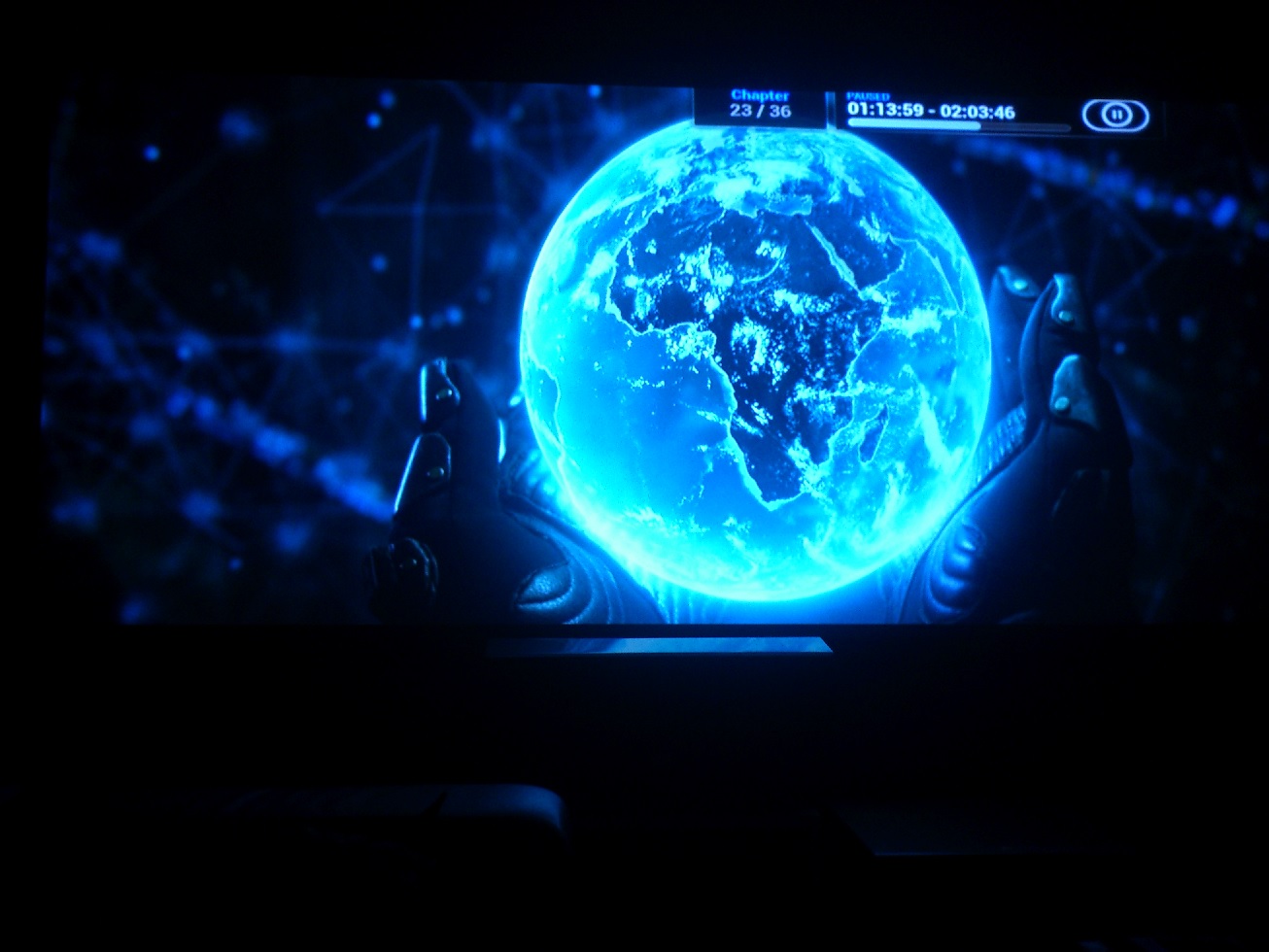

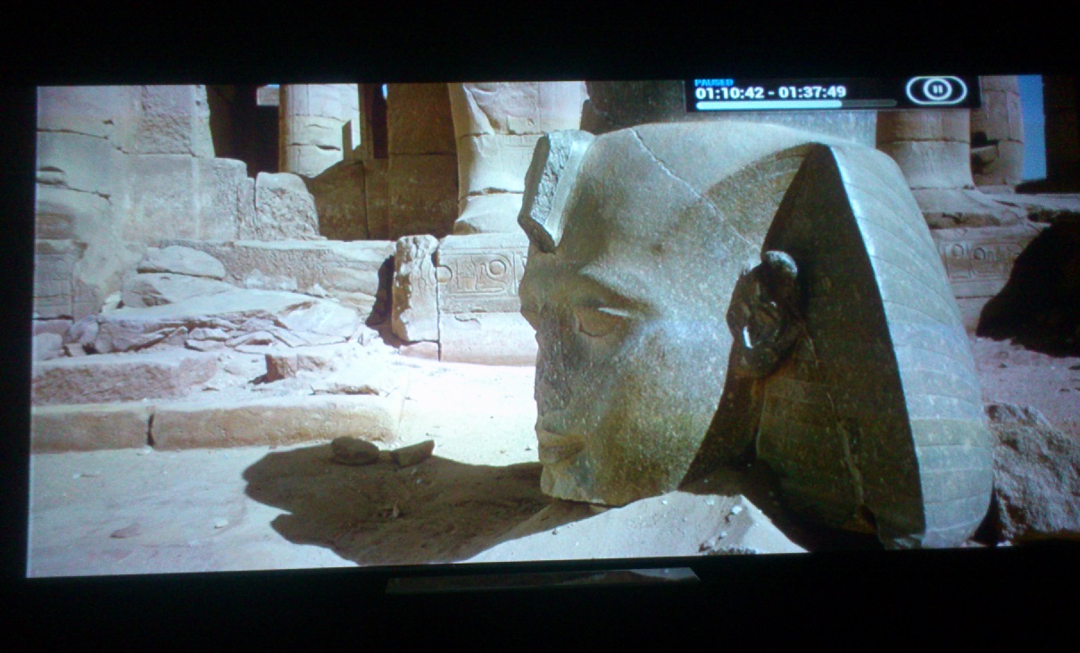

Posted: Sat Oct 18, 2014 2:23 am    Post subject:
Some night shots. New settings with Contrast @ 62 and brightness @ 14.. I had them a bit to high before. From Hell pix, the one with the knife, clearly tells the limitations of this camera because you can't see what the guys jacket is made of. It's actually Manchester.

Posted: Sat Oct 18, 2014 4:30 am    Post subject:
Wow! These pictures are a lot better. I am impressed. The Mike Parker boards shall improve the 1:1 but I wonder if they realy can improve a lot on these pictures. If they can we will be shocked Very Happy

Posted: Sat Oct 18, 2014 11:18 am    Post subject:
Thanks for saying that. Smile
Yes, Prometheus steered me of in the right direction as I saw how washed out space looked like and how bright I have gotten things lately. But It's better now. I used AVIA disc for this, but as always, I ended up doing some deviations form the settings they come up with..

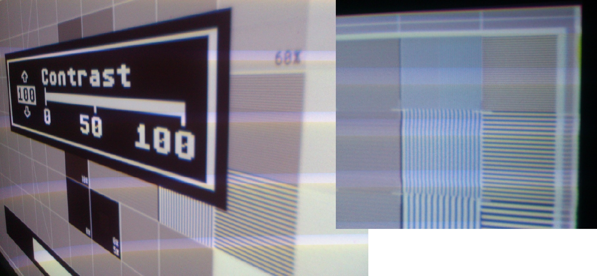

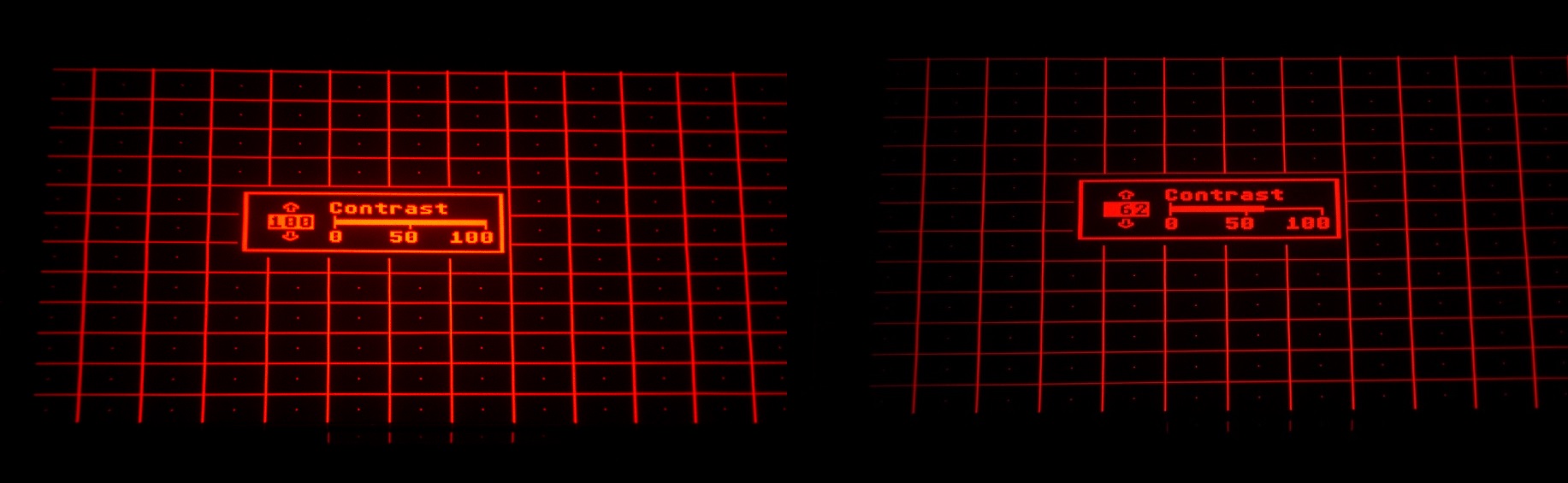

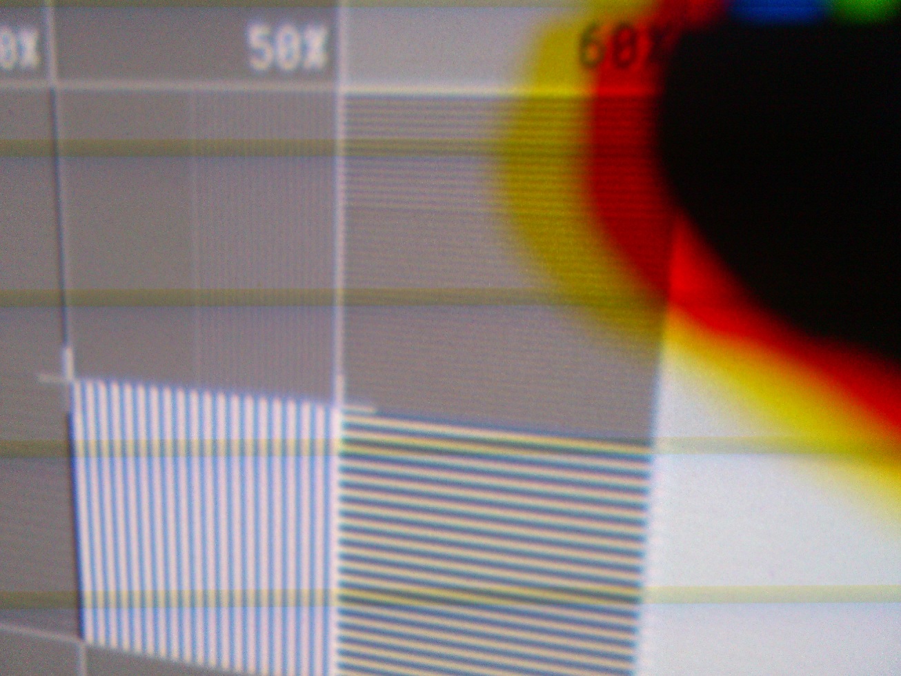

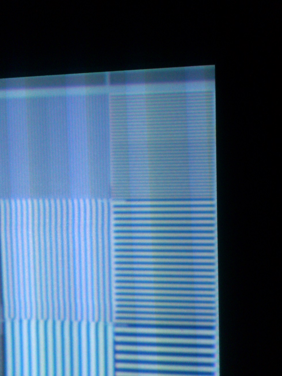

Posted: Sat Oct 18, 2014 12:35 pm    Post subject:
I actually tested to ramp contrast to 100 last night, intense yes, but the grid pattern holds tight. But I'll do it again tonight and see if the finer lines still remains on 1:1. That's all I can bring to the table as I know nothing about resolvability.. I just use it to see how my lensflap is set and what the sharpness looks like. But it will be fun learning more about 1:1 as time go by.
I took some images tonight, with contrast @ 62 and 100, where red came out on top of green and green over blue. It's a meaningless little test, I know, but at least there is one to look at now. But it occurred to me now that I'm getting a brand new red soon, with pre-set magnets and all, so that will be put to the test asap. I have almost motionless dots with ramping master-focus up and down so that should be a test on its own to.
Guys.....would Ultra boards do anything for me? My PJ is hanging from a low ceiling already and is middle screen level with the lenses.
@ Digitalayon. I guess those extra geometry features gets to be less and less useful the more the pj is levelled towards the screen.

Posted: Tue Oct 21, 2014 1:47 pm    Post subject:
He I don't get the testpictures. Mine have three blocks in the middle. What am I looking at I don' see it.
But your picture was somewhat sharper using lower contrast?
thewolfman
Joined: 28 Mar 2011
Posts: 1311
Posted: Tue Oct 21, 2014 2:18 pm    Post subject:
It was just to see how much blooming there is between the two. It's a test about Frankenyokes and if they ad anything at all. My new red tube will be with stock coils so I'm going to do the exact same thing with that and see how much blooming there is then. And also to see how much movement there is on dots with ramping focus up and down 0-100. But contrast at 100 is just for a few seconds and so had no time making a call on how the image looked like. Grid patterns show enough I think.
