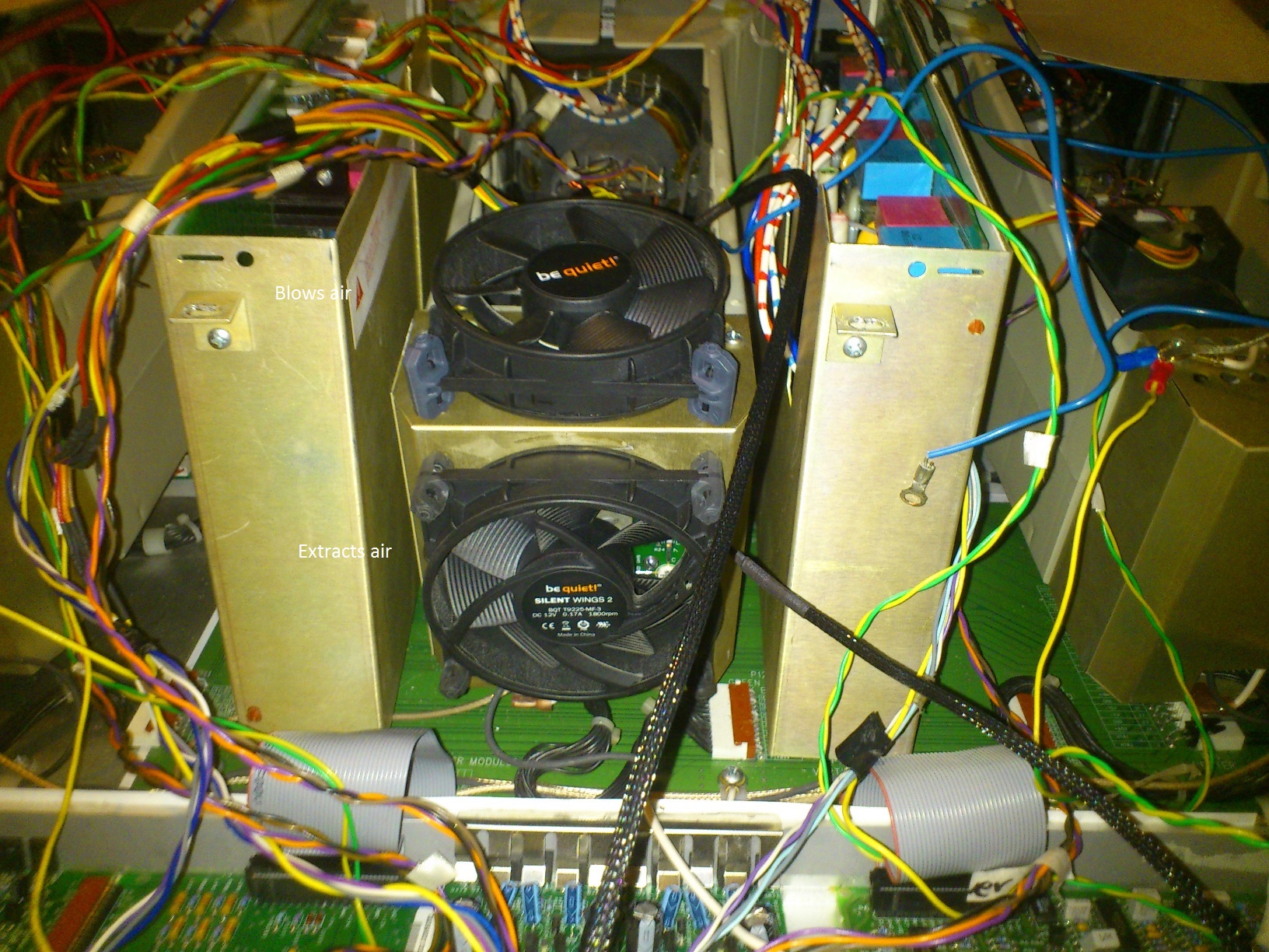

Posted: Tue Nov 25, 2014 4:29 pm    Post subject:
I have done one VNB with the fuax Dremel so far, and used the LVPS fans for those as the 120mm that arrived today had to low air pressure to motivate me putting them on. Very silent though, but to much work for so little air pressure.
The 92mm once fits perfectly and move plenty of air as well and not sure what to do with the once I bought. HDM as I planned or some other place. The Cougars gets to stay where they are though in the belly. But I'm going to take the edge off by a volt or so after more fans have been added.
The Lamptron lamptron fc5v3 is unbelievably cool to look at. Way cooler than seeing it on Youtube. But with use of Silent Wings 2 it wont be necessary to have it as they will always be run @ 12 Volts as they really are silent.
But for the Cougars it will become handy to have a fan controller like that. The blue, green and red colour really stands out and it's going to look very cool with it on and making it look a bit more modern. If I had some more parts here I could try and make it work again but for now it's just fans to work with.

Posted: Tue Nov 25, 2014 5:37 pm    Post subject:
You are indeed making the quietest CRT ever excluding a split pack!
I was wondering our neckboard come with little fans. they are loud? Where do these connectors of these little fans plug in?

Posted: Tue Nov 25, 2014 6:17 pm    Post subject:
Oh yes, one that I had made a scratching noise and I never even considered using them. But I think it's fun making these little tweaks as I'm not gifted with electronics like you guys are.
Oh..these fans are on the old external source but I tested it earlier today on the table with the Lamtron and the temp probes works like they should. Just plug and play. And seeing it glow like that is very nice and the temp numbers changing like that.
I really hope I will have it finished by January because the new Moome card sets me off again so I can't afford getting all the things I want sooner.
Any luck with your pj? Finished with your bellows and such?
Posted: Tue Nov 25, 2014 6:43 pm    Post subject:
What is the purpose of all these fans.?
It looks like your trying to cool the neckboards from the board side..?
I can run 200Mhz or higher on my neckboards, so can Justin, and they are almost cold. With the standard belly fans.

Posted: Tue Nov 25, 2014 6:50 pm    Post subject:
Like I said before.. I had another go at fixing my last blurry bit on the left and swapped to 4 pole magnets from six and noticed that one of the VNB had a droopy hot glue on it.. it really looked like it had melted from heat. Maybe from when I had it running at only 9 volts from time to time before. So I'm getting these fans to be safe.. if it gets to interfere with the image I'll just remove them as I have many more cages laying around.

Posted: Tue Nov 25, 2014 6:53 pm    Post subject:

Posted: Tue Nov 25, 2014 6:57 pm    Post subject:
Oh I forgot.. I'm cooling it backwards from the heatsink and forward.. meaning I'm also getting fans for the heatsink itself but from the inside rather than cooling it from the backside like Barclay.
Posted: Tue Nov 25, 2014 6:59 pm    Post subject:
thewolfman wrote:
Like I said before.. I had another go at fixing my last blurry bit on the left and swapped to 4 pole magnets from six and noticed that one of the VNB had a droopy hot glue ito it.. it really looked like it had melted from heat. Maybe from when I had it running at only 9 volts from time to time before. So I'm getting these fans to be safe.. if it gets to interfere with the image I'll just remove them as I have many more cages laying around.
Take that rear cover off, and put the lid on the plast covers.
And the glue on your pic is as it should be.
Looks like you want to invert the air flow around the neckboards, it dont make much sense to me, and i wonder if you make them run hotter that way.

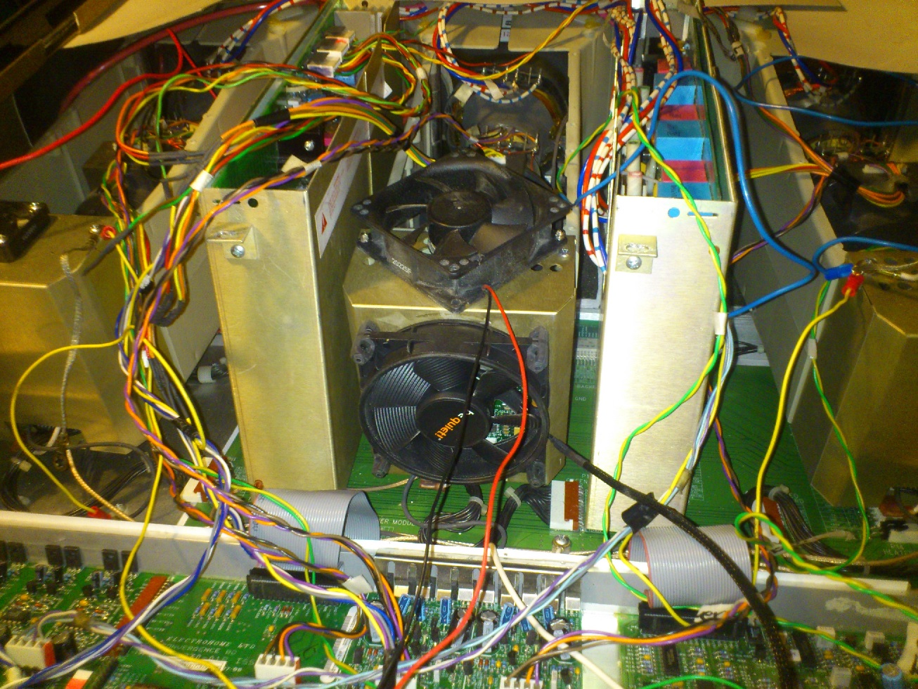

Posted: Wed Nov 26, 2014 9:57 pm    Post subject:

I went back to my old thinking with cooling the heatsink from the inside and cooling the VNB from above with a 92mm fan at the same time.

Posted: Wed Nov 26, 2014 10:10 pm    Post subject:
I still dont get it..
Whats the temperature on the neckboards running standard setup.? And how do you effect the air flow for the FGM and HDM when changing the flow around the tube/ neckboards.
I would think that a few hours of operation has proven that the original design works quite well, or what problems did you discover.?
Also keep in mind that direct cooling on components can create a unwanted DC behavior.

Posted: Wed Nov 26, 2014 10:33 pm    Post subject:
Q. 1.. Don't know the original temp.
Q. 2.. That was because I wanted to cut out a hole on the FGM+HDM to have a Silent Wing 2 to fit in there. But Choosing them needs me to narrowing down the green plastic housing.. it wont fit otherwise. But, Noctua NF-A9x14 will, and without doing anything to the green plastic housing. Of course, it comes with a bill with lesser air pressure.
Q. 3.. I have only discovered melted hot glue at 9 volts on the VNB. Feel free to believe what you want but that was my instinct seeing it. I may have removed the evidence by taking off the droopy glue, or it still there on either red and or blue.
Posted: Wed Nov 26, 2014 10:57 pm    Post subject:
thewolfman wrote:
As nash wrote, its hotmelt, it has to be there to hold the G2 wire. No need to worry, and if the board runs hot its not where the hotmelt is.
So what you say is that you are trying to cool the FGM and HDM horizontal, and not keep the original vertical air flow.?
And how will your tube/ chamber cooling look like.?
Are you going to put 11 fans to replace the 3 belly fans.?
My thinking here is that you have some sort of fan fetish, no problem in that, ill just ask a few critical questions, so that others dont run along in a hurry.

Posted: Wed Nov 26, 2014 11:26 pm    Post subject:
stridsvognen wrote:
thewolfman wrote:
FGM + HDM vertically on them. Green housing gets in the way though so need to Dremel a bit, but I believe Noctua NF9X14PWM 92 x 14mm fans would fit in there without any modification at all.
The tube-chamber can only by narrowed by maybe 5 mm on each side before parts inside will get in the way but could be done in a number of ways so I don't need to explain.
I'm keeping the belly fans after all but lowering the voltage will make them a bit quieter.
2 92mm fans the LVPS. 1 on the for HVPS. 3 belly fans. 6 for the VNB inc heat sink. 1 for HDM + 1 for FGM. Fetish maybe, but I get to lower the voltage significantly to perhaps 10 volts even making it more silent and yet cooler at the same time. That's my goal. It's not a mayor investment as they can be had for less than 20$ each on some places.
I suppose the air flow direction will be the same only they get an extra boost.
Oh and I appropriate you mentioning that unwanted DC behaviour could happen and I really hope I wont break anything with this approach. I guess we'll have to wait and see what happens. And if it gets to darn cold I could remove some and put in the PC also.

Ok if I understand you well you say you make the normal fans in the belly turn slower but compensate by putting suckers on the Horizontal and Focus modules. Also you blow and suck extra air through the neckboards.
I think the neckboards are overdone. The other idea might be something to try if I want the Marquee to be more silent. To be honest did you think of this yourself because if it works it might be something we should have thaught of long ago Very Happy
