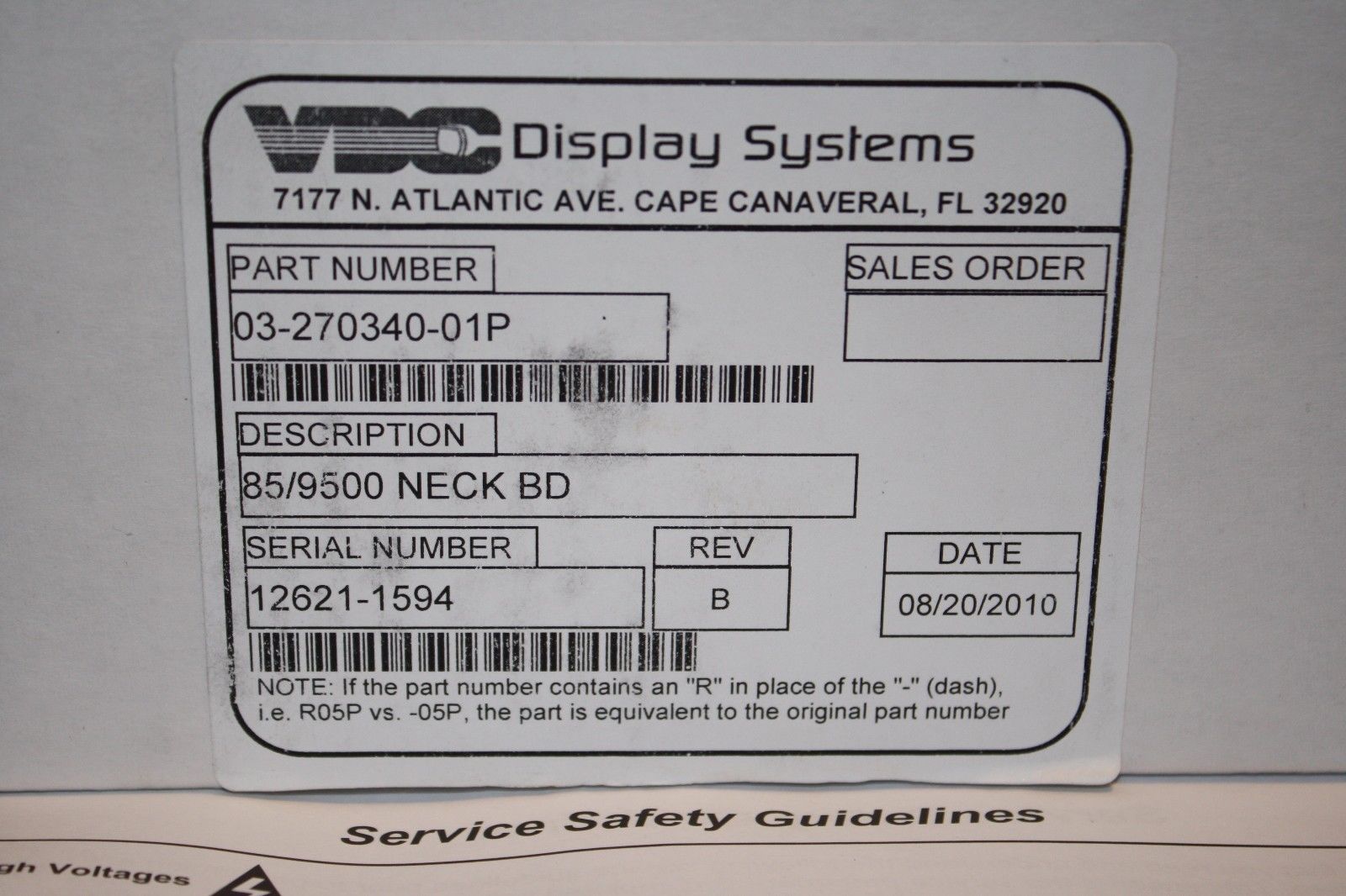

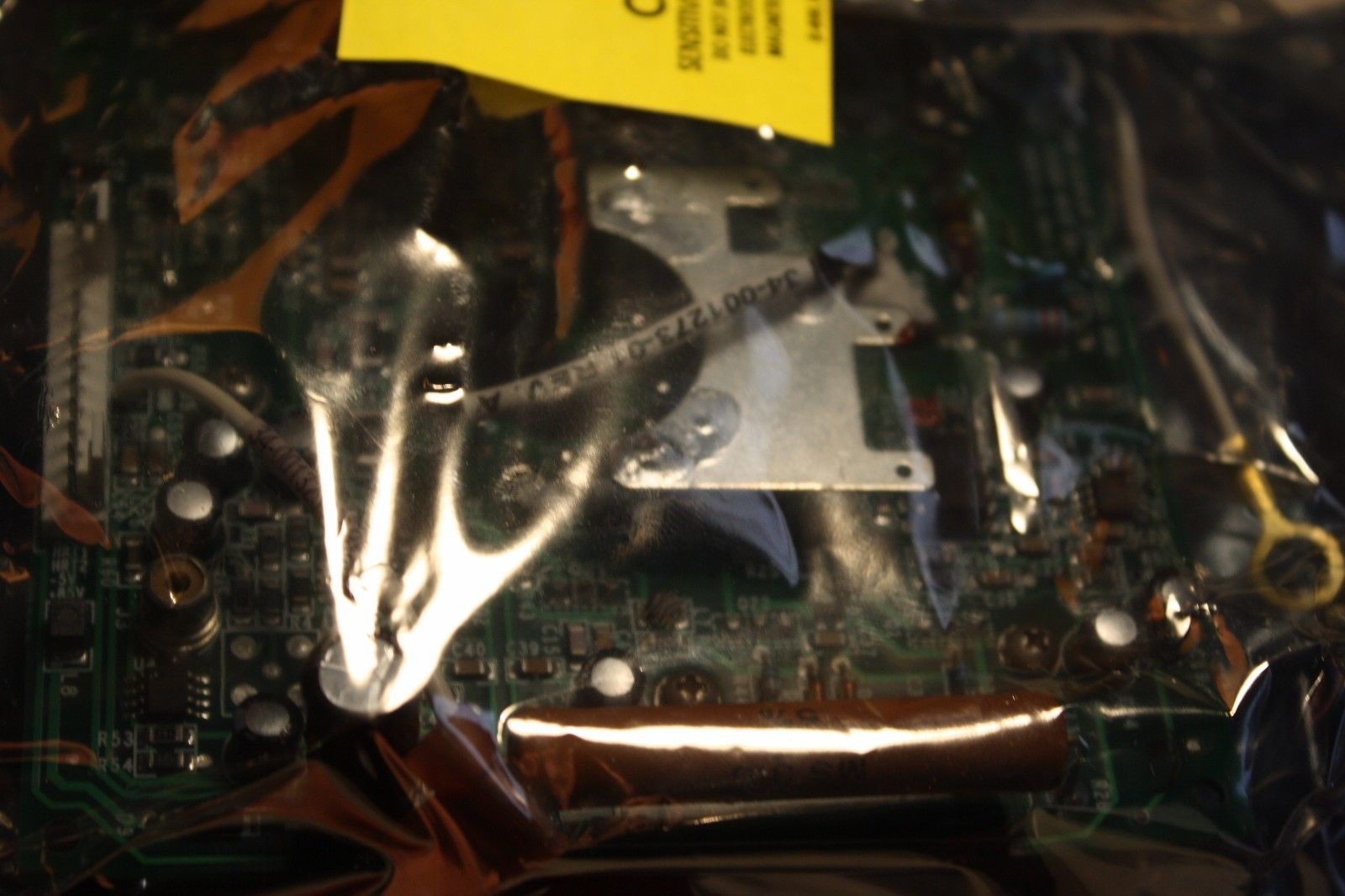

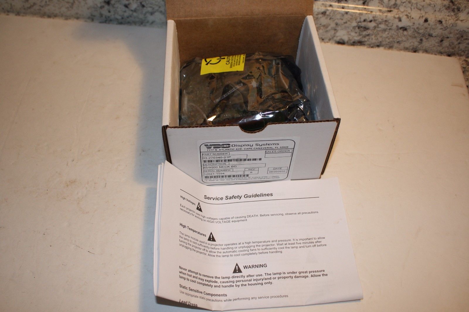

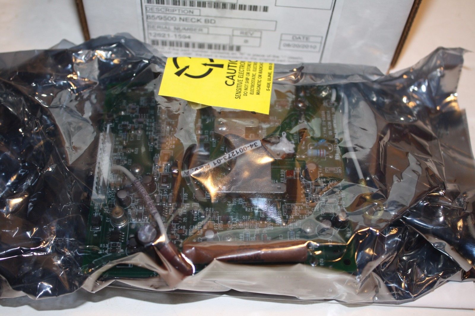

I know, this thread has been dead for a year now.
But I will be offering some of these new VDC neck cards for sale in about a week.
They are part number VDC 03-270340-01P and they are the variety that can be mixed and matched with "legacy" neck cards.
VDC's price on these cards is 740 dollars each.
I have a "quantity" of these cards available. Several sets. Since I have not yet decided how many I want to keep for my
own uses, let's just say for now that they're avaiable unless I say otherwise.
Pricing...I have no clue what to ask for them because nobody's ever sold them here before, as far as I can tell.
So you tell me. Would you pay 150 per card for them? That's about what a good and desirable lens is worth, so I figure that's probably a fair starting point.
