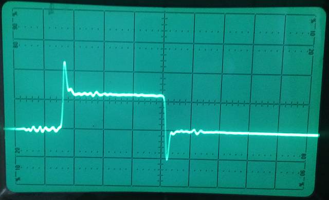

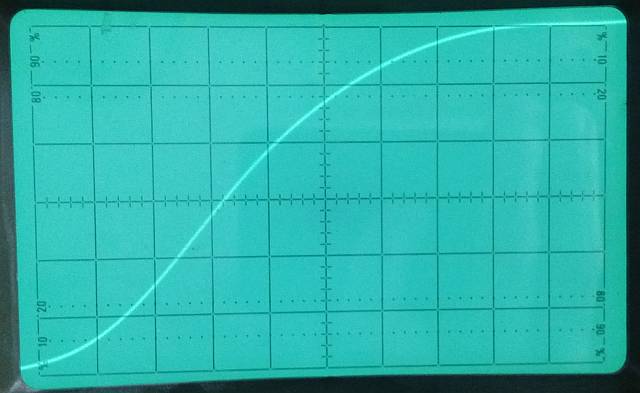

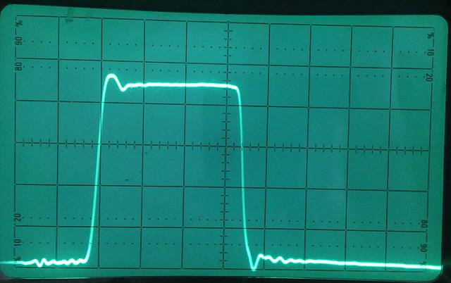

Posted: Tue Nov 01, 2016 4:43 pm    Post subject:
I am now playing with a set of these new VDC neckboards too. It is interesting... In its stock form the output waveform is quite under compensated. The oscilloscope measurements are not very promising either, there seems to be an odd assymetry in the output signal between G1 and Cathode drive level (G1 can go beyond 40Vpp, the Cathode drive barely reaches 30Vpp). Furthermore the fastest rise time at the output is around 7ns (~50MHz real bandwidt) and is more or less independent of drive level (ie. this does not get better at lower levels either). For proper comparison, an old style Marquee neckboard has a rise time around 3.5ns at similar conditions, while my old M9000 neckboard has around 4ns rise time. a VPA13 (130MHz advertised bandwidth) also has around 3.5ns rise time.
I've went a little deeper in analyzing this circuit.
Despite the output seems to be under compensated the opamp input stage generates an enormous ammount of overshoot to the input signal, with the intention to cancel out the lower speed of the output, with little success...
It is widely spread theory that these VDC neckboards could not perform as good as the old VNB-s because the Motorola transistors were far superior (1.4GHz vs. 500MHz) than the Sanyo transistor those are used on the VDC boards. While this might be true this is not the main reason as I see.
For example I changed Q21 and Q17 transitors to BFQ262, and BFQ252 those are comparable to the original Motorola transistors (~1.4GHz) but has the same package and pinout as the Sanyo transistors, so changing these transistors did not bring any significant bandwidth improvement. I also changed Q19 to BFG135 (which is a 7GHz transistor), this also did not yeld anything worth noting.
-On the other hand tuning the coils L1 and L3 to 470uH brought a big improvement in the response even with the original transistors, so the rise time values got down to 5.2ns (with the input overshoot). But so far I could not find any way to go below 5ns rise time, so this seems to be some sort of performance barrier.
-With the tuned coils, but the bypassed input oversoot the rise time is again around 8ns.
-With the tuned coils and bypassed input oversoot, but increased C6 (->200pF, emitter peaking cap) the rise time is around 6ns.
-Combining all the available peaking will increase overshoot and ringing to an unfavourable level, without getting the rise time below the already mentioned 5.2ns barrier.
There is one other odd thing, the diodes on the output D11 and D12. I'm not exactly familiar with their purpose I did not see similar on any other neckboards, probably they help in arc protection. The diodes are seemingly reverse biased, especially D12.The boards I have here have an added resistor that is connecting D12's anode to the +85V supply giving some sort of forward biasing to it, regardless the mentioned assymetry in the output signal is exactly caused by D12, replacing this diode with a short the symmetry on the output restores. But it may have adverse effect on the board's reliability, I tested only on benc so far without that diode.
Rise time on G1 output, 1ns/div horizontal.
 Filesize:  26.74 KB

G1 output on the VDC VNB, 10V/div vertical 20ns/div horizontal. After coil modifications, BFQ252/262 transistors, and input overshoot left intact.
 Filesize:  26.97 KB

Output of the HFA1100 on the VDC neckboard
 Filesize:  25.87 KB
 Viewed:  9371 Time(s)
