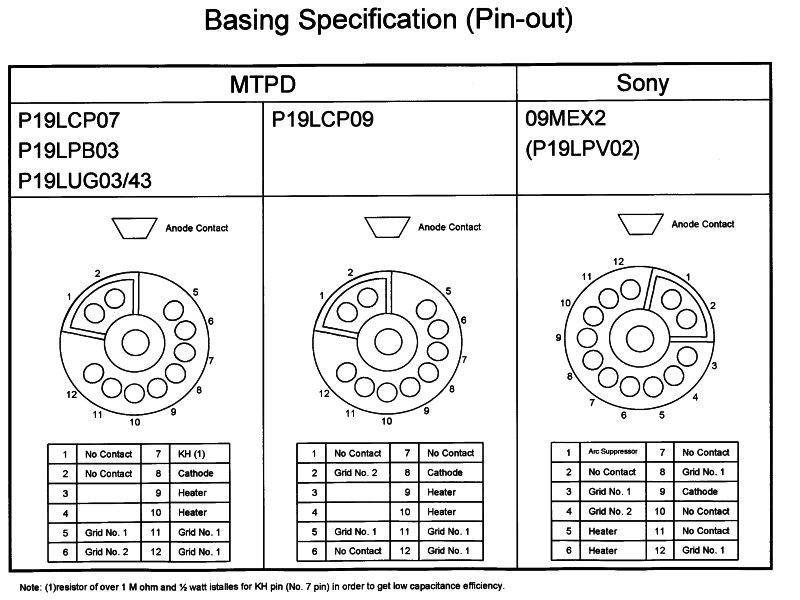

Check the attached picture for identifying the pin assignment.
Yes, indeed it has the HFA1100, according to Tse, that IC was good enough in this application. Actually you don't need a 9" tube for testing the bandwidth nor fancy signal source. The patterns are available even on this forum, a PC's VGA output is faster than the most external DVI/HDMI converters, put up 1600x1200-75 or 85Hs on a 8" tube and that will eat the bandwidth, still would be sharp.
The problem with the new boards is that they need a matching VIM, because the SPOT KILLmechanism on the new VNB is not compatible with the old one, sooo carefully play with them...

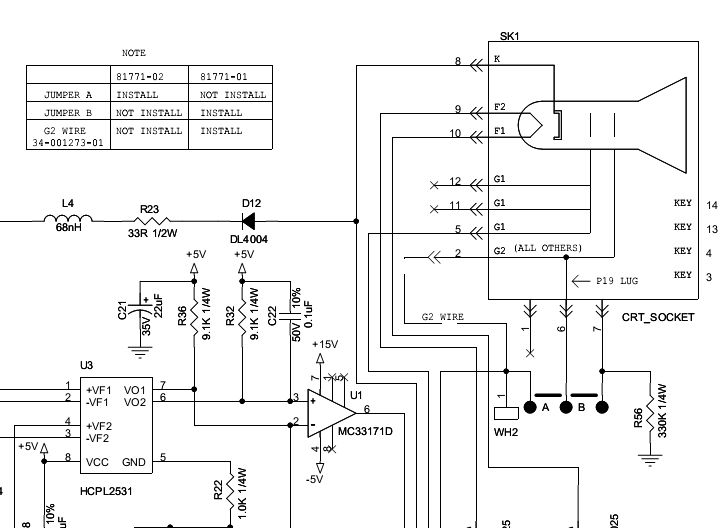

Posted: Sun Sep 28, 2014 7:05 pm    Post subject:
Gabor, that is the schematic for the version that is not compatible with other VNB's I believe. There is another schematic for the version that is compatible.
Posted: Sun Sep 28, 2014 7:31 pm    Post subject:
Yes, I have that too. But if you look carefully at the first picture what Dragan posted, the sticker on the heatsink says '81771-02' so that is the matching schematic for that board.

Ok mine is 81771-01 but my jumper is at location A i believe and it should not then have a G2 wire off the board, but it does? I have been e-mailing Scott lets see what he says.

Posted: Mon Sep 29, 2014 3:23 pm    Post subject:
Drags that wire yours has is not a G2 wire. it most likely is an Arc suppressor connection to one of the internal grids. I had to add one for the thomas tubes. For the LUGs no wire is needed, the jumper goes to pin 6. I need to have some time to trace it all with my DMM.
Kurt the VIM was the same. You do not need a different vim just all the same neck boards. no mixing them together from what Scott told me..
Posted: Mon Sep 29, 2014 4:23 pm    Post subject:
I actually used one of Scotts photo's, on the ones here there is no jumper wire and I don't know where it was at time of dis-assembly.
Just talked to the guy who bought these, the black wire in the ( borrowed) pic I posted is still attached to the tubes in his machine and it's going to both pins 1 and 2, so it's just ground for LUG's.

Here is his exact words to me about the compatibility
TSE wrote:
Hi Nashou,
The boards can be used for tubes with G2 on pin 2 or pin 6. So for P19LCP09 you would put the jumper in the "B" position and install the G2 wire with the pin socket that you connect to pin 2 like the standard Marquee. If you have P19LUG tubes you would install jumper "A". You don't need the G2 wire for this tube.
The new boards are compatible with the VIM boards. The limitation is you cannot use the original neck cards with the new neck cards. If you want to use new neck cards you have to use three of them. If one or two original neck cards are installed the spotkill will not work on the new neck cards. Dangerous! The spotkill works fine with three new neck cards installed.
The remote control Brightness setting will have to be set a little different with the new cards as compared to the old ones and the internal test patterns won't be right.
But as I said it looks like on my VNB I have Jumper A and the G2 wire for pin 2. Hmmmmm?
Posted: Mon Sep 29, 2014 9:29 pm    Post subject:
Ok, Duh !!!! The LUG has G2 at pin 6 and the LCP has no connection at Pin 6 so this VNB can work with both even if you have the wire Like I do. If i cap off the wire I can use this on a LUG( covering the end of the G2 wire so there is no G2 arc) or connect the G2 wire to pin 2 on and LCP and not worry about the Jumper on "A" (pin 6) since there is no connection there on an LCP.
