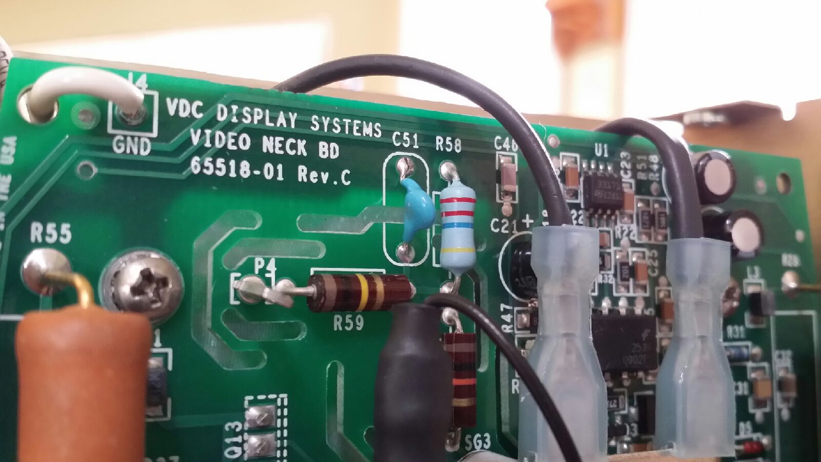

Guys, not to be a pain, but I've read my way through this thread and I'm still not very clear on how these new neck boards need to be set up for LUG vs. LCP. My boards are the same as those pictured by Nash.
Mine currently has LUG's installed from the factory. I have not pulled the neck boards off the tubes yet to check the jumper setting, but I do see the black wire that connects to BOTH open pins on the tube itself. There are two connections on the tube end of the black wire, one that slides over each pin.

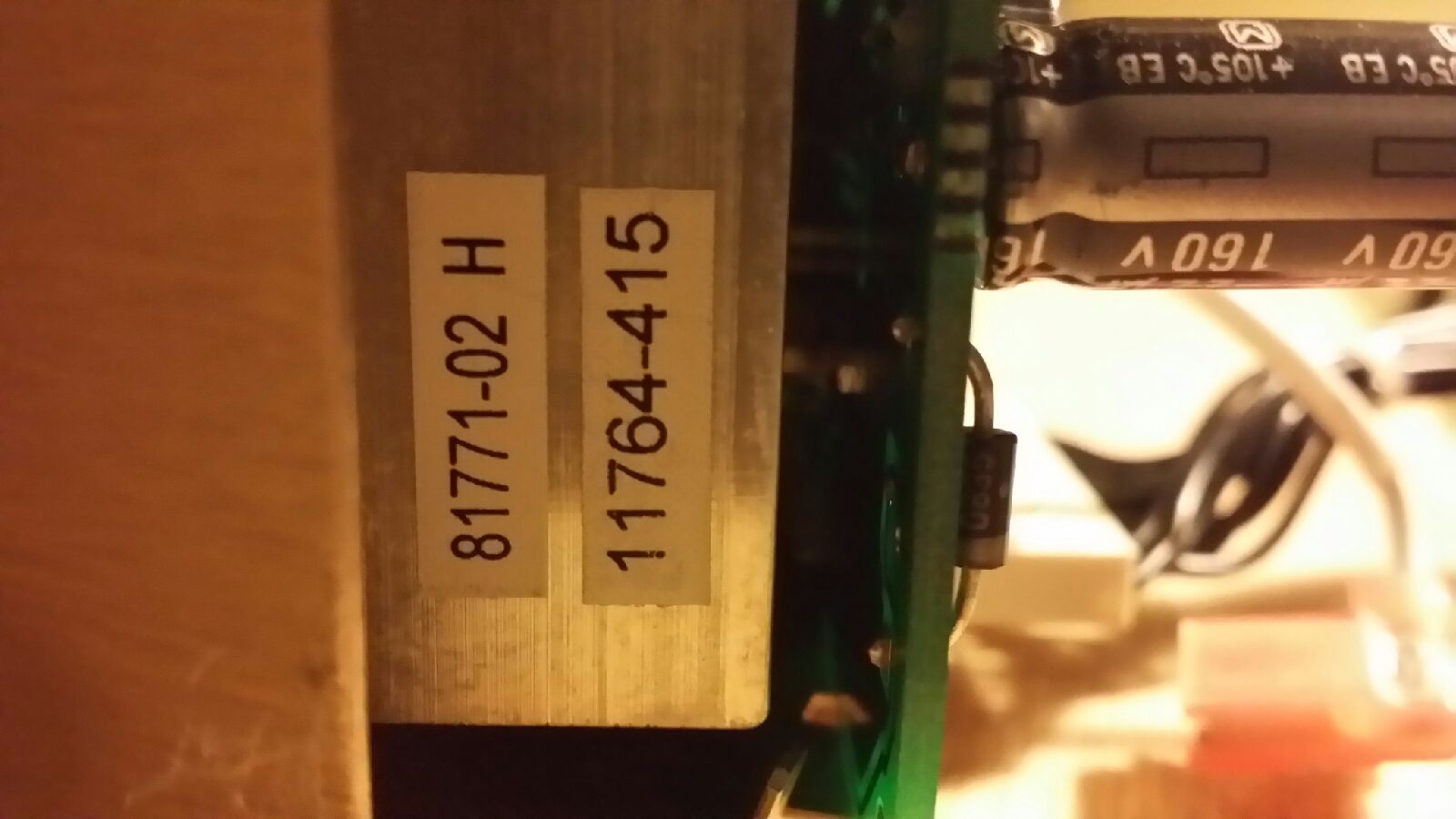

Posted: Tue Nov 04, 2014 5:15 pm    Post subject:
Nash, here's the actual circuit board number and revision...
VNB Number/Rev.

Posted: Tue Nov 04, 2014 6:05 pm    Post subject:
no you need the sticker number, the board numbers are the same. The sticker denotes how it was configured.
Same board number different configuration

Posted: Wed Nov 05, 2014 12:47 am    Post subject:
Odd that the heat sink has configuration... see attached...

Posted: Wed Nov 05, 2014 1:08 am    Post subject:
Those look like they are LUG's and/or P16's if from 8 inch machine. I think P16's have same pin outs as LUG's
