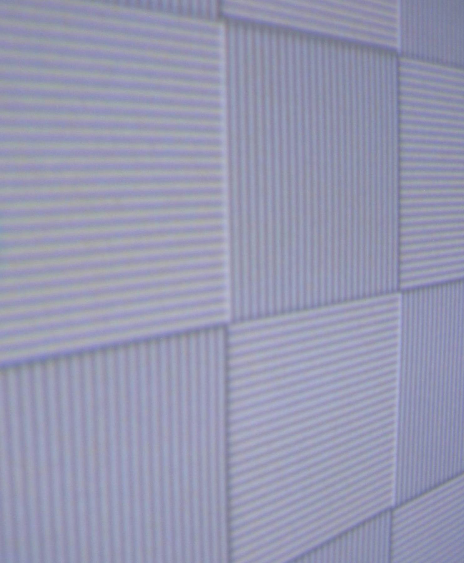

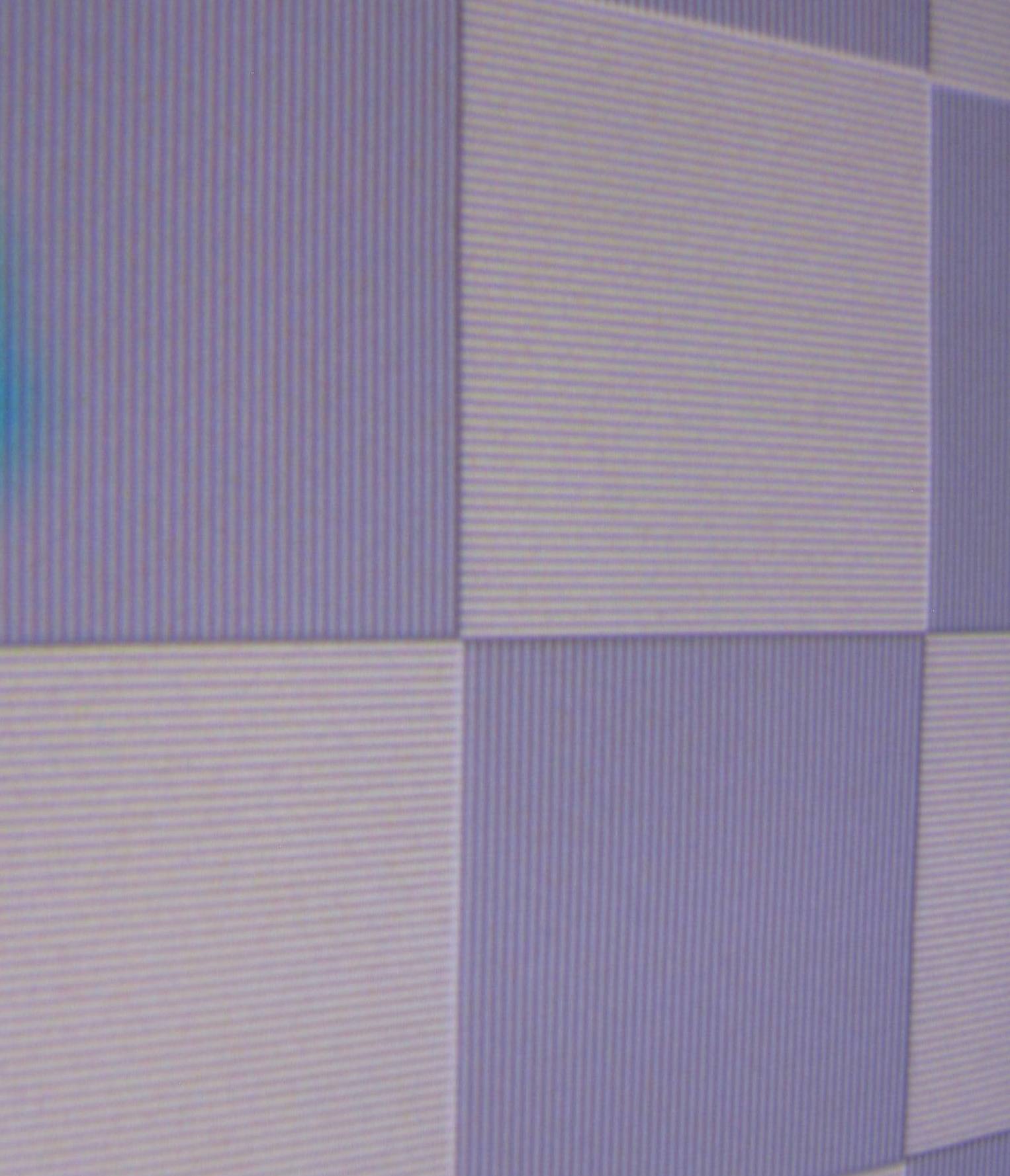

so this is without changing anything except convergence, red which moved quite a bit and blue which moved a little. First the new VDC design then the old factory boards. Color balance did not appear ot be change when looking at the gray scale but ?
Since these are just 8 inch tubes I went with Resolution of 1440 x 900

Posted: Tue Oct 21, 2014 6:02 am    Post subject:
It looks like the newer VNB resolves higher bandwidth... I'm surprised to see how the older VNB is lacking at 1440x900, what was the refresh?

Please tell me why you think the first picture is showing better resolution? I thought the second pic was sharper?
Posted: Tue Oct 21, 2014 6:31 pm    Post subject:
draganm wrote:
60hz, I don't have a choice on my old HTPC graphics card which is on an AGP slot.
Evaluating bandwidth isn't about "sharpness" as you first think. The key is to compare the horizontal and vertical line sets in brightness. The horizontal lines are only limited by the focus and astig, while the vertical lines are limited by these plus the bandwidth limitation. Poor bandwidth will result in lower light output at 1:1 pixels, because the signal transition lags. In real life this really looks like a blurring effect that only washes the image in the horizontal plane. With unlimited (and flat) bandwidth the horizontal and vertical 1:1 lines would be exactly the same. This never happening but if the bandwidth is high enough we are unable to sense the difference between the vertical and horizontal line sets.
When we see color shifting or brightness difference between the two line sets that meaning bandwidth problems (because that's the only difference between them in the "display chain", assuming the astigmatism and focus are set evenly and are correct of course). And it should be noted here that the resolution of the optical system or the beam size have no importance here. With overlapped scanlines the difference is easier to see actually.
I myself like the single color (eg. green) evaluation more as it isn't depending on actual convergence yet easy to see.
I see on the pictures that with the new board there was no color shifting, but with the older yes.
