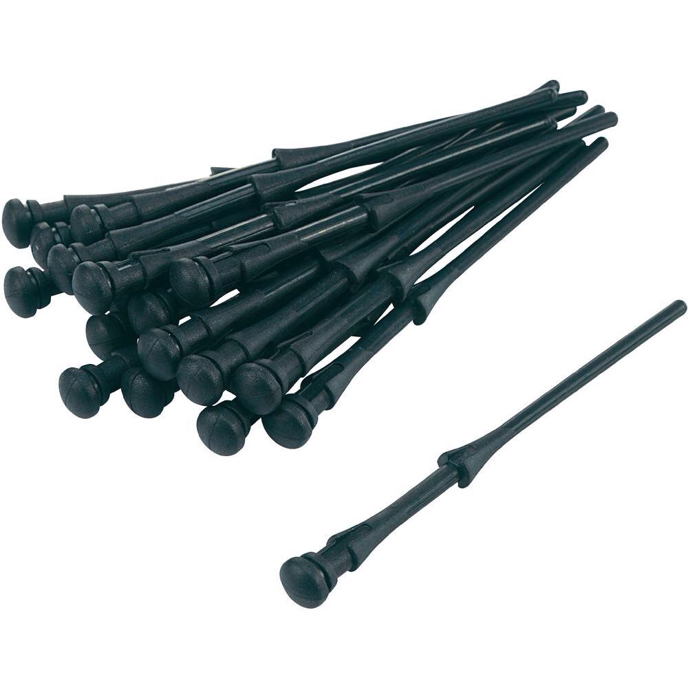

Guys, about mountig the fans: there are special designed silicone plugs to do the job. No screws and no chassis contact. For 5 euro you get 20 pieces.

Posted: Sun Nov 30, 2014 7:02 pm    Post subject:
On the Barco I tried Fans from a different chassis with those mounting plugs. That was a lot of work to get these fans on but the result was not better than the original rubber coupled screws.
I really think that having a contact over the whole edge damps the vibrations better. But that can be combined with these plugs.
