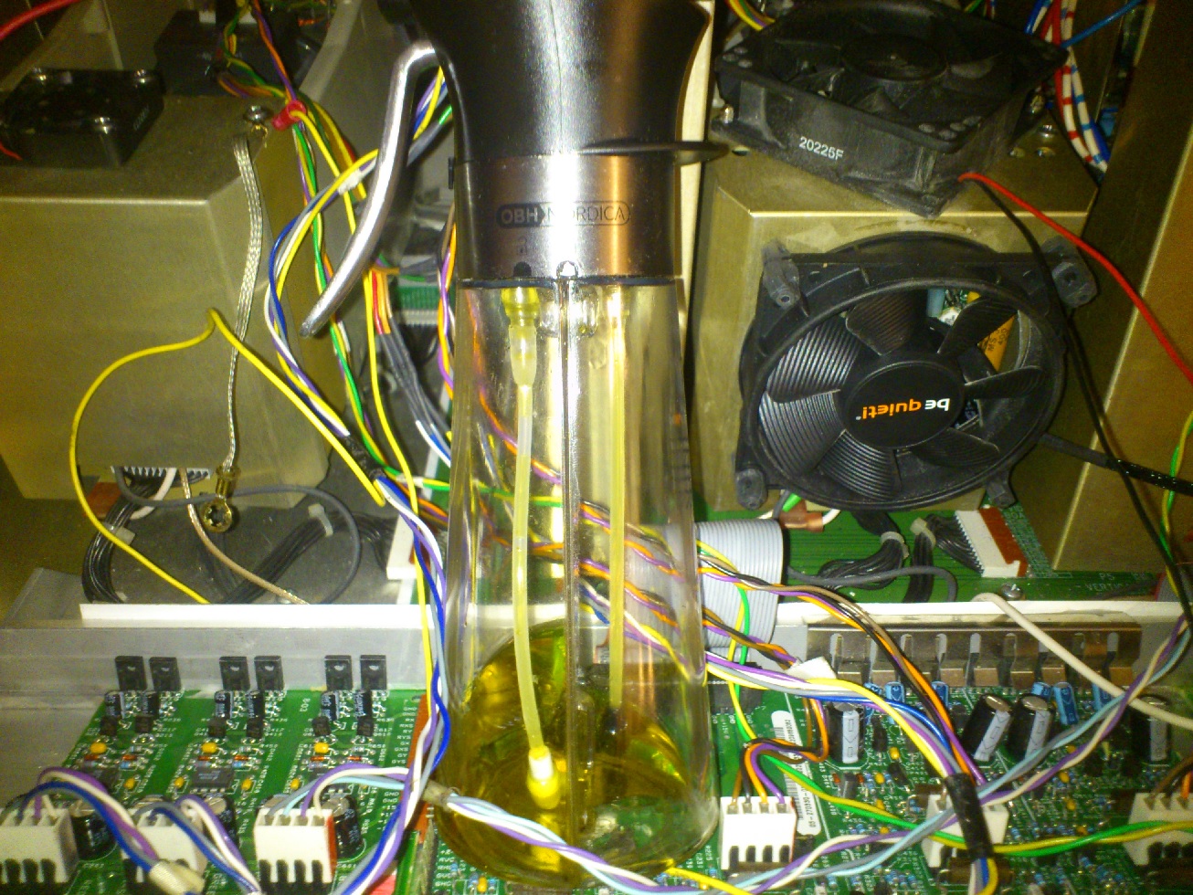

Holy sh*t.. I almost had the answer for you with a tool at home. It's a vinegar/olive oil combiner from OBH NORDICA measuring in at 3.00 mm.. Mad
