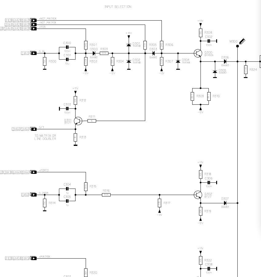

Posted: Wed Feb 11, 2015 5:57 pm    Post subject: Input problems on port 3 by using a non modified switcher
The main problem with upgrading just the HDMI is the switcher card. You are better off using just the 5 BNC because the input transistors on the BNC are 5 GHZ where the ones on the port 3 card are only 1 GHZ.
Port 3 BFS17.
The did this to reduce harmonics and noise and why pay for a high end expensive transistor to support low rez port 3 card.
Port 5 BFR92A 5GHZ
So you can see port 5 has 5 Times the BW of port 3 on the input to the switcher card. So but upgrading the switcher card transistors and biasing you actually be lowering your sharpness and color by using a internal port 3 card without mods to the switcher card.

In our mod set we require at MIN the port 3 HDMI upgrade along with the switcher card or you will have a very soft image.
See posted schematic
Port 3 BFS17.
They did this to reduce harmonics and noise and why pay for a high end expensive transistor to support low rez port 3 card.
Port 5 BFR92A 5GHZ
So you can see port 5 has 5 Times the BW of port 3 on the input to the switcher card. Its important to upgrade the switcher card transistors, you will be actually lowering your sharpness and color by using a internal port 3 card without the critical mods need to the switcher card. ( the card the port 3 connects to)

In our mod set we require at MIN the port 3 HDMI upgrade along with the switcher card or you will have a very soft image. We remove the old port 3 input and replace with a new circuit to support high rez in this area.

Yes we have sold our new card to many customers who didn't like the sharpness of this card as you are getting 1/4 the bandwidth from port 3 vs port 5 BNC.
We have also modified this card and many customers have sent us this card for mods and balanced it with the switcher to equalize the full bandwidth it can provide people who didn't want to pay extra for a full 5 board set. So we can do both keep this card with a 1/2 mod or we can do the full mod with our 1.4 card.
