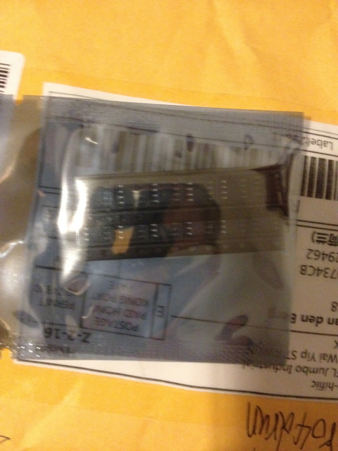

Yes true and guess what arrived from Hong Kong today? Very Happy 5166 drop in chips for all the 1100 that I will find left on the Barco Wink

Posted: Fri Sep 26, 2014 7:16 am    Post subject:
I will be interested to see the outcome of that Tjeerd Wink

Posted: Fri Sep 26, 2014 10:38 am    Post subject:
We have to remember that just replacing the 1100 by these 5166 might also raise the noise level. It takes much more to get it right but I will try what these will do on the neckboards. With the MP mods on the other boards there is not much noise. I found that especially using an internal hdmi lowered noise very much. I hope this Moome will do the same with the noise. I think it does because of the special caps.
Still i am much shaky to do Barco mods. Spare parts are very expensive. That is why the Marquee might be a better project for me. The Barco is more for people that just want to watch movies without all the modding Very Happy
Posted: Fri Sep 26, 2014 11:02 am    Post subject:
Wouldnt you be able to reduce the noise by putting a 1pF cap between output and ground?
redfox001
Joined: 16 Mar 2009
Posts: 2257
Posted: Fri Sep 26, 2014 11:07 am    Post subject:
Yes those kind of things and perhaps some coils in the dc supplies. Or low esr caps on some places.
The hardest thing that I am struggling for weeks now is why I could not simple replace the OPA688 limiter with a el5166. It should have worked but somehow the blanking signal did not get through and than the G2 ABL went wrong.
Perhaps I should post the schedules once here and perhaps a real electronics specialist knows why this different opamp rects different. I have been thinking on just making the schematic of a non inverted opamp on a mini board or so. But I don't understand it and that is not a good thing.
