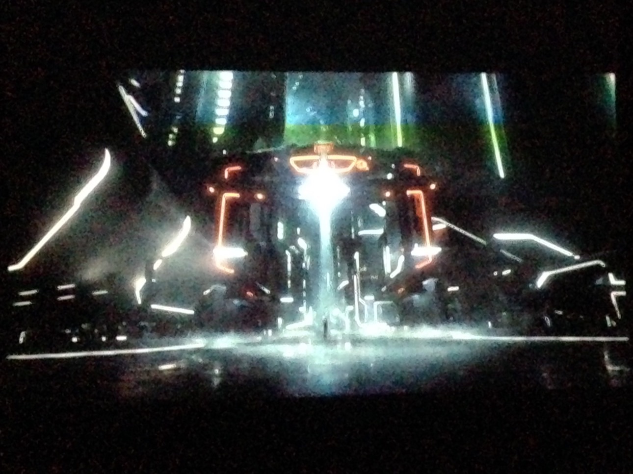

I'll also try and post a pic or two showing the issue. Pictures will be through the glasses as it's not visable without them. Probably due to not having the fast philosopher tubes, and the decay rate being to slow so the first image is still viable when the second is displayed.
Thanks for your help.
Peter
Light part of the picture shows the issue.
 Filename:  image.jpg
 Filesize:  461.21 KB
 Downloaded:  1147 Time(s)
The yellow and blue band is viable on light seens.
 Filename:  image.jpg
 Filesize:  401.02 KB
 Downloaded:  1169 Time(s)

Please see the pictures below. You'll notice that above the yellow area the picture is not 3D.
Both left
 Filesize:  229.91 KB
 Viewed:  28696 Time(s)
And right
 Filename:  image.jpg
 Filesize:  420.39 KB
 Downloaded:  1079 Time(s)
