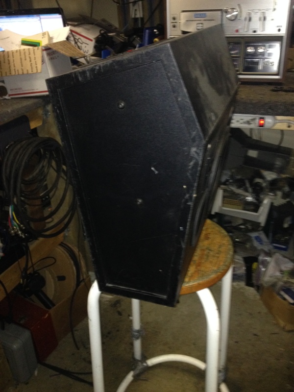

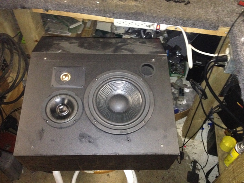

Back to MY thread and MY topic. Smile
I bought 8 of these puppies... genuine JBL surrounds from a commercial theater that got upgraded. I bought 8 of these. 2 are damaged, the rest are fine. I'm actually amazed how CHEAP the speakers are in these. 8" woofer, stamped frame, although it says 'MADE IN USA' on the back, they look like $10 Parts Express cheapies. Still, there's a separate enclosure for the mids, and the dome tweets make me guess that these were made in the 90s. genuine JBl everything. Nice downwards slope to the cabinet, I'll mount them right up at the 8' mark.
Also, the dust cap popped right out with some duct tape!
$250 CDN for all 8. Now all my surrounds are matched! Whatcha think?

Sweeeeeetttt!!!!!!! Amazing score Curt! Your HT is going to be amazing. I'm looking forward to seeing it progress.

OK guys, question about surround speakers. I more or less always read that rear surrounds only process echo type sound, so you can pretty much use whatever speaker you want, nothing beefy. I assume that these JBLs realistically go down to 80Hz, maybe a bit less. On another forum, a member posted this:
It does matter, In True 5.1 all speakers should be full range and at least go down to 20hz as some sound tracks do go down that low even in the rear channels. Some receivers you can the speakers to Large + sub. this will send all low frequencies to all speakers plus to the sub. So the sub will get LFE and the other frequencies. then you set the cross over to what you want, so you can have the speakers crossed at say 40hz and the subs will get the LFE plus any thing up to 40hz that was also being sent to the other speakers. Some like this if they have capable speakers all around.
I'll be the first to admit that I don't keep up with the latest technology, which is why I sometimes post stupid questions here. So now I'm probably asking another stupid question: Have things changed since the early days of 5.1 surround, and is the above paragraph totally accurate, or can (as in literally every HT system I've seen) the surround speakers be smaller and not as critical as LCR?

Youd be wanting to go at least 7.1 Curt, you've got enough speakers for it.
You want them all the same in terms of tweeter at the very least, if it was ProLogic it wouldn't matter.

It is not size that matters, but SPL at the listening position should match the front and directivity of the speaker is more critical due to the shorte distance and bigger litening angle.
Your new surrounds are not designed to be listened to from near field and optimal positioning is hindered by the too big cabinet. I do agree they look sexy, a two way system with 6 inch woofer will probably sound better though.

Gotcha. The sides are about 2.5 m away from the main seating position, the rears about 3.5m or so.
I am going to try 7.1, those get mounted today...if I don't like them, I'll pull them down and will sell them.
