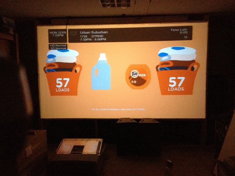

So I spent about 45 minutes aligning the projector to a) make sure it worked, and b) to see what potential I have here.
I`ve got some focus issues, seems the right side isn`t as good as anywhere else. I know the 909 can do better, but after 8 hours of software programming training, I wasn`t up to snuff. Still, I see lots of potential here. May need to rotate the projector very slightly to the left, as I see the slight wear pattern of the green tube on the far left of the image, but only if I`m looking for it.
Overall I`m happy, but I`ll still do some playing, and I need to change out the Denon in the rack and put in an HDMI switching Onkyo.
gotta find another decent green tube for the second 909, it should go up this weekend.

Very nice curt. I'm sure the picture doesn't do it justice, it looks good from what I'm seeing though Thumbs Up
And yeah, was going to say, that Denon looks a bit old there Razz
