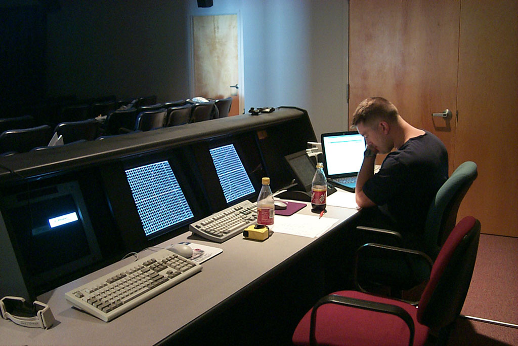

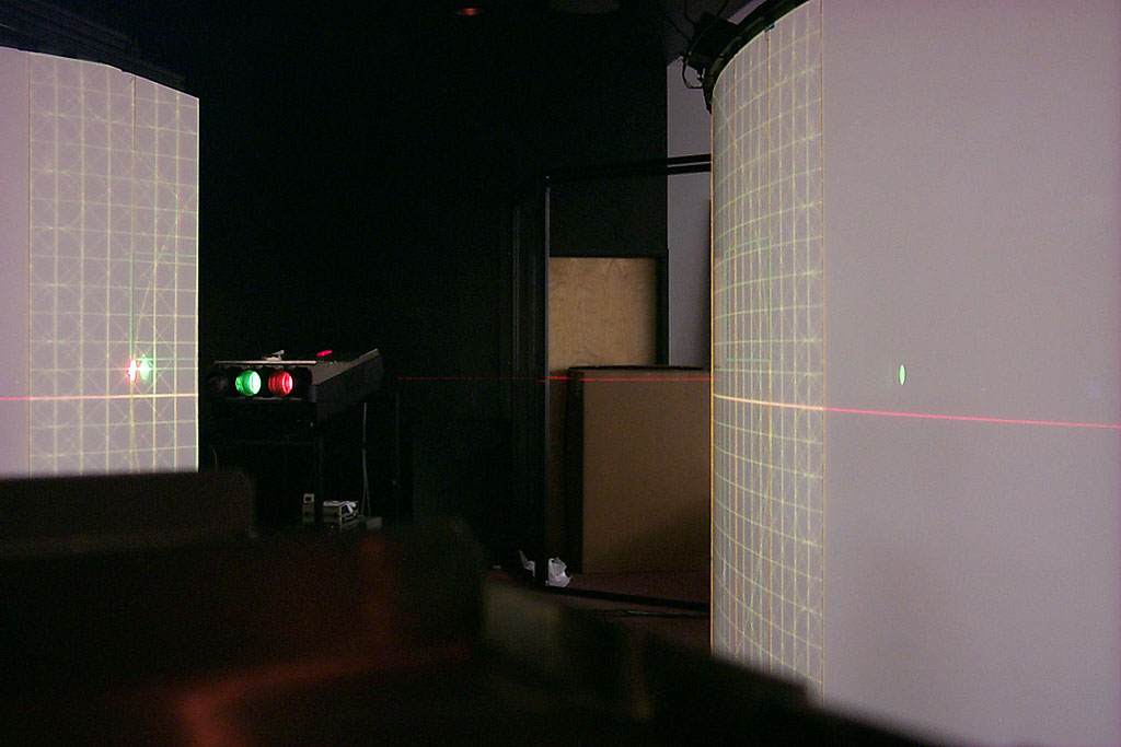

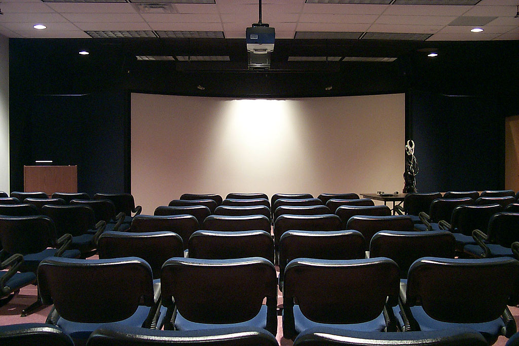

Took a little digging, but I found a couple! Somewhere, I have 20 or 30 shots of the project, but these three I scrounged from an email from 2009 where my buddy and I were talking about the project, and I'd found the photos on a CD-ROM and emailed them to him.
So, in that old email I also saw that we were talking about the blend zone - 320 pixels. That would be about right - 10% - for two 1600-px wide signals. So, the final blended resolution must have been 2880x1200. You can see in the first and second images how the resolution is. So, total The monitors in the console are SGI Sony 21-inch Trinitrons displaying the same signal as the 909's. I believe everything was routed through an Extron Crosspoint 8x8.
Judging by the ceiling tiles, the screen was just under 20 feet wide. 10-foot ceiling, 8 foot tall screen. Using that 2880x1200 resolution (which is 2.40:1, BTW Wink ), that would make the screen 19.2 feet x 8 feet. So, each projector was making roughly a 10'-9"x8' image. This display was for visualization (virtual reality), so viewers stood maybe 10-15 feet away with shutter glasses and head-tracking for full immersion. That's why they needed the really high resolution.
The projectors bounced off large mylar first-surface mirrors. The were absolutely amazing optically. You could literally not tell if you were looking at the mirror, or not.

Posted: Fri Oct 03, 2014 1:01 am    Post subject:
BTW, this is where I first learned how to do a wicked-accurate, down-to-the-mm, gnat's ass CRT setup. You can see the laser level striking a line across the screen and projector case. Everything was laid out in CAD to high accuracy, then installed on-site with as much precision as humanly possible. I remember going back and forth with string and tape measures, putting arcs on tape on the floor to find distances to nail angles down, and pinning everything down to the 1/32 of an inch. I'd say that setup was about as perfect as you could ever get one without robot-manufactured jigs or something.
This was also the project that made me lust after 909's. I wanted one so badly for so many years, but alas, it was never to be. Crying or Very sad
