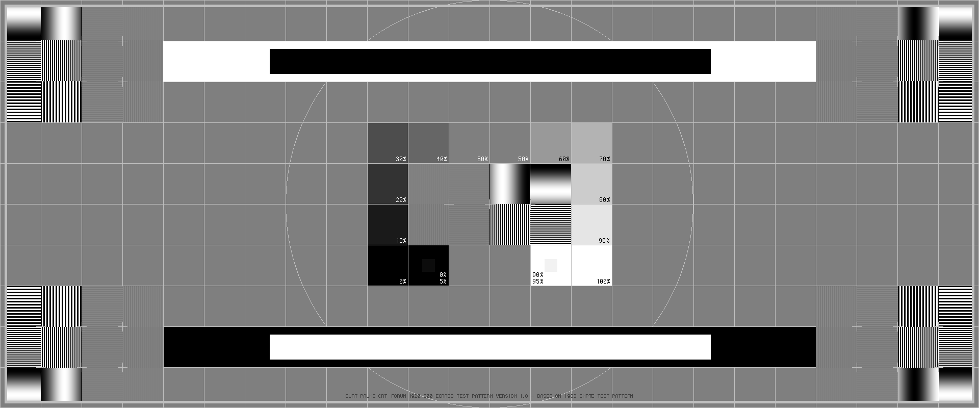

Ah found it, Casey used 1920x800 ...... look at this pattern and where 50% is written. So....this clarify's it I think

In fact they look like the 1920x800 testpatterns here:
LOL we found the same image! Very Happy And probable at 48 Hz Wink

But at 1920x800 the scanlines are at the same distance as with 1080p, lines are just cropped from the top and bottom, and the vertical resolution has nothing to do with bandwidth.

You are right it doesn't change scan lines distance and it's not a complaint, it's just an observation. As well as my observation is that Casey used a different SMPTE pattern made for a different resolution. Now we have that clear I'm still wondering which resolution he used in this shot? 1080p60hz? 800p60hz? or something else (720p60hz) by mistake.... From my own experience I never have seen a 909 Cine9 Sony g90 etc. do 1080p@60hz running analog cables giving that amount of sharpness. So I'm very curious what I am looking at.
Strids is very right about lower pixel clock will give the projector more headroom resulting in better resolving 1:1
Therefore judged on: 1) 1:1 resolvability 2) sharpness 3) using a 1920x800 SMPTE pattern I would say this isn't 1080p@60hz
That is the pattern i used yes, the ones Crabb posted some time ago.
You cant see the scanlines in that image, or i certainly cant, you can see lines on the one on one off, but that is a given. On 1080p i have to put my face about 1-2 feet from the screen to see scanlines, even then its only on the middle area and only on green.
That image is about as focussed and well astiged ( electronically and mechanically ) as i can get it.

Its quite important information, as you run a hole different pixel clock.
It do explain a lot why your shot looks a lot like the one Redfox posted running 720P 60hz regarding bandwidth performance. And no one else has been able to get the same result running 1080P 60hz, as its a much higher pixel clock.
Why dont you guys use the same pattern, prefered the one from HD Basic, it better to look at when detecting peaking.
And then always tell what pixel clock you run.
