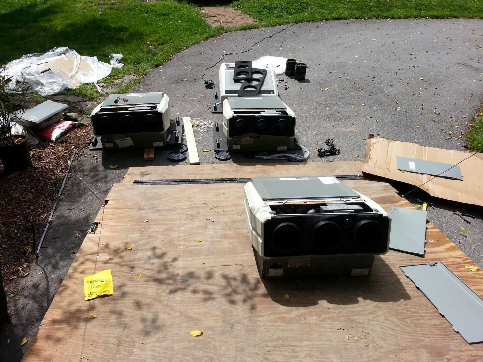

I need to lookat tthese as well and get them out of my driveway...

That one facing the other way is a 2007 8500, with only green tubes... The center one is ravaged with a CAD image... The other two tubes look untouched!
Is that weird or what... This projector is... SUPER GREEN! Wink

I have some green C elements, and a red too... I want to try blending, but I can't find enough info yet.
Posted: Sat Aug 23, 2014 6:12 pm    Post subject:
What a nice driveway.
Ill have to admit im a bit jealous.
It takes some time to get around these Marquee machines, but if your willing to spend some money on them they will kill all other CRT machines out there.
Blending.. Ohh my thats a lot of work and money, how big a screen are you planing to run ?

Lens caps were all broken by UPS or the packer, including about half the lenses. I've rescued the couple that are not broken.
120" AT screen. I've already got VV1 Ultra (from Curt) on my ceiling... I am trying to get the latest, and I think I did. I've been running Marquees since 2000, starting with an 8500LC.
These, even though the cases are crushed, are so new!!! Going to upgrade my others with the parts.
One question now is, are these neck boards good for the older tubes (non LUG)? I have new ones I picked up from Curt and Tim. Suppose I will have to keep the VIM and neck boards together from one of these machines...
